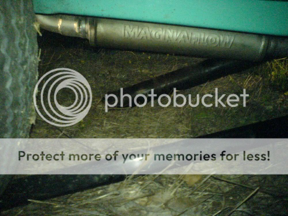

    so i was drivin down the road 30 min ago and all of a sudden, BANG!BANG!BANG! BANG!BANG!BANG!!! i stop to see my driveshaft and both wishbones dragging on the ground, i think the bones snapped and caused the rear end to shift and snap the driveshaft, the fenderwells were really tweaked(rear end slamming it) were the wishbones broke on both sides there is rust on the fractured line(might of been ready to break for a while sorta thing) but damnit now i gotta fix everything, figured id show ya'll................twisted some stuff too...
    Look how it twisted the front mounts:eek: :eek: :eek:

    Wow flex fatigue.....you are very lucky.....that is a great example of those old rear bones were not made to flex.....I am glad you are OK and you are a good man for showing that for others.

    I guess that's why people say you shouldn't run split '36 bones?

    Another good reason why split wishbones on the rear are a no no. Glad you and the coupe is okay, This could have been bad. Now get to work fixing that baby

    Those aren't '35-36's.
    Again, those bones were never meant to be radius rods, only support the torque tube, and this is what happens.

  13. Split 'bones on back are basically Ladder bars.
    Sooner or later,something has to give.

    Your not the first one that has had that happen.
    I know several cars that guys have used stock Ford wishbones on the rear that this has happened to.
    They arent made to work as a locating bar... Be sure this time to Re~Do them with a Ladder bar set up with locating points at the top & bottom of the housing.
    I know alotta guys will contest what i said, But this the EXACT reason i switched & went closed drive in the "T" Roadster.
    And the reason the "A" Sports Coupe has early style Ladder bars from an old Drag car.
    I may not be Famous or H.A.M.B Approved.... But if ya have questions Jordan, I'll try and answer any questions you may have.
    ADD'd ...... You already have a Small Block & open drive in it, So do an early style Ladder bar triangulated to a cross member
    and you will still be in the realm of TRADITIONAL due to the late engine, trans & rear end

    They aren't the bones you can safely use...they just brace the torque tube/banjo joint from road impacts in the original configuration.
    Were they the only things you had holding the axle or did you also have a torque arm?
    What size bolts hold them to the rearend?
