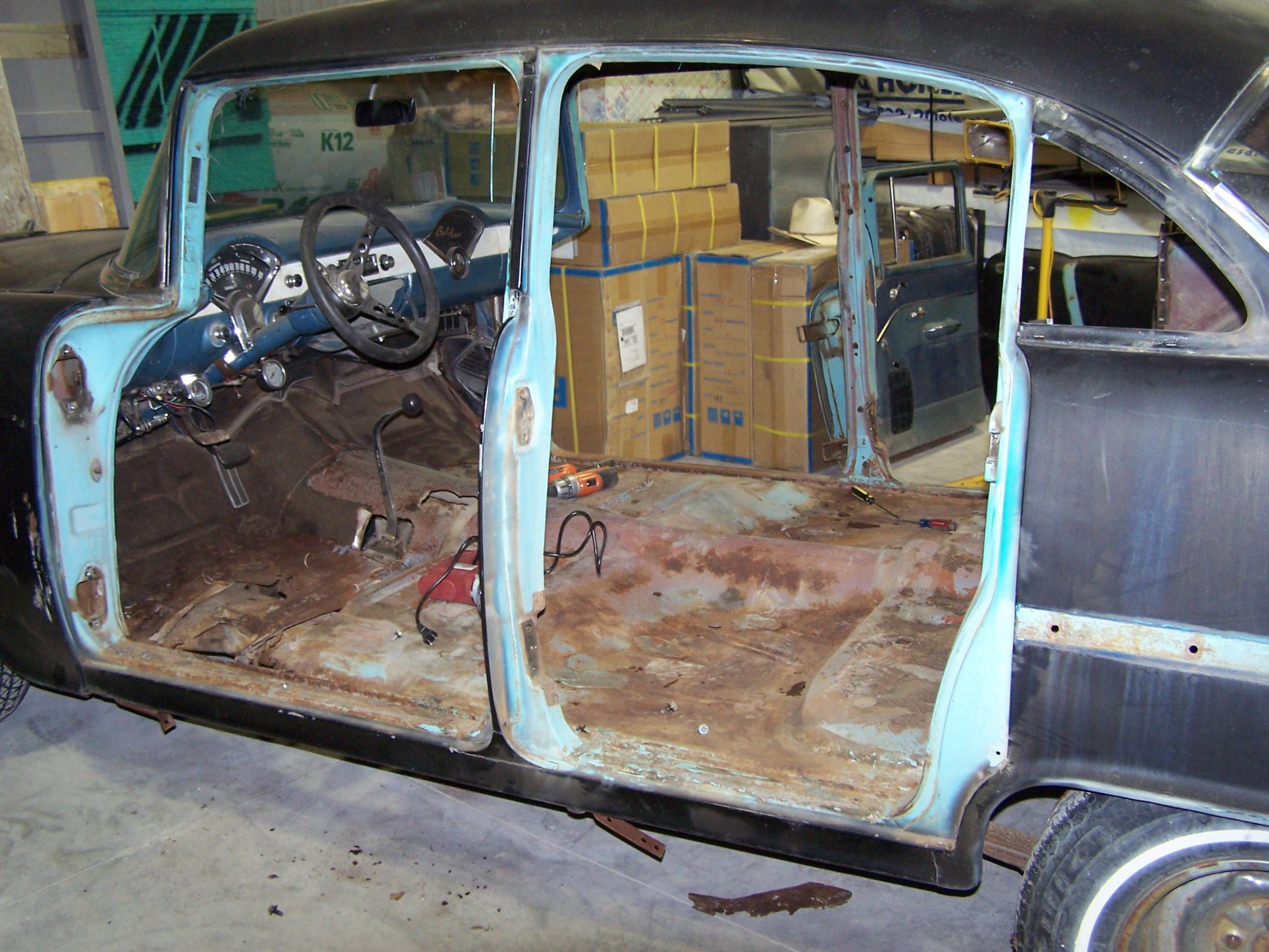

    Remove all 4 doors. This will require the use of a ratchet and 9/16&#8221; socket. Do not remove the front door hinges from the car. Rather, simply remove the front door from the hinge. However, the rear hinges and rear door need to be removed.
    Step 2:

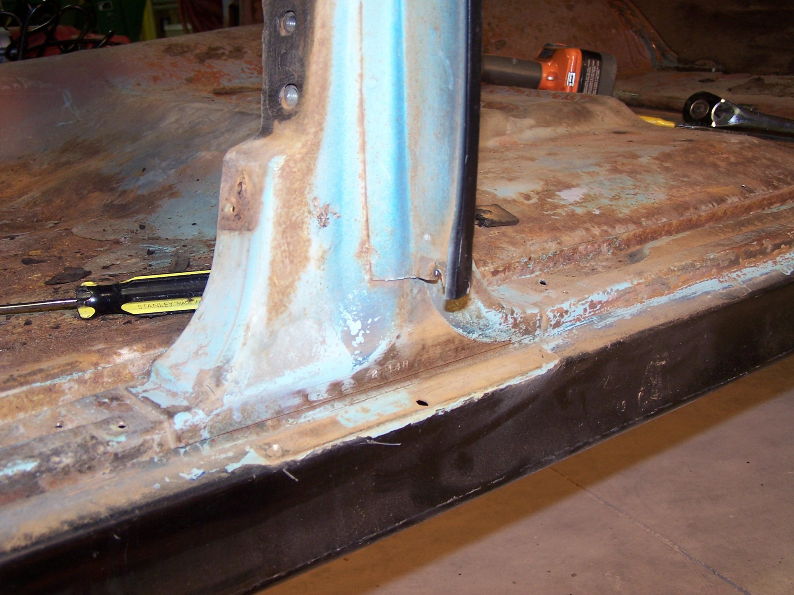

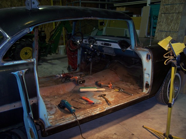

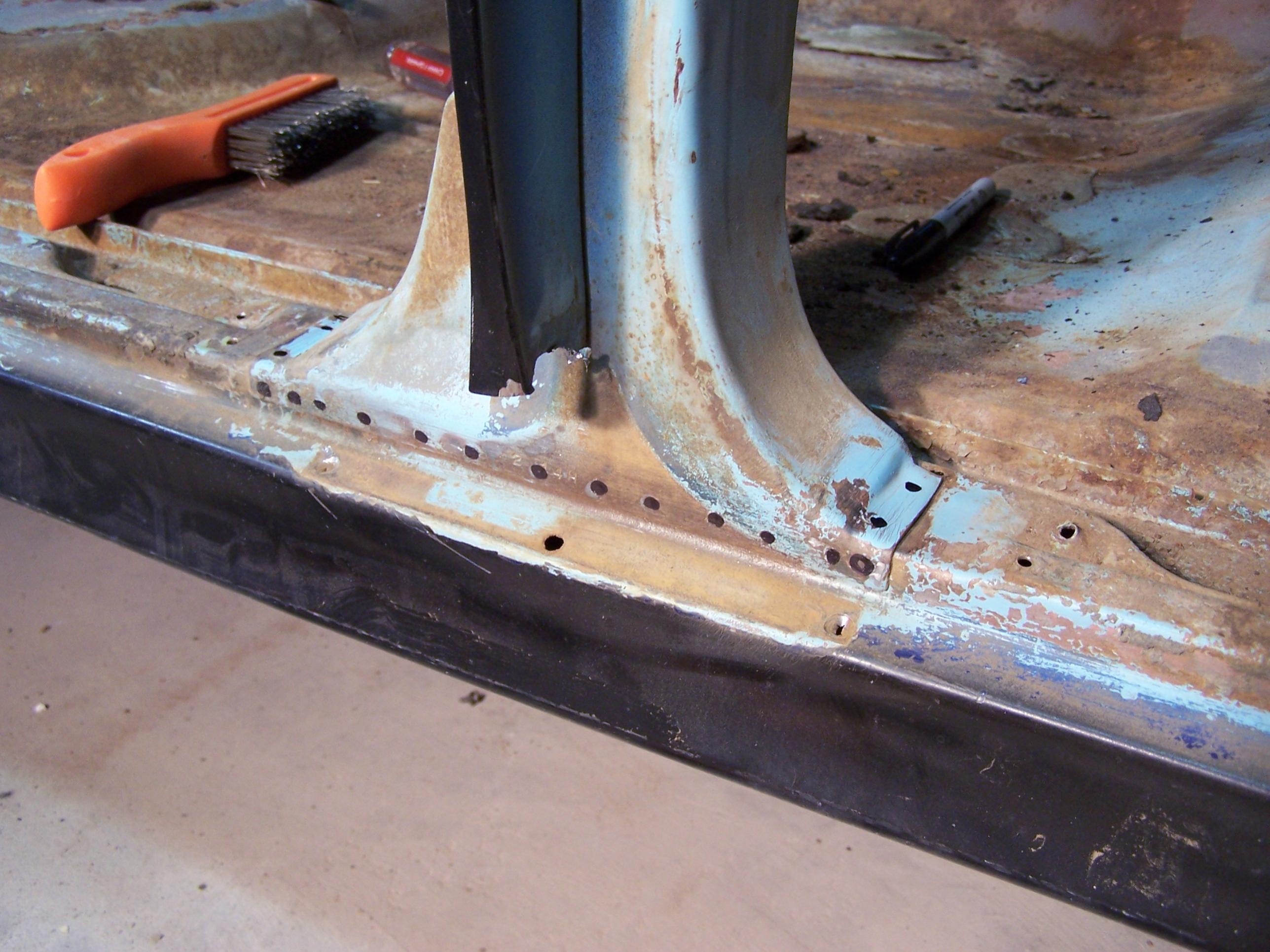

    Cut out B-pillar. Using the angle grinder fitted with a cut-off wheel, cut along the lines highlighted in figure 2. This is accomplished by locating the spot-welds that attach the B-pillar to the rocker panel at the bottom, and roof at the top, then cutting just above them. Spot welds can be located by finding a small ¼ inch sized round depression in the metal. Also, these spot welds can be drilled out in order to separate the B-pillar, but I have found that cutting just above them is faster.
    Step 3:

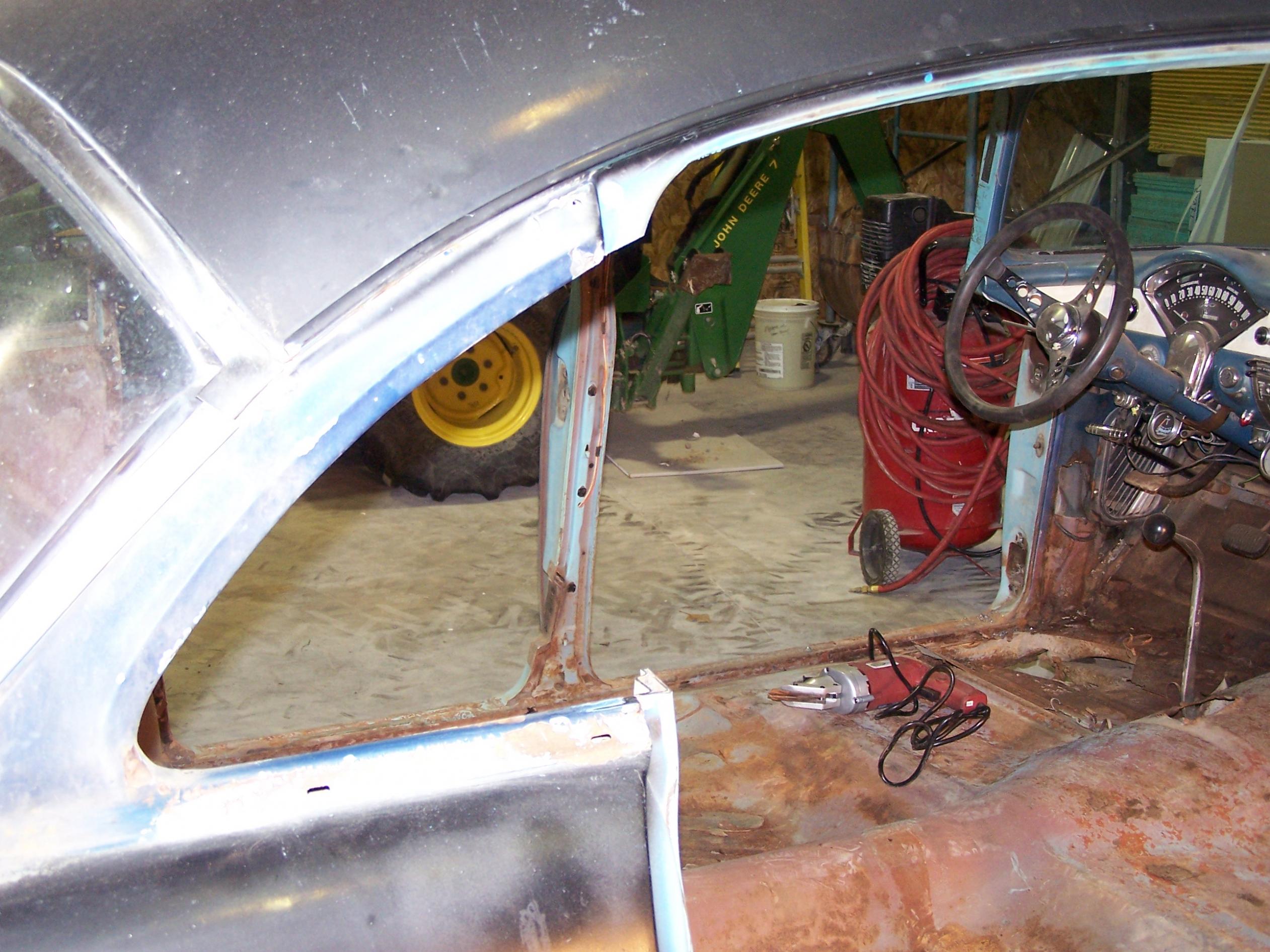

    Cut out C-pillar. Using the portable band saw or hack saw, simple cut the C-pillar out. Follow the body lines of the window frame to guide your cut path. The goal here is to make it look as is the C-pillar was never there. Some additional grinding may be needed to completely remove all remnants of the C-pillar.
    Note, directly underneath the B-pillar, on the rocker panel, you will find a "hump" which must be "laid down" in order to allow proper fitment of sill plates.
