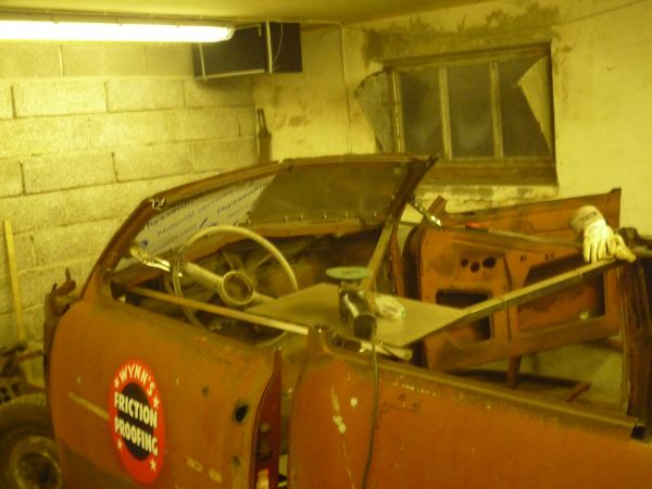

    Her have i cut it of the roof and put in winsheld fixtures
    I have cut the winsheld fram lose from the roof and begin to fit it
    I weld it in after som sand blastring of the fram top part
    Her is a design test of the side window holes

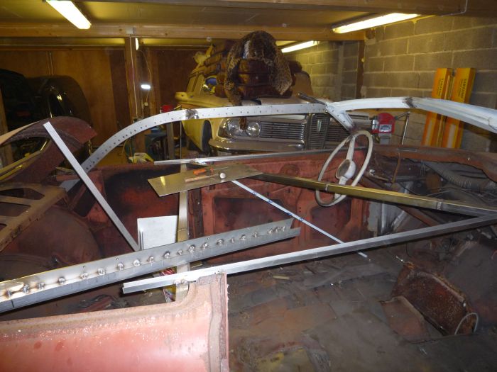

    Her comes more pictures

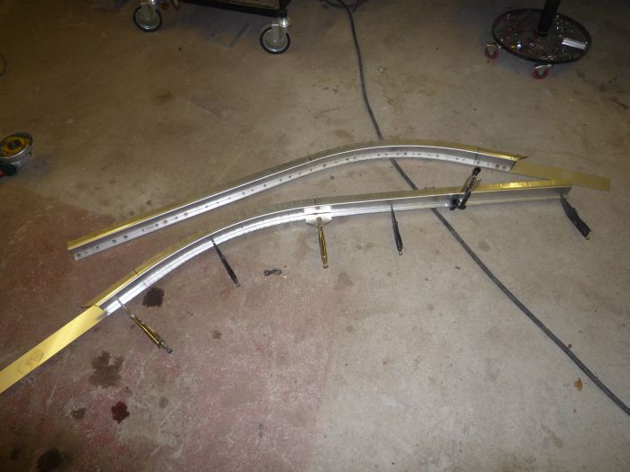

    I will made new roof side beams
    I have made 2 laser cut 2mm sheetmetal parts and 2 profiles
    The profiles have i streched and shrinkt to get the right shape
    next thig is weld them together
    Her's a test of the new beam
    Next thing to is put up the other side

  14. Stefan T
    Joined: Sep 15, 2008
    Posts: 2,165
    Stefan T
    from Sweden

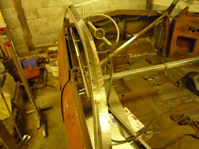

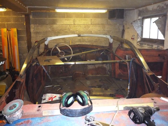

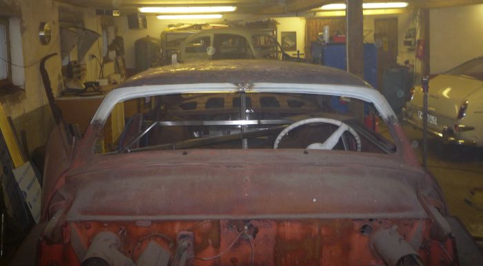

    I work little more on my chopping of my shoebox
    I have put up the new side profiles on both sides
    Her's from rear
    I have welded them and next thing to do is put up a profile in front of the trunk lid profie on the wheelhouses for the hidden hinges to the trunk lid
    It will be a new update next time a work with the chopping of my Ford

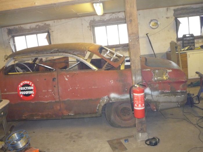

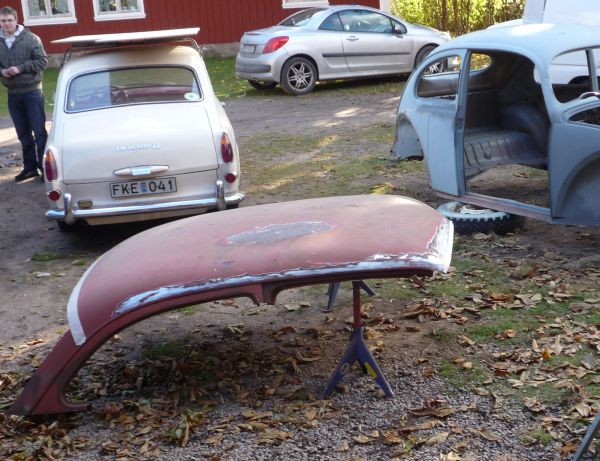

    I cut out the old roof now it's test time
    I have put up the old roof for test and see whats wrong her from the front
    After the door it fitts not verry well

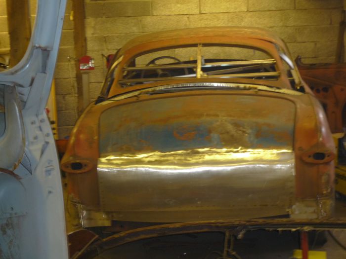

    her's the big hole betvine the trunk and rear window
    and the profile under the window is in place

  24. Swedeshoebox
    Joined: Sep 30, 2007
    Posts: 149
    Swedeshoebox
    from Sweden
    Stefan! good work,hope to see it on the road soon!
    how mutch did you take?
    by the way, haven´t ill seen that decklid before:D
  25. Stefan T
    Posts: 2,165
    Stefan T
    from Sweden
    I have take 89mm [3 1/2"] in the front and i don't know what it will be in the rear yet

    I have build little more on my shoebox.
    Today have i put in profiles for trunk lid hinges and strengen the side profiles
    I will put in gas springs to lift the lid
    I have made the side profiles closed

    Her's the first try of the rear window
    I have to move it down and back in the lower end and maybe make the new profile little lower
  28. Stefan T
    Posts: 2,165
    Stefan T
    from Sweden
    I have moved down and back the rear window
    shall i move it more ?? or leve it there it is?
    Is the look ok?
  29. pimpin paint
    Joined: May 31, 2005
    Posts: 4,937
    pimpin paint
    from so cal
    Hey Stefan,
    I would drop the top of the backlight frame another 4'' +.
    The reason is I see a bit of a "peak 4-5'' above the frame where it intersects the top panel. This will help with the flow of the top at the rear.
    I really like the cant rails you've built, they will make the roof flow well with your chop!
