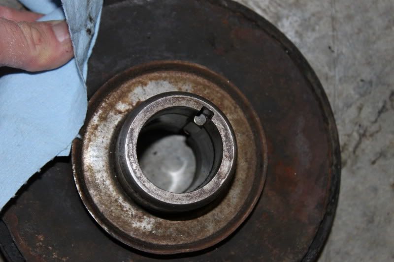

Are there any issues with the crank flange being a problem on the Industrial hemi engines?

I've got an IND56A (motly) in the coupe and the digger. I've not had any trouble with the flange. The JW Super Bell stuff in the digger needed massaging but that's not an uncommon thing with them from what I hear. Ask Hemirambler about his fun with them.

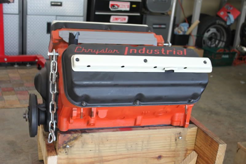

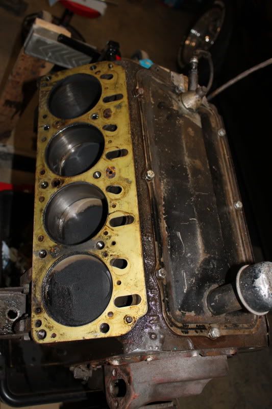

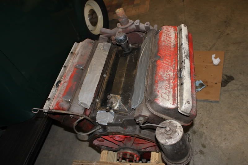

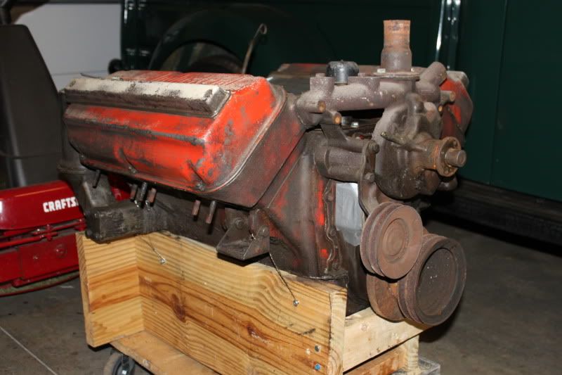

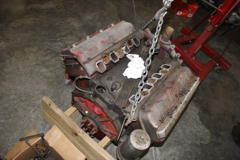

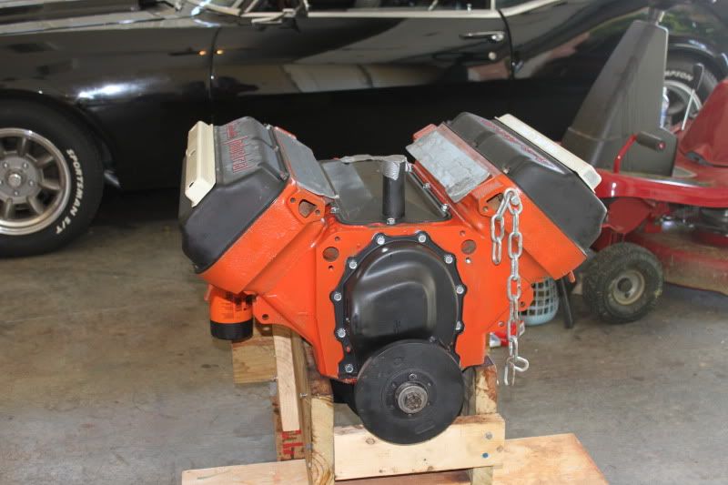

Good question that I didn't think of. Here are pictures of the engine. Can I use this motor without having to replace the crank?

Yeah BTW I run an Iron (pushbutton) torqueflite in my truck. They are admittedly an outdated trans. Rebuild parts are a tad expensive, but as compared to the conversions it can be cheaper. For instance a pushbutton trans can often be had for free. The rebuild kits are around 3 bills. So if you had an inkling to go ultracheapskate - it's an option. Now I'm not sayin' it's a better idea long term - just tossing out an example. Mine in my truck needs rebuilding right now - I contemplated changing over to a 727 - and maybe one day I will, but for now - I'm sticking with the "Iron Monster".
Kerry has a good memory - the JW kit gave me fits. I had to change several things to get it to work properly. I can't speak for any of the other adapters as I have no first hand experience with them. If by chance you go the JW route - let me know - I'll go over my issues - maybe you can avoid them.
The poster mentioning the steering box being tight - is exactly my issue - that NEW Nippondenso starter converted for a 392 is awesome - it is offset and MUCH smaller than a stock unit - so I highly reccomend it. They have lots of cranking uumph as well!!!

Yeah, with the JW Ultra Bell on the digger the Nippondenso starter, small as it was, was in the way of the frame. I cut some of the nose off, welded an additional plate for the mountand reclocked it so the motor is directly below the drive. Fits great and works fine now. I think Bob Walker at Hot Heads has a modified Nippondenso starter that works with stock old hemi transmission and flywheels.

It's usually recommended that the Ind cam be replaced with one that was ground with automotive use in mind. If you were using a QEC adaptor & a 727 the studs in the crankflange would be replaced with bolts & a 426 hemi flexplate.

What's the tubing on the dist area of the block?

Quote:
Oil pressure line for manual guage I think.................

Nope, the oil pressure hole is in top right next to the hole for the distributor. The line in question goes to a non pressure area. Probably a return line for something like a governer.

As far as that line in question, the previous owner said the aircraft tug did have a governor on it...so that could be the ticket.

NO.... there's been a lot of info posted about that but every IND I've seen has the pass. car crank... all three of mine have pass. cranks...some marine engines will have a different crank...

You have the standard under carb crossover, so any 55-58 or afterrmarket intake will work. I see someone plumbed a leak into the rear block off plate on the right of the pic, need a new one.
