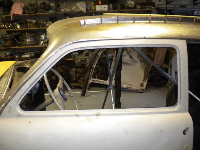

    Here's the 2 door front door on the car with the 4 door b-pillar still in place to show how much longer it is.

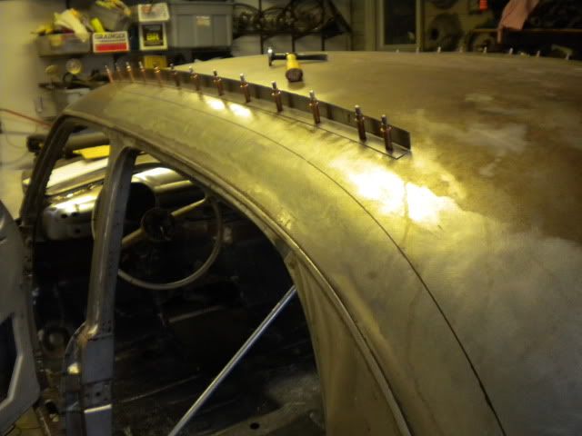

    I left the donor car unbraced when I cut it apart so I could see what moved around. The roof skin was WAY floppier than I had thought it would be so I bent up some 90 degree pieces of 18ga and punched some 1/8 holes for Clecos.
    I used the shrinker/stretcher to get them to match the contour of the roof and cleco'd them on.
    I then braced up the inside, getting the tubing as close to the cut line in the door frame as possible.

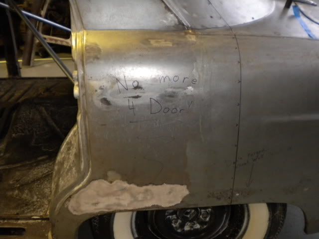

    Since the 2 door quarter is 1/2" larger than the cut in the car I was able to drill through both and cleco them together to keep everything in place.
    Once you're satisfied that everything is lined up like you want it, scribe a line around the panel.
    Then remove the quarter, trim to the scribe line, put the quarter back on and enjoy one helluva good fit....did I mention I want to TIG weld all this back together :eek::confused:

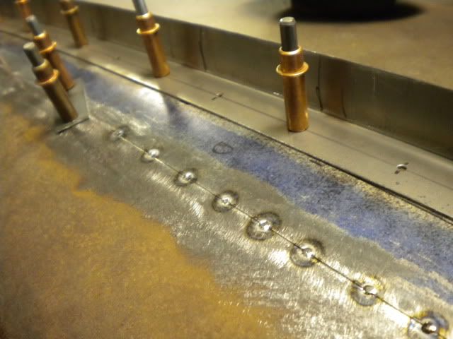

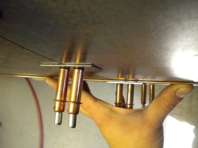

  15. Getting everything fitted up just right before welding is the most crucial part. I made a handful of these tabs to keep everything cleco'd in place like so..
    A piece of TIG wire makes an easy contour gauge to see if anything needs bumped around before tack welding.

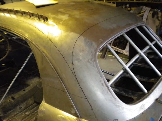

    After getting everything just right I started to tack weld it together.
    Here's the roof after tacking it together and some hammer / dolly work. Should take less than an inch of bondo hopefully :D
    And here's how it currently sits, looking quite a bit more 2 door-ish if I do so say myself :cool:
