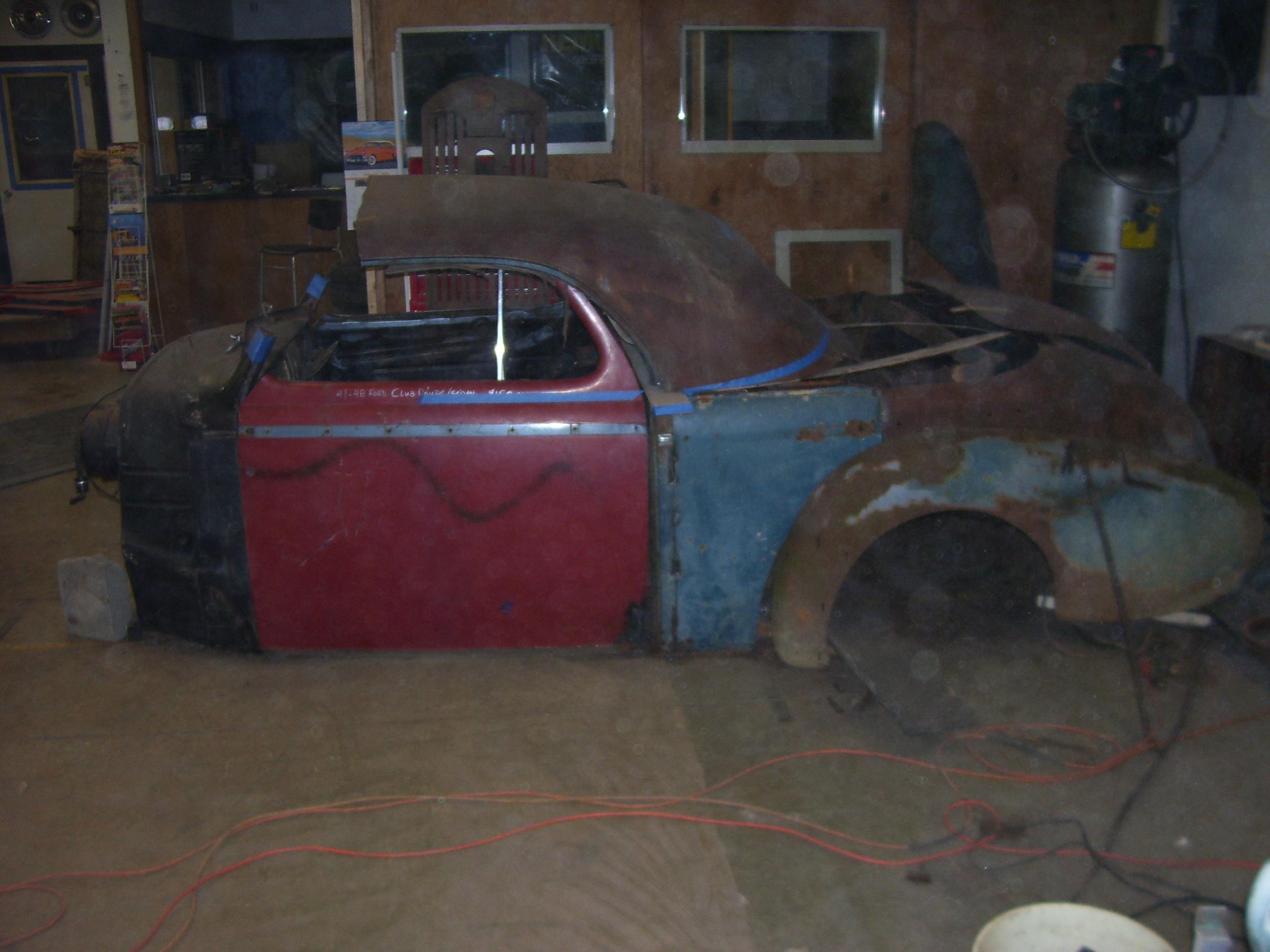

    Got the Buick and Chevy some what connected. Picked up some 1940's Ford doors

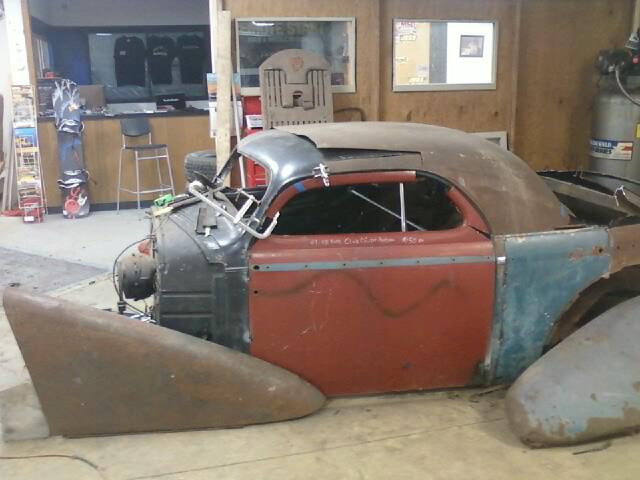

    Got the roof kind of worked together still some fitting issues that need fixing. Took about 3 inches out of the Chevy windshield

    I'll be watching this. Concept using the Buick parts looks good. Wondering why you're using the Ford doors instead of splicing two Chevy or Buick doors together for length? I would think that'd line up better but, I'm sure you have your reasons.

    It's a lot easier to use a Ford door with a very similar shape than to cut and stretch two doors and hope they line up right then try to find or make custom window mechanisms and door lock&latch linkages. I think I'm doing enough custom work as it is plus I really like the larger door window frame the ford has as opposed to the thinner chevy and buick door window frames.

    I agree: One caution is to watch that chop carefully. (front looks to be lower than rear, beware that 'Race-Chop' look.)

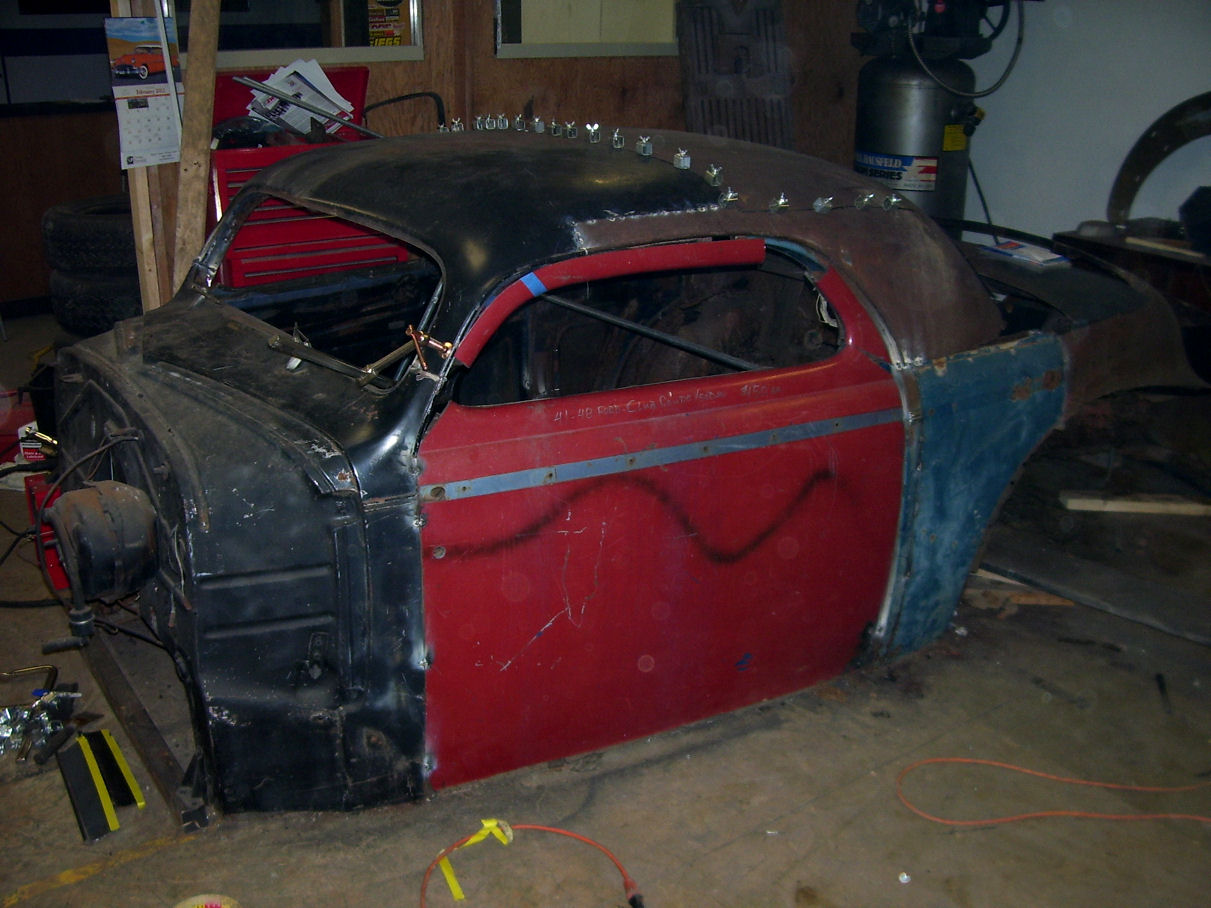

    I'm kind of doing that but with the front fenders. The ford doors are installed backwards so they will open suicide style and I'm thinking of stretching the front fenders and cutting the front of the doors to accomadate the front fenders

    a couple more update photos
