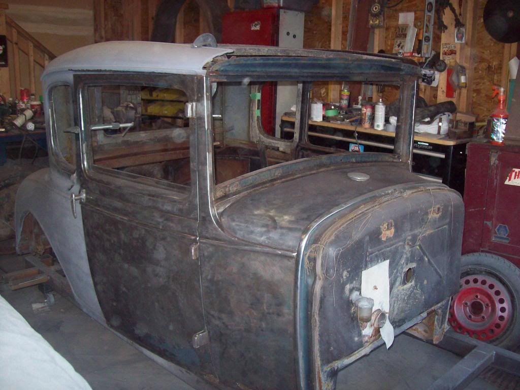

    The coupe the day I picked it up:
    Didn't waste much time taking it to bare metal......the poor man's way with a buffing wheel.....cost nothing but time.
    Was a good time to chop 6" out of it too!!

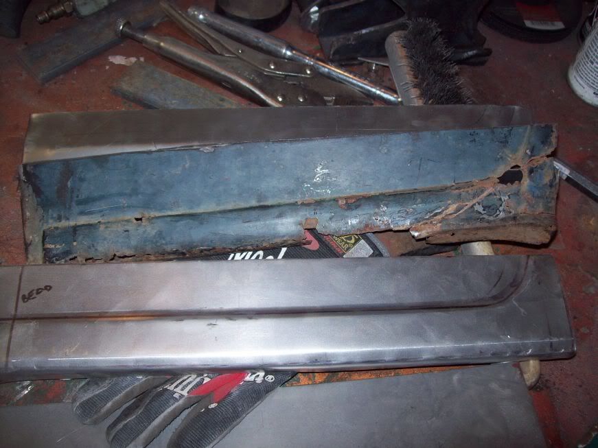

    Did all the rust repair, grafting a new section of quarter panel, and making various lower panels like these ones at the quarters:
    A bead roller sure is handy:

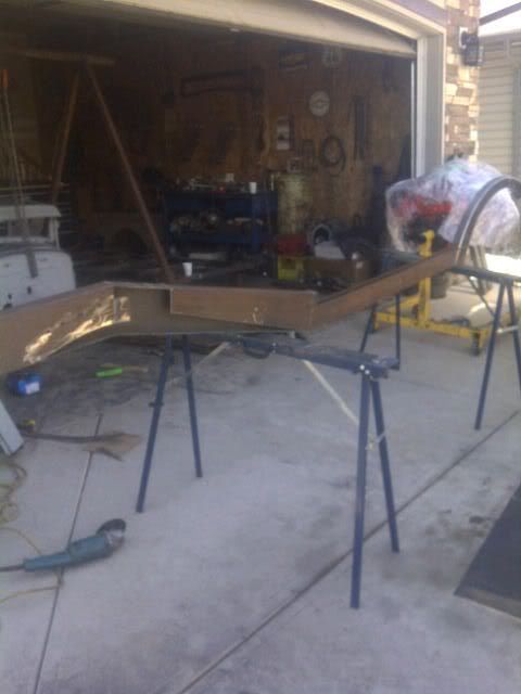

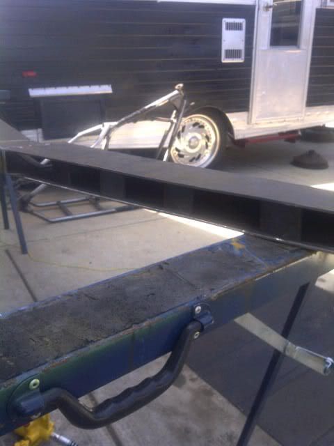

    Built the frame from 6x2 .125 tubing, lots of cutting and shaping, the center section where the body sits is cut down to 4" so I'll have a "little" bit more head room:rolleyes: The front sweeps up about 5", still lots of pieces to fit and welding and grinding.
    Added gussets to the inside of the tube:

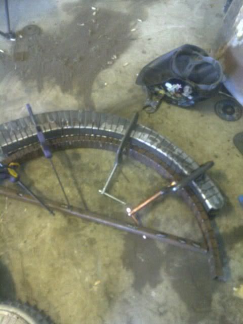

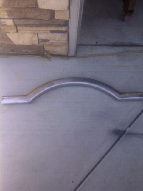

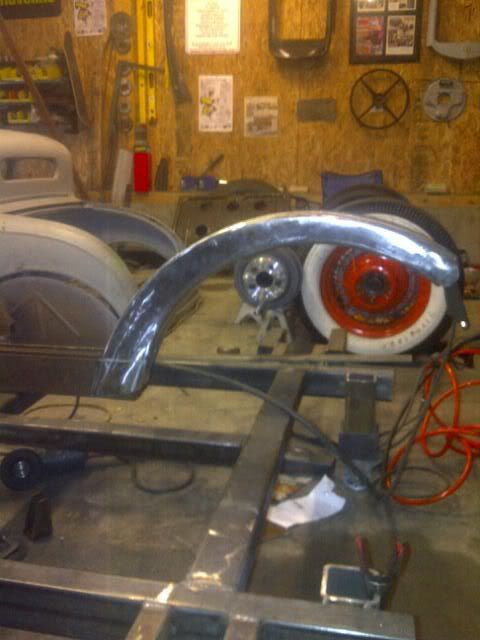

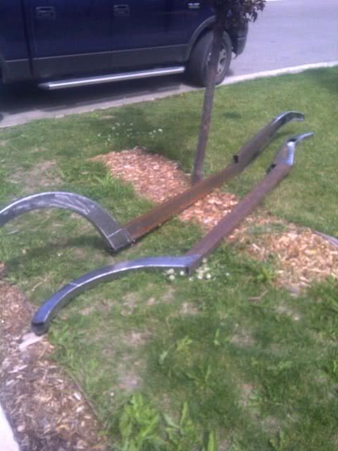

    Wanted something different for the rear kick than the usual Z so I took a front set of rails from another frame project and started pie cutting them and bent them to this shape. LOTS of welding and grinding.
    Needed to make a rear crossmember out of 2x2x1/4 to match: Lots of blood was lost building this but it was worth it

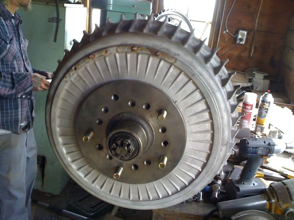

    For the front suspension I used a 4" drop custom axle from lucky7, original Buick 45 fin drums machined down to fit 39 Linkoln style backing plates.
    Had to make new studs to accomodate the 35 Ford wires I'm running

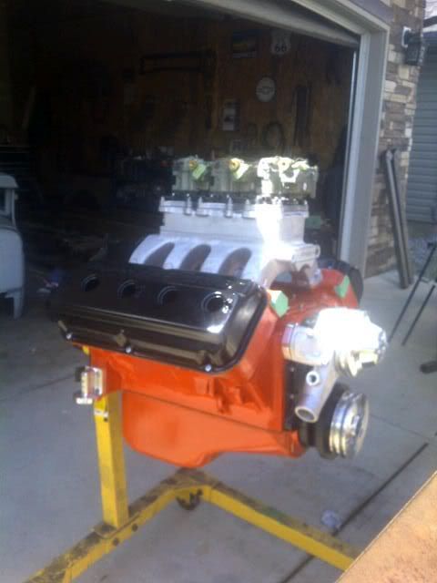

    I scored a seize 354 hemi for it and a year later it's been rebuilt and ready to rock with a tunnel ram and 3 deuce set up:cool:
    So that's a crash course on where the build is at, I'm ready to tear it all down and do the final welding and paint on the chassis and start re-assembly. Got the air ride plumbed and working, here's a link to a short vid on youtube if anyones' intereseted:

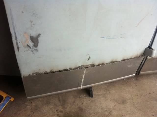

    I had put a lower patch in the passenger door some time ago and wasn't happy with it, I realized I should have shrunk the patch to follow the convex of the door before I installed it so I cut it out and started it again.
    2 minutes on the shrinker gave it the shape it was needing prior to install:
    Not even tacked in yet and it's an obvious difference in how well it's going to fit. I'll finish it tonight after the wife and kid go to bed:

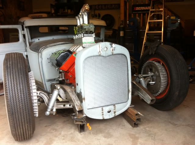

    Decided to spend the day sectioning the grill shell, the one I have is pretty rough so I want to make a new one from sheetmetal but need to section this one first so I can use it for a pattern. Typically I would use poster board but this shell needs to be cut vertically as well as horizontally because the rad isn't correct for 30/31 shells like I was told when I bought it so I wasn't sure on the paper pattern and didn't want to do it twice. A fair bit more work but it was fun.
    Here you can see how poor the fit was horizontally to the rad and get an idea of what needed to but out:
    Cut out 4" vertically:
    Then cut the bottom 3" out on each side of center, it needs to come in 1" on both sides near the bottom, I used the cut out section and scribed where I needed to trim it for the best fit, it also required some relief cuts and trimming at the top:
    All trimmed and tacked up, might as well throw it up to the car and have a look:
    Now I'm excited, threw a set of headlight buckets up too[​IMG] I'm not using these ones just couldn't resist:
    Here's the number one problem with the rad and the car so low, the outlet won't work as I have no place to run the hose to the water pump, I'll need to cut it off and make a new outlet that sits at 90 degrees then I'll be able to run the hose up and over the crossmember. I had to do this on a friends sedan also, it worked well.
    O.K so play time has to end, laid out the pattern on a piece of sheetmetal:
    Added the sides and bottom flange to the pattern, the top piece will be seperate, it's too much to try and tip the whole thing in the bead roller:
    Cut it out and ran it threw the english wheel 2 times at lower pressure with a low crown wheel to hopefully help it from going concave when I put the step in, it seemed to have worked just fine:
    Next I tipped the sides and the bottom flange, I had to shrink the lower flange after.
    Then I ran out of time so I'll have to do the top tomorrow as well as the inside flange which is also seperate.
