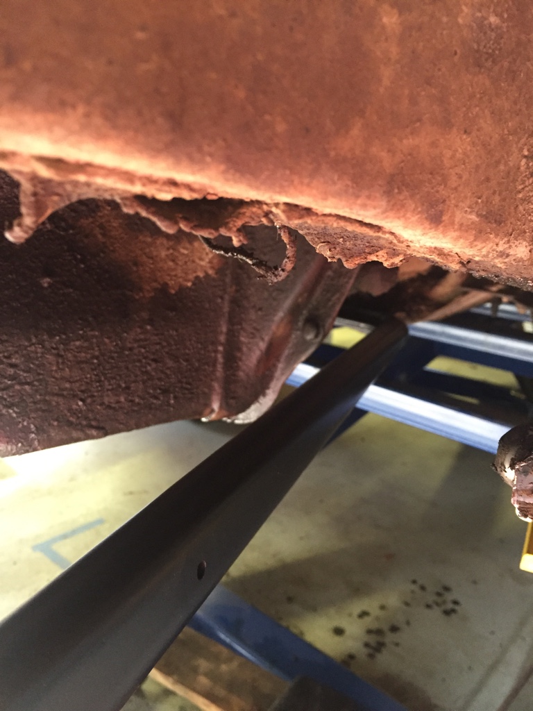

    No luck with the left spring perch bolt. Modified a prop puller to press it out. Heated the shit out of the axle (glowing) and still couldn't get it to budge. I don't want to damage the axle or the wishbone so it's going to DiFalco's shop next week to see if he can get it out unless there are any other suggestions???? ImageUploadedByH.A.M.B.1469912044.824874.jpg

    Oh, and David DiFalco was able to separate the perch bolt from the axle and wishbone with some effort. I'm grateful for that.

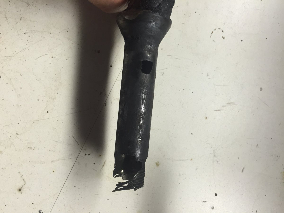

    Here's a couple of pictures of the removed perch bolt. He had to put the axle/wishbone in the mill and plunge through the perch bolt without damaging the axle or wishbone. You can see how much he hogged out before he got it to break free...Now I'm back on track for re-assembly (well, after I get my kingpin bushings replaced) of the front end.
