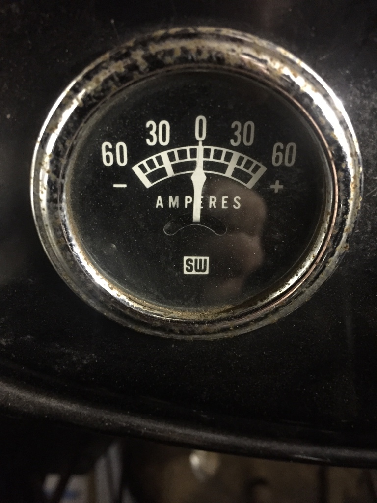

    Picked this up on eBay this week. Nice match to the ammeter. Need to test it to make sure it will work, but for 19 bux I couldn't pass it up. Nice and distressed. [​IMG][​IMG]

    Well, the SW gauge turned out to be a 12V gauge, so I took the guts out of my '47 6V unit and modified it to fit the SW housing. Not bad, but I think I'll keep looking for a SW 6V unit and sell this one. [​IMG]

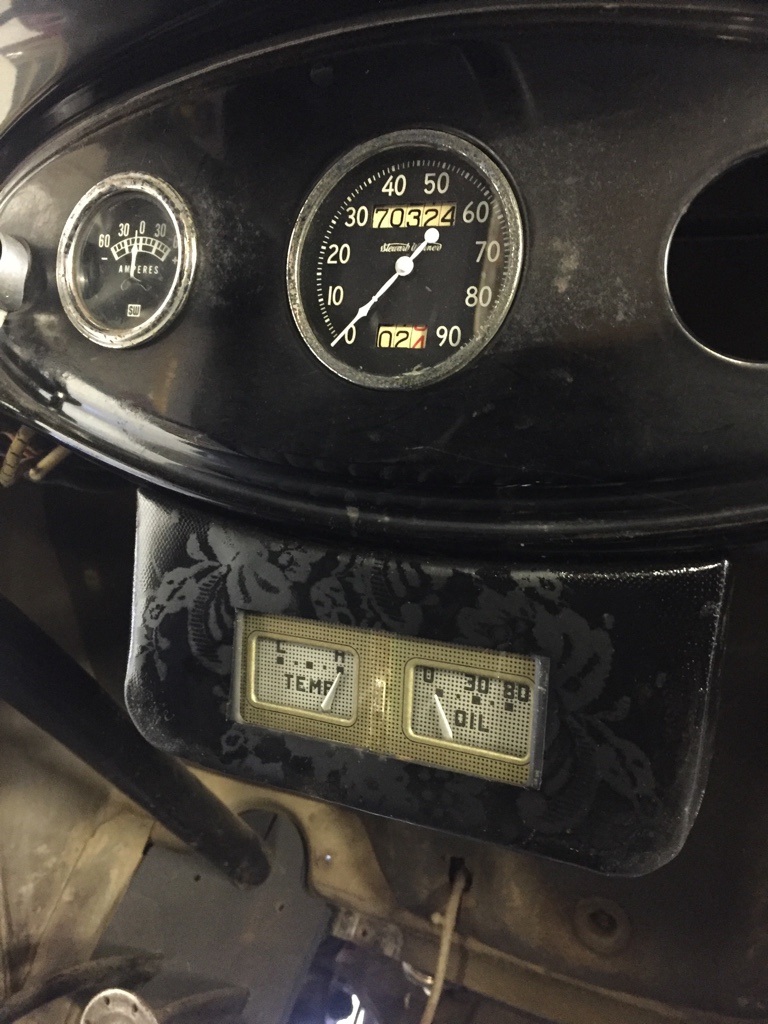

    Got my gauge pod done. I'm not sure I'm completely happy with this but I can always fab another[​IMG]

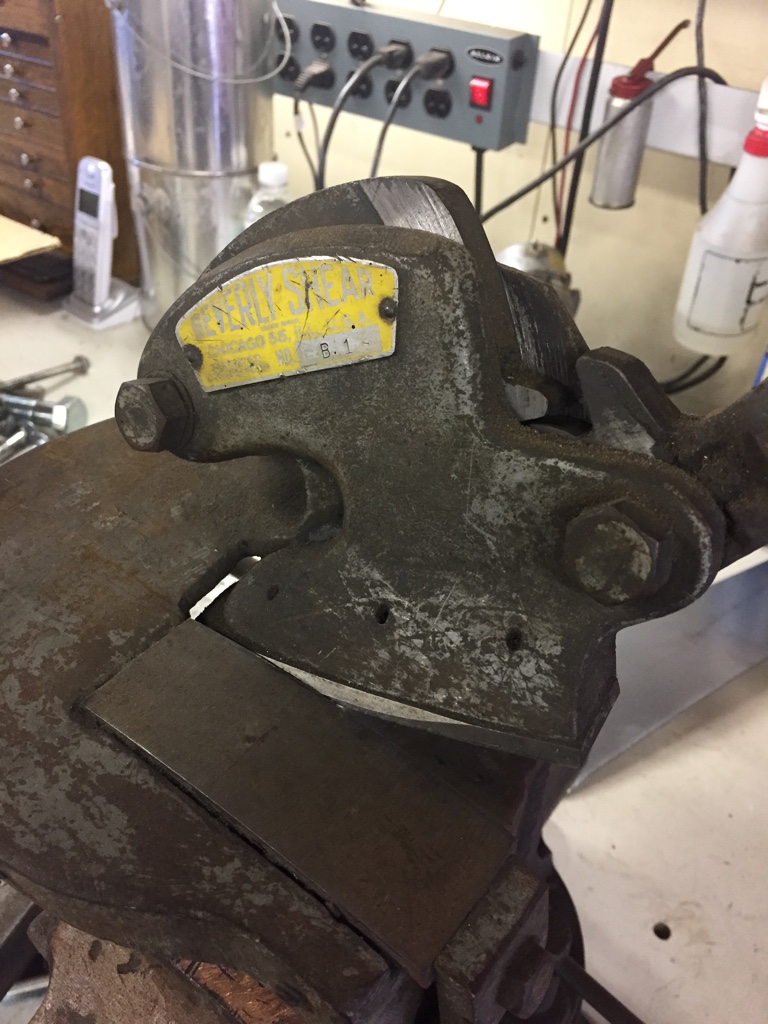

    Been using an old Beverly shear I got from my dad. Very nice tool!

  16. rottenleonard
    Joined: Nov 7, 2008
    Posts: 1,995
    rottenleonard
    I think it looks right at home there.
  17. Craig Owens
    Joined: Jun 28, 2006
    Posts: 464
    Craig Owens
    Nice job on the gauges, Jeff!

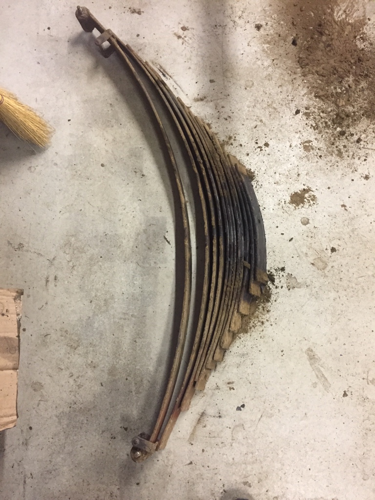

    Working on reversing my rear main leaf. Slow going, but probably best in the end. [​IMG]

  21. What do you have on the end of the hydraulic jack where it contacts the spring?

    For the first half of the bend, nothing. When I started the second half of the bend I realized that the top of the bottle jack would contact the spring in two places, so I taped a dowel pin to the top.
  23. Mart
    Posts: 4,902
    Mart
    Go easy near the centre hole. I was doing well on my 33 spring until it broke when I was working the area near the hole.

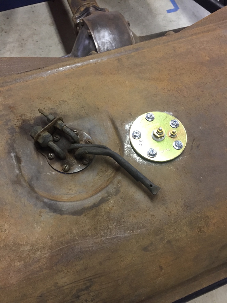

    Got some more done this weekend. Fuel tank is back in. Got the sender and fuel gauge installed. Starting to route the fuel line. [​IMG][​IMG][​IMG]

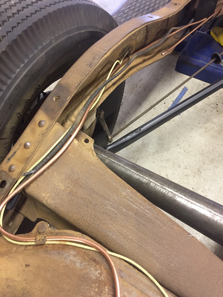

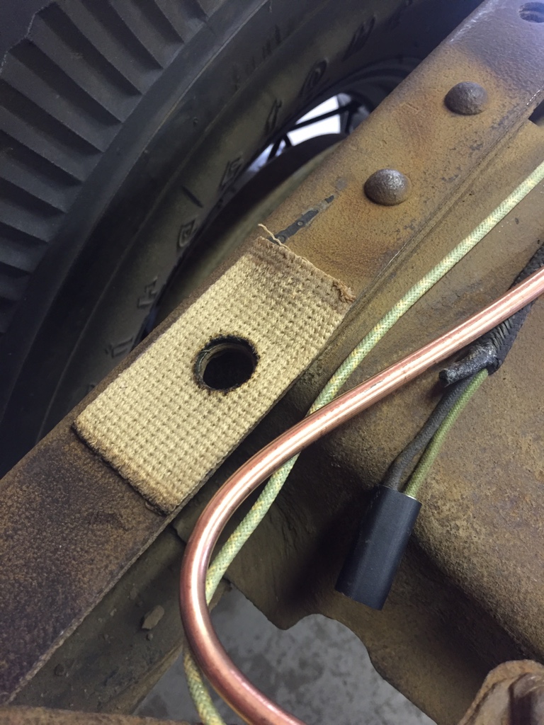

    Got more wiring and fuel line routing done. Still waiting for my Carter fuel pump. Once I have that I can test everything before I put the bed back on. I also fabbed some sheet metal to repair a mounting flange on the bed. [​IMG][​IMG][​IMG]

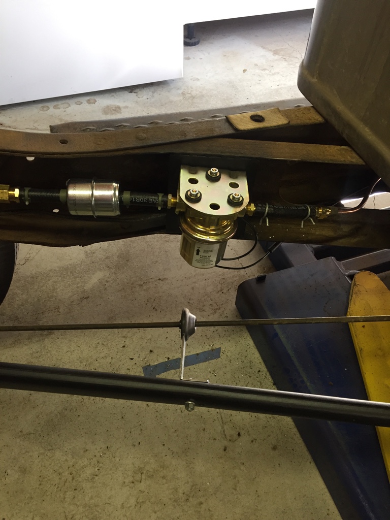

    Fuel pump in. Bed pads on. Hope to get the bed back on today[​IMG][​IMG][​IMG]
    dumprat and bct like this.
  30. dumprat
    Joined: Dec 27, 2006
    Posts: 3,485
    dumprat
    from b.c.
    Nice!
    What fuel pump is that?
