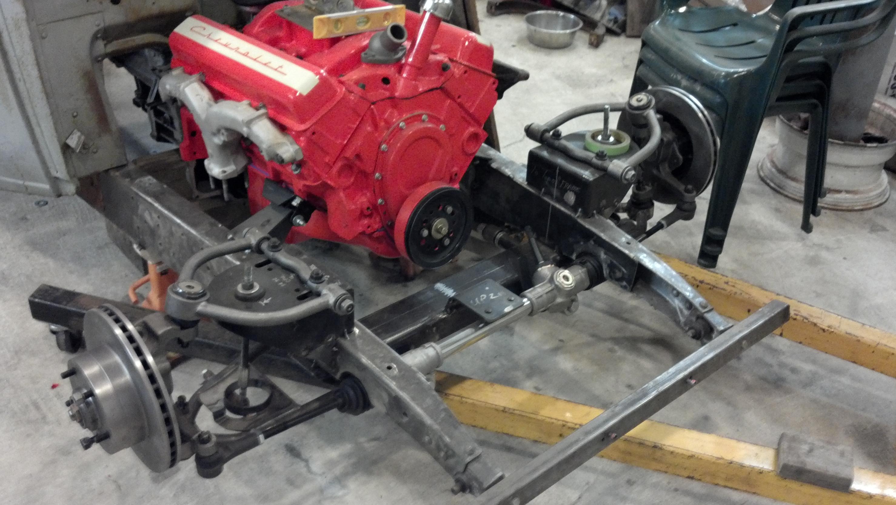

    Trying to get the build caught up to where im at now so here is a little suspension. This is the crossmember Fatman made, they don't offer an ultralow crossmember for 1934-37 trucks. I called them and they made one for me (great people to deal with), with the a-arms flat and dropped spindles my tires tuck with stock ride, and with the crossmember tucked up it's real hard to tell I have a mustang 2 and not traditional dropped axle.

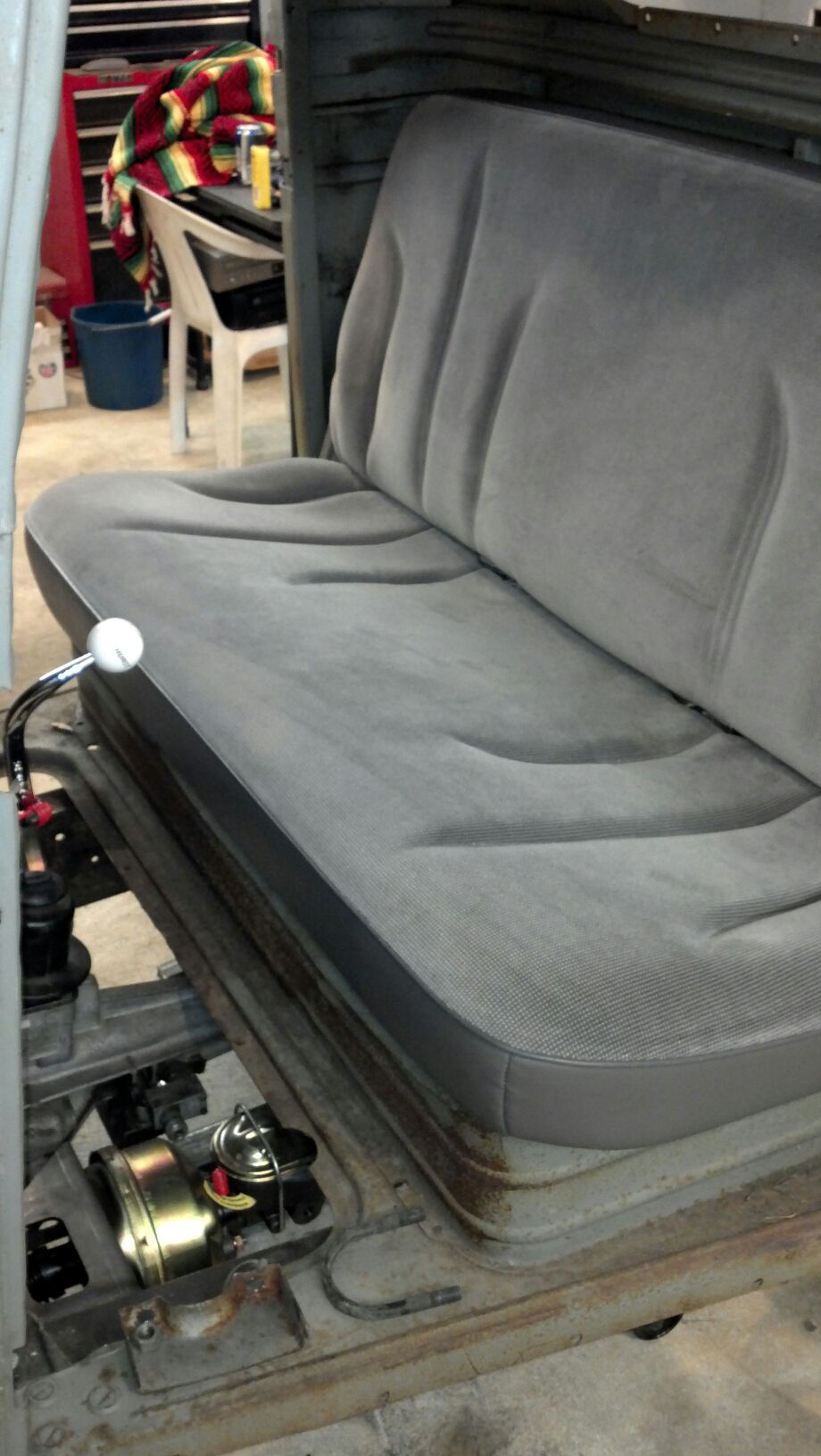

    Mo hair is what I'm hoping to cover the seat in. I walked around several boneyards with my tape looking for something wouldn't have to cut down or smelled like an ashtray. 45 inches wide and is exactly the same size as the original base and super thin back without all the plastic junk that makes it look modern. $30 at the boneyard and doesn't look like anyone has ever sat in it. Third row seat from 90s caravan, best of all folds forward flat then up to give storage under the seat. So far I only have one mole, guessing it will take couple hundred more to cover the whole seat.

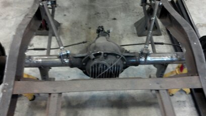

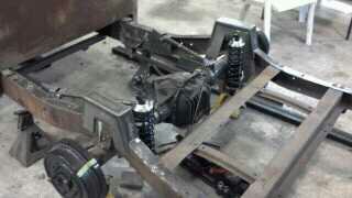

    Rear suspension is coming together, no bind in the travel. Now I'm starting on the notches and crossbar to catch the top of the coilovers. the rear fenders are small with not alot of height to tuck tires so I wont need much notch, maybe just half the rail to give room for a snubber. All the rear suspension pieces came unwelded from welderseries.com. You can save a ton of money and the products are great, they helped me with the transmount for the T5 and had great ideas.

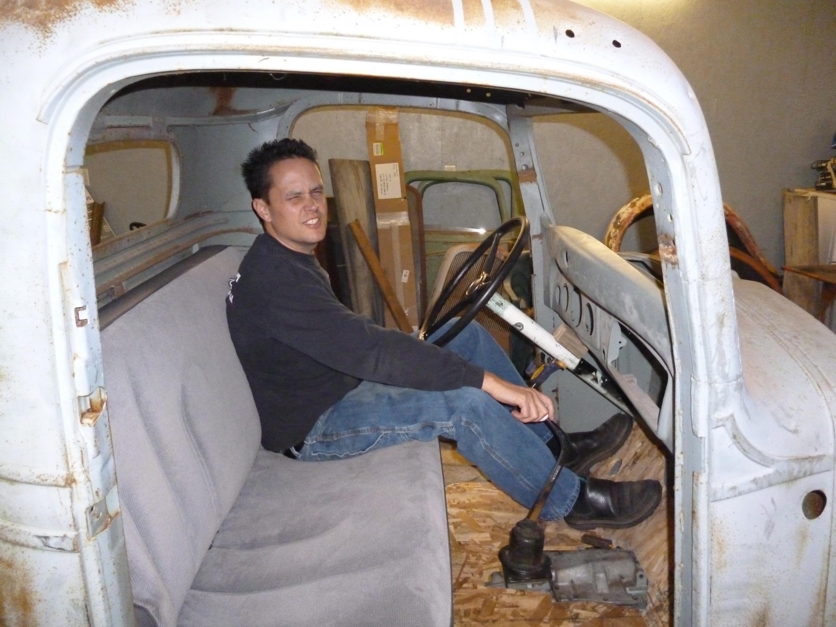

    Had my cousin Puke (who he is not what he does) sit in the truck and make sure column was in correct location before I make a column drop. Was pretty late lots of beverages think he was getting ready to grab 2nd gear.
