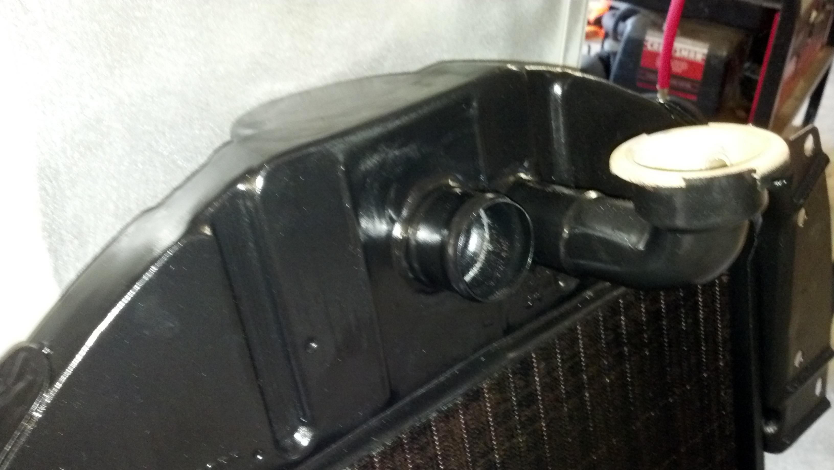

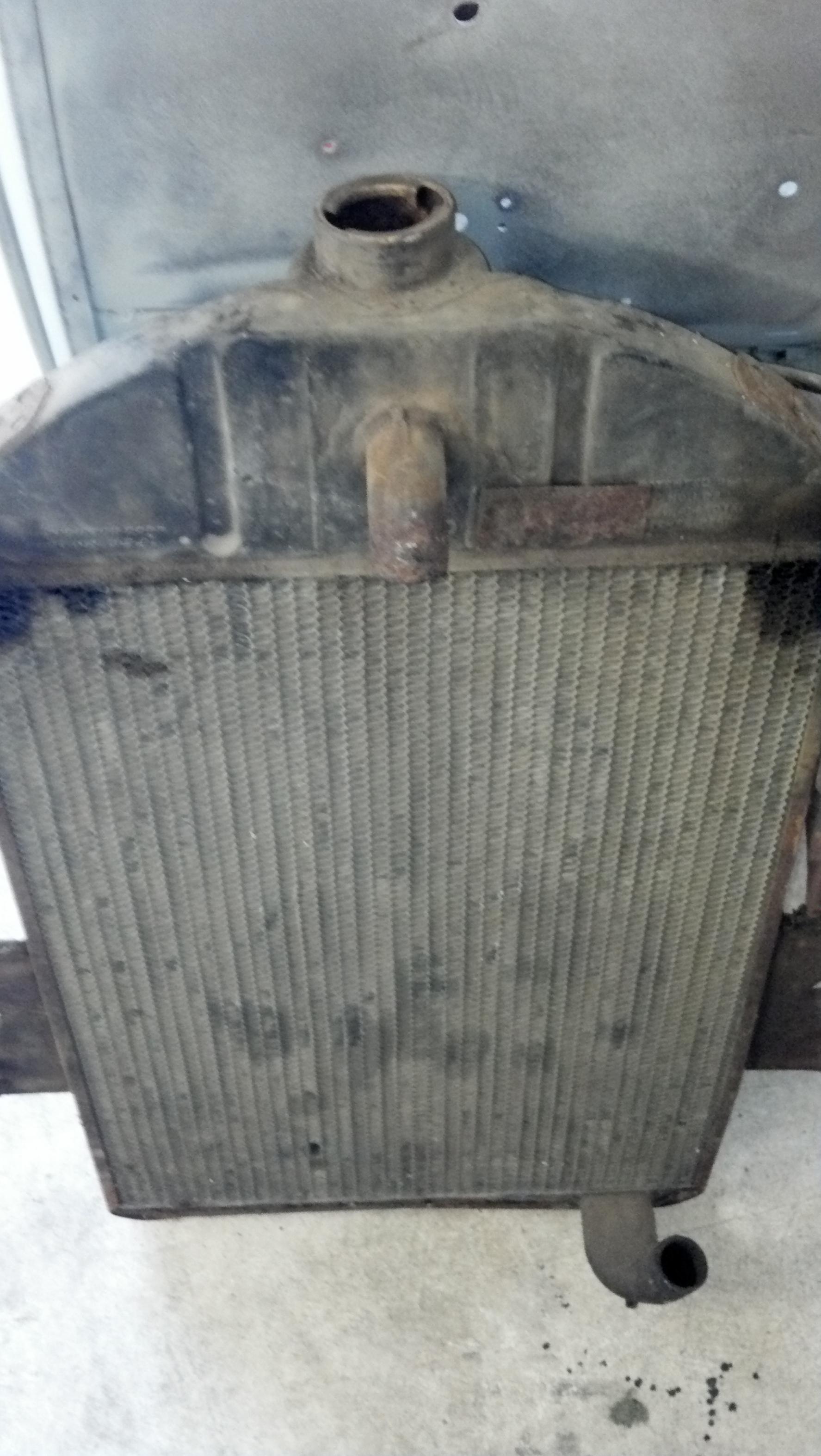

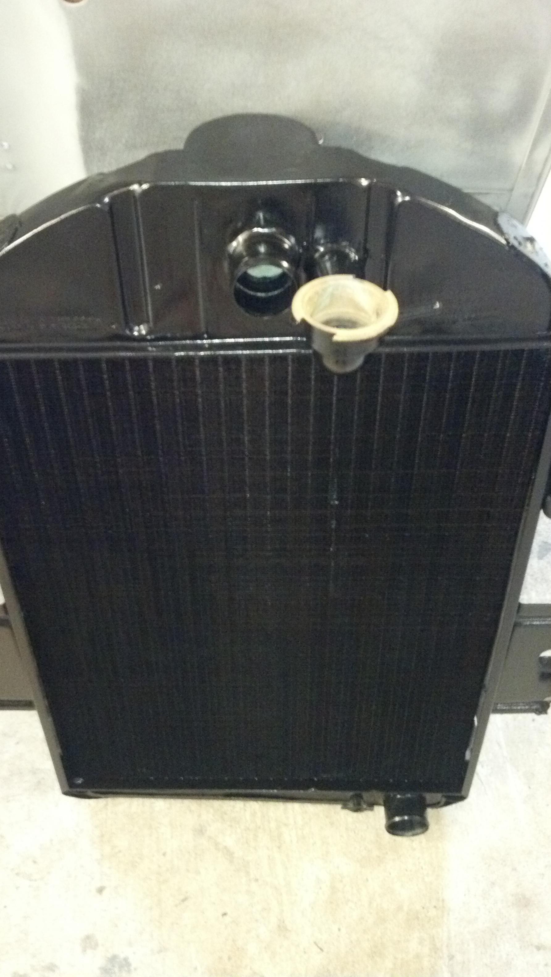

    Well spent most of the night trying to get my old Wayne compressor working again so I can finish sandblasting.
    Wards in Bremerton did a great job on the radiator. He moved the cap and filled the old hole, installed a petcock, recored, and installed correct size inlet/outlet connections. Now I can fill the hole in the grill and use standard 55 chevy car hoses from any auto parts store.

    That radiator came out bitchen! Mine is some hacked ford truck unit....but it works for now.

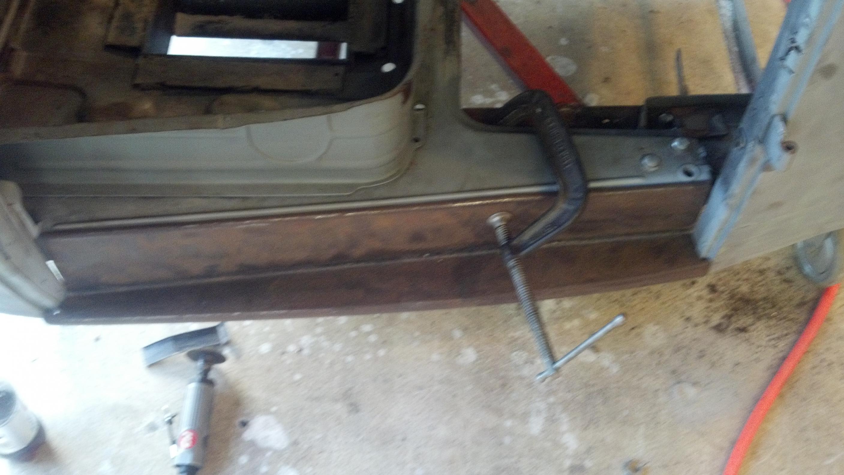

    Cabs is all sandblasted, now on to some much needed repairs.
    Only rockers I have are for a 34 and attach to the wood instead of screw to the steel. Little trimming and some new brackets and rockers are fitting great.

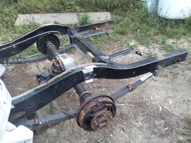

    Its been over ten years since we last worked on my truck
    Gary & I are installing a Posies rear leaf spring weld in kit
    to a 8" rear (49" wide inside). Will post pics asap
    There was an early nova 10 bolt rear (55"ins)
    Any advice or tips on the shock mts location?
    Can they be tilted back or need to be straight?
    Close to outboard or inboard?
    Any one have pics?
  21. nhmikel
    Joined: Jun 29, 2012
    Posts: 308
    nhmikel
    from NH
    Heres the install pic
    thoughts on shock location?

    Anybody know what angle we tilt back the shocks?
    Or do we just go straight up (front to back)
    POSIES recommends them to be about 1" from the axle saddle (lowers)
    and the uppers 9-10" in from the framexrail.
    So my concern is front to rear??? Straight up or can we tilt the
    uppers back to reach the rear cross member(sharp angle imho)
    Any suggestions?
  24. I'm mounting my shocks on my 33 Chevy with a Posies rear leaf kit. They are straight up from front to back. I asked Posies what angle to mount the shocks as you look at it from the rear. They said 20 to 30 degrees tilted in from the top. I'll try to get you some pics or you can come over and look at it. PM me and let me know where you are in New Hampshire.
  25. nhmikel
    Posts: 308
    nhmikel
    from NH
    Awesome....I am Dunbarton, 15 minutes from you.
    I also used the Posies kit. Got it welded in today
    Straight up sounds best, going to add cross member to mount
    the shocks
    Posies were clear on the angle in but did not mention "straight" up
    When are you going to mount?
