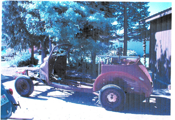

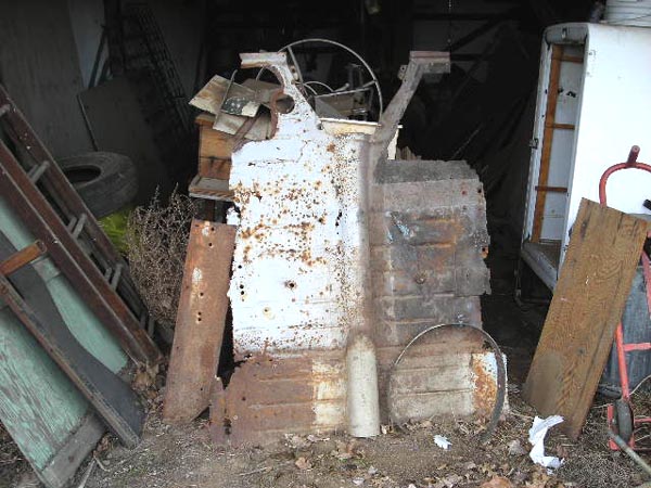

    I had it shipped out here to Washington State. Here it is coming off the trailer. The floor of the trailer was covered with rust.....
    First inspection
    I told the driver not to worry as I was expecting a rough car to be delivered. I must have been out of my mind! That's me the 39 Guy on the left almost 17 years younger than now.

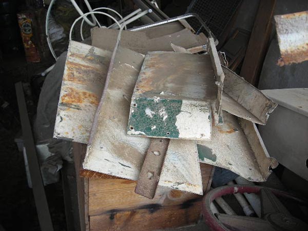

    Unfortunately the floor of the car was wasted. This front section of the floor was covered by
    miscellaneous pieces of sheet metal and road signs.
    These were the rocker panels.

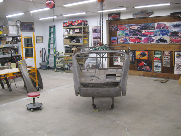

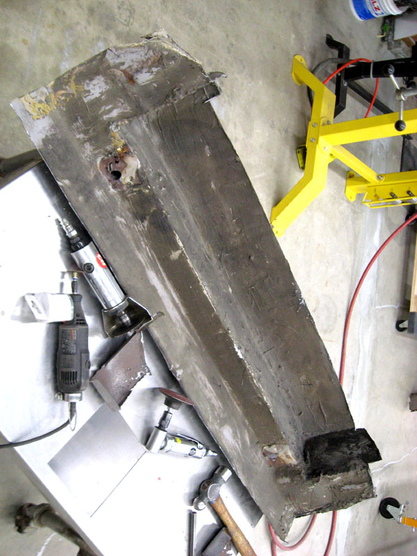

    After building a tube framework to support the body and maintain those door gaps to some degree.
    I loaded up the car and took it to a guy up the road for sand blasting.
    The magnitude of the project is starting to sink in by now.
    The rear of the car still looks pretty good before blasting.......

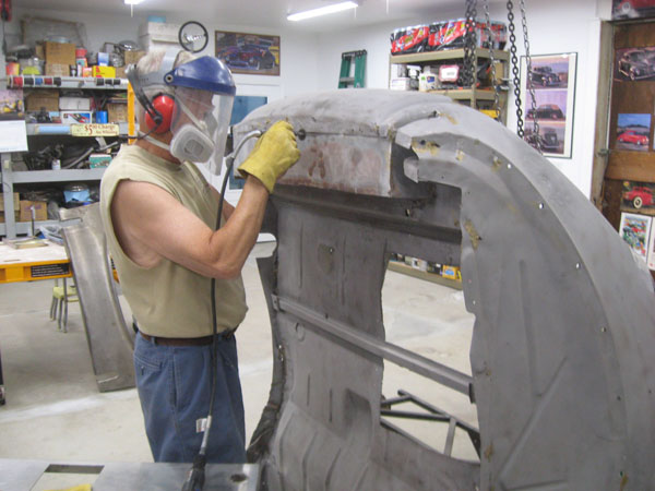

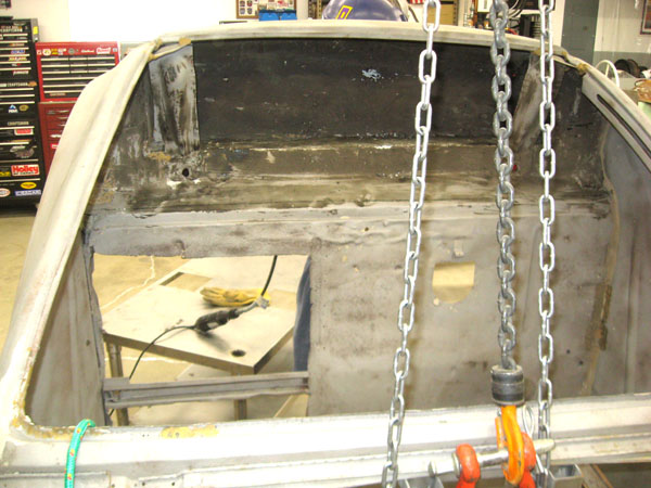

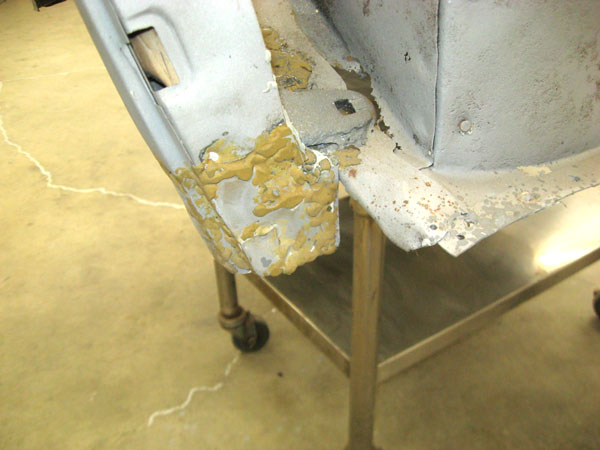

    I think I will do an initial tour of the rear quarter of the car so you can see what was found after the car was sand blasted. To say the least it was pretty much a shock, bondo covered many sins here.. It's good we waited until now to try to save , as our skill and tools have improved somewhat over the last ten years. This will be picture heavy.
    A PO that started this restoration back in the 60's must have only had an acetylene torchand some ball peen hammers to work with.
    Brass is everywhere on this end of the car.Some of this bottom corner had some welding
    done to it.
    All of this brass will be cut out and replaced.We will have to remove the wood to make some
    of the repairs to the C pillar.
    This area was covered with seam sealer. Note the rust on the C pillar support. The rest of the
    body shows little signs of surface rust after 15 years of storage in the shop and trailer after sand blasting.
    Should be interesting getting this wood out.
    This side of the floor had been covered with screwed on steel sheet when I got the car.
    Fortunately this section will be replaced by a new wheel tub so we can cut most of this
    brass brazed patch out.
    The trunk seal flange is pretty much ruined. We will replace it with new metal as needed.
    This area is the drivers side C pillar and inner fender.It is full of little 2x3 patches of
    steel. on the bottom inner fender area and 1 x 2 patches around the upper fender rim.
    I think this will be our biggest challenge of the rear quarter.
    This is the bottom of the C pillar on the passenger side.
    I will continue the tour in my next post.

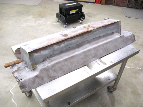

    Well we have had enough tour for now. We got off on some other projects for a couple of weeks and then started working on the Tub again.

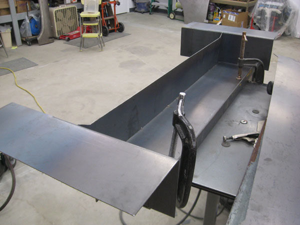

    We stood the quarter up on its C pillar and cut the tool box out.
    The original tool box had been replaced with some miscellaneous sheet metal although it would have worked it was way too rough and covered with bondo and tar.
    All we gotta do is copy this thing.......well and make it better. As far as I know no one makes a toolbox for the sedans. So I decided to make one. Like I said the shape of this box was good
    I think the previous builder wanted this thing water tight considering all of the tar applied.

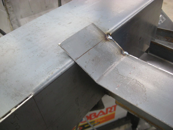

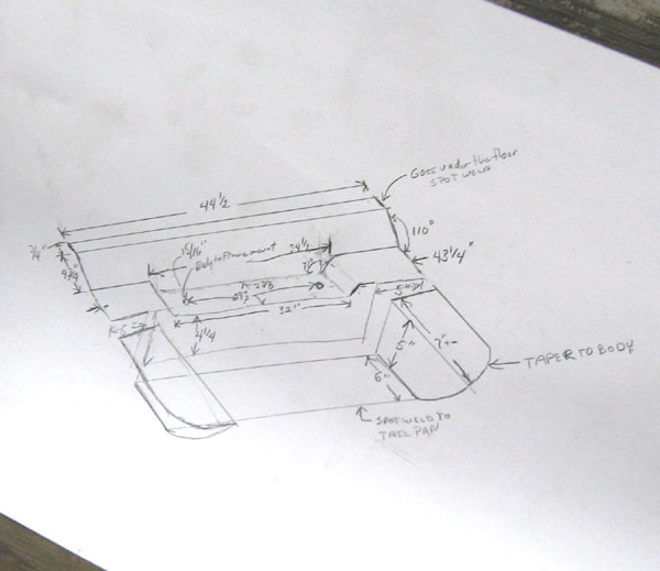

    Soi I drew up a plan .
    I had some 16 gauge steel on hand and decided to make the box from that. I think that was little to heavy
    for this project but it will work.
    Left this flange a little long and trimmed it later. This as far as I have gone on this part for now. I left every dimension a little long for now and just tacked it together in case I have to take it apart to fit it in the car.
