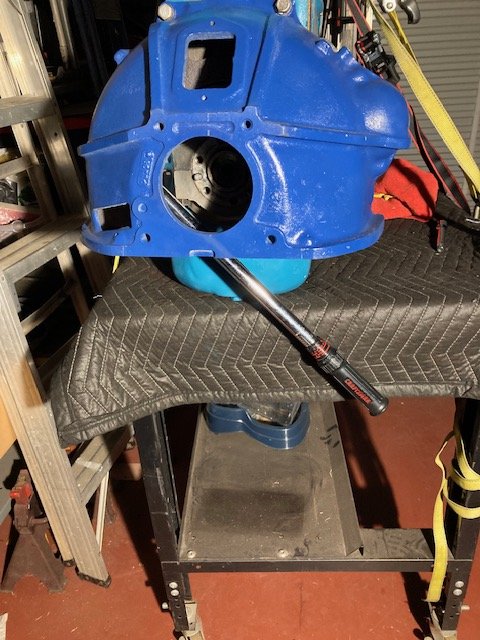

    IMG_2136.jpg Today I torqued the bell housing bolts IMG_2136.jpg IMG_2137.jpg IMG_2138.jpg IMG_2139.jpg IMG_2140.jpg to 50lbs, was going to install the flywheel and clutch assembly but i went a head and cleaned all the threads on the bolts. I did verify that I have a 6 volt flywheel and starter. Hopefully I can install the clutch tomorrow

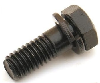

    Do you have pressure plate bolts? they have a plain shank below the head, to help center the PP.
  13. BoxOfParts
    Joined: Jan 27, 2024
    Posts: 27
    BoxOfParts
    These are the ones that I took off the pressure plate
  14. squirrel
    Joined: Sep 23, 2004
    Posts: 56,146
    squirrel
    Ok...I would get the right ones, but that's just me.

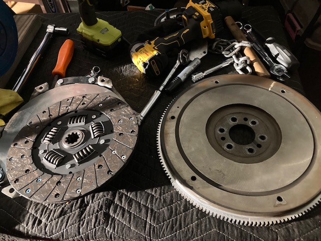

    Got new pp bolts and installed the flywheel .
    Torqued the flywheel bolts to 62lbs with locktite and in a cross battern,
    Started at 20,40,60 then 62lbs. Putting on the clutch was a bear but finally got it .
    I only have a 1/2 inch drive torque wrench and starts at 20 ft lbs and it felt like either the bolt was going to snap or the bolt would strip. I am going to a friends house to borrow his 3/8 dr torque wrench so i can torque them down without worries.
    I did find what seems to be the original bolts
    Good night and thank you all for guidance
    Ed

    I would use the original bolts you found, if all 6 are there.
    Should be able to get 35 ft lbs on them with no problem, if your torque wrench is accurate.
    You used an alignment tool to center the friction disc, I hope.

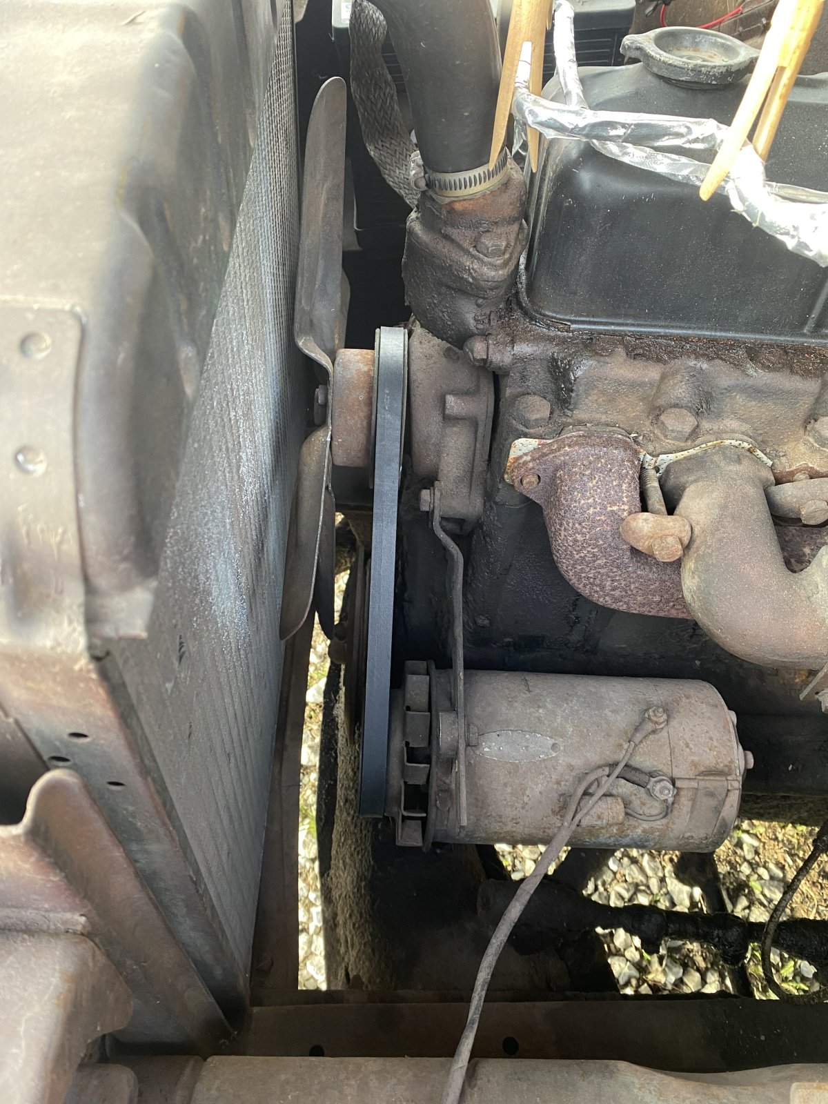

    This is my 51. Although it has the wide belt, taken from the same angle it appears not to align either. But it doesn’t throw the belt. Are you sure it doesn’t fit?

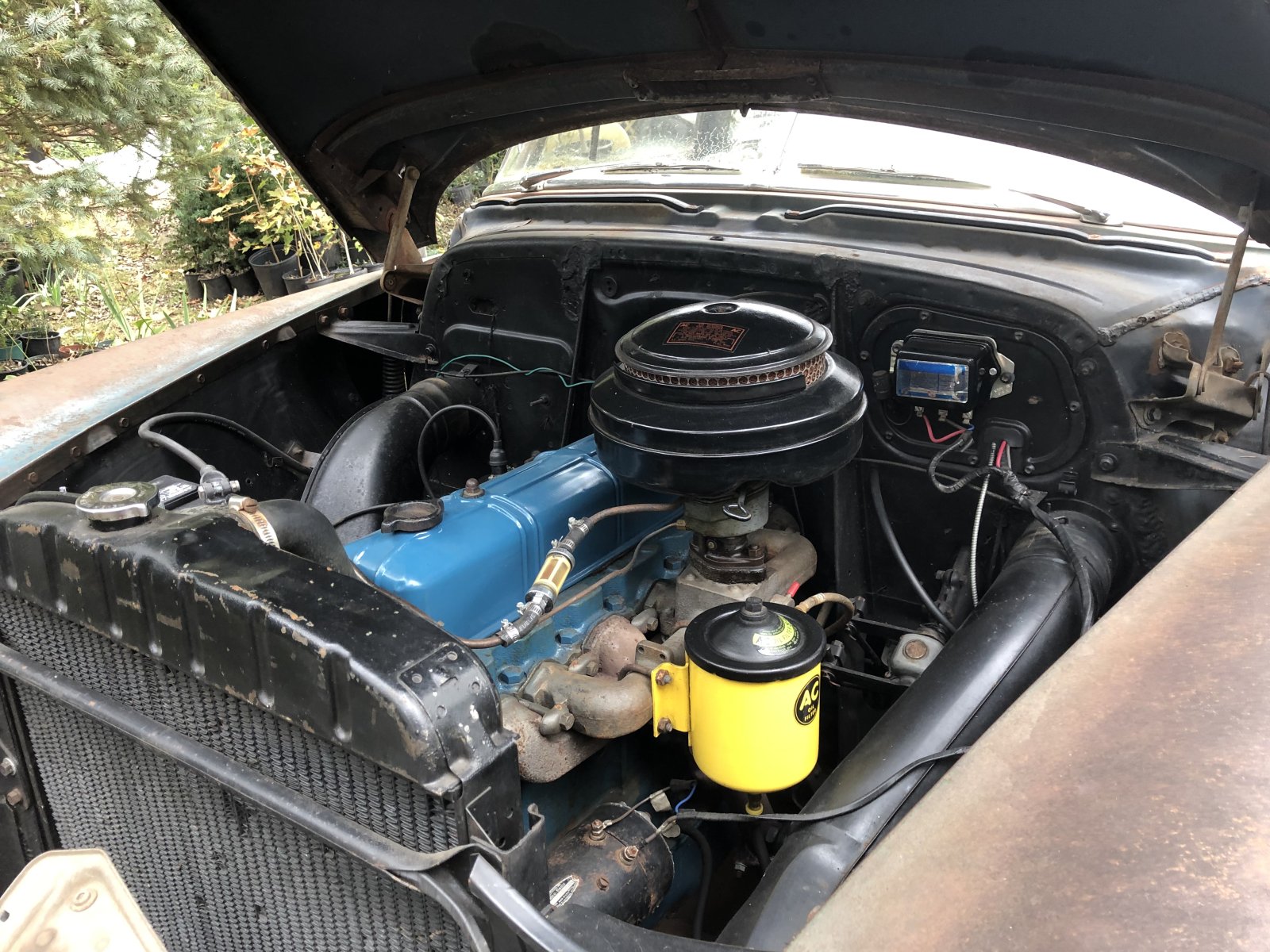

    Time to paint some parts of the engine, it is light blue but I
    dont know the code or name ?
