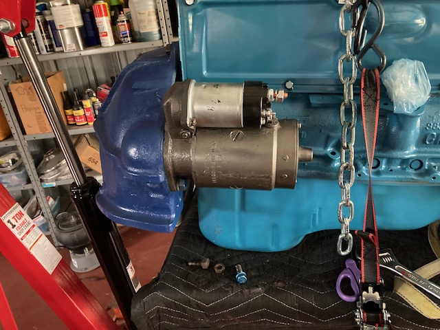

    I had to grinded down the nose of the starter to make it fit the 216 bellhousing ,but its on now
    Going to get the manifolds on this week and it should be ready to go in.

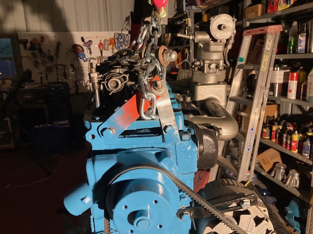

    Had to order the intake rings and intake gaskets ,but its all on IMG_2358.jpg

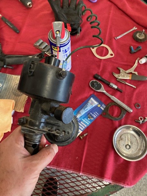

    Going to install the fuel pump,dist and the breather tube this Sunday.
    It should be ready to go in.

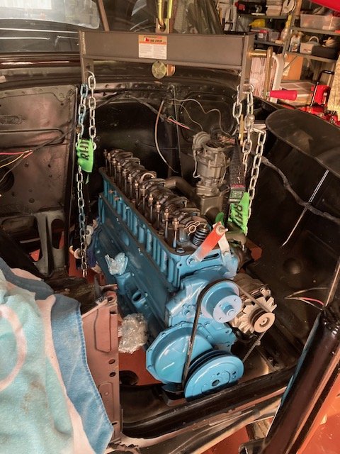

    Any advice where to attach the chain for the engine hoist?

  4. to lift those engines I made a plate that bolts to the two holes where the coil would mount. the bracket extends up and has a hole for a chain to hook/bolt to. the other end of the chain either wraps around the manifold or if the manifold is removed bolts to an intake bolt. this will lift the engine nice and even.

    I got axle straps and put one where the starter mounts and the other i will wrap around the manifold, Thank you for that idea

    watch the balance...lifting an engine below it's center of gravity can result in it flipping over....
    I've attached a chain to the rear intake bolt and the opposite side thermostat housing bolt on the head, iirc
    or remove the rocker assembly and use two of those bolt holes
