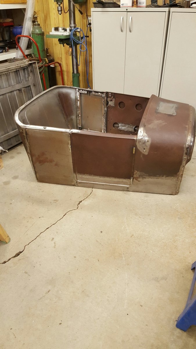

    It's been a while but the welding is done on the frame and the body too.
    I boxed up all the parts after hours of prep and shipped them off to the chrome shop. Ogden Chrome in Utah.
    A 67 pound box :eek: :D
    Have some prep to do on the exhaust and it's off to the coater for a shiny silver thermal ceramic coating, the entire exhaust, headers, Porter mufflers and all will be done end to end inside and out.
    Will be having the body and frame blasted and will start preparing for paint soon.:)
    Then it's build the paint booth in the garage and have at it :) :cool:
    A step at a time :)
    It's going to be a happy new year ;)
    Larry

    I decided to scrap the headers as they just didn't turn out as nice as I wanted them to for a couple of reasons.
    First of which was a cheap junk Chinese steel header kit :mad:
    I should have known better but it's pretty much impossible to make that stuff thicker :D
    So I'm going to order a new set of driveshaft lakes headers from Matt at Gear Drive.
    Then I put the body on the frame to measure for the headers.
    I now have to fit the doors all over again as I finished the welding on the bottom of the body and naturally now the doors don't fit :confused:
    Gotta love these old T Bodies.
    Oh well it just means some more time getting it all straightened out.
    Before all of that I set up a little garage engineering project with a laser to see if my engine and transmission were properly placed in the frame.
    That worked out really well. I was off 1/8 of an inch on the tail shaft.
    Not bad for having used tape measures and string lines :D
    That was easy to fix.
    By the way that one photo looks a little cockeyed, that's just me, everything was straight and level :)
    Maybe now I can make a few more steps forward :D
    Larry
