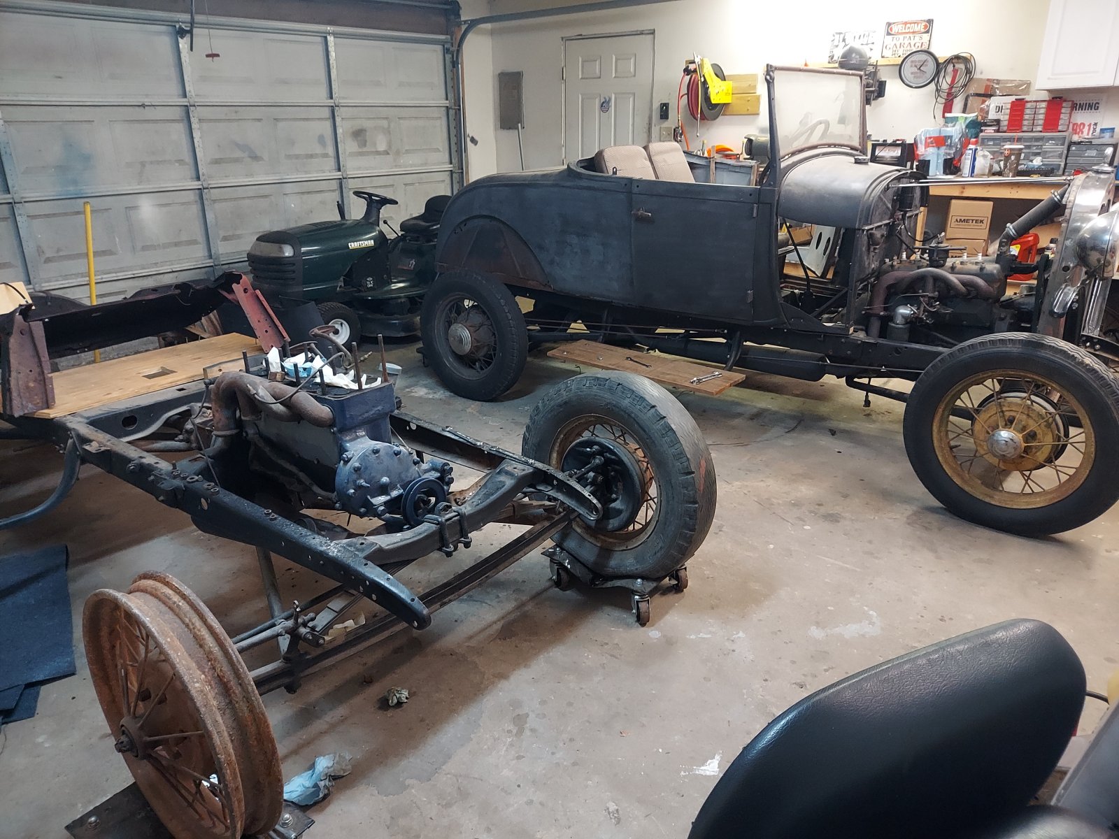

    I got the model b on a stand for the slow rebuild of that. It will get wrapped up and slowly done on the side, but the main focus will still be dialing in the roadster.
    There really is some truth to the statement of "they don't make them like they used to". After about 30 minutes of grinding rivets and half of the car is completely apart to address the subrails. I guess years of being packed full of 15lbs of dirt wasn't the best thing for them. The idea is to get it media blasted and reuse the cross channels in a set of new subrails.

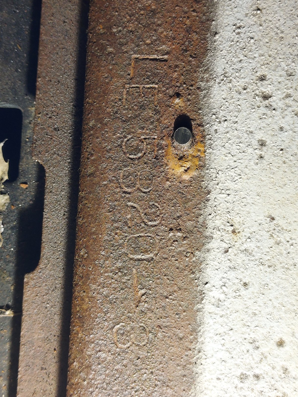

    Your engine passed quality control on 02/27/29 start # 1113763 end #1120420 they built 6658 cars that day. There is some question on gastank dates they're not positive if it's the build date or like the engine the day it passed QC.
    Your dates are close enough you should send them in - http://www.plucks329s.org/studies/studies_firewall.html

    Where did you find the quality control dates? That's some cool detail, I'll definitely send that in to him.

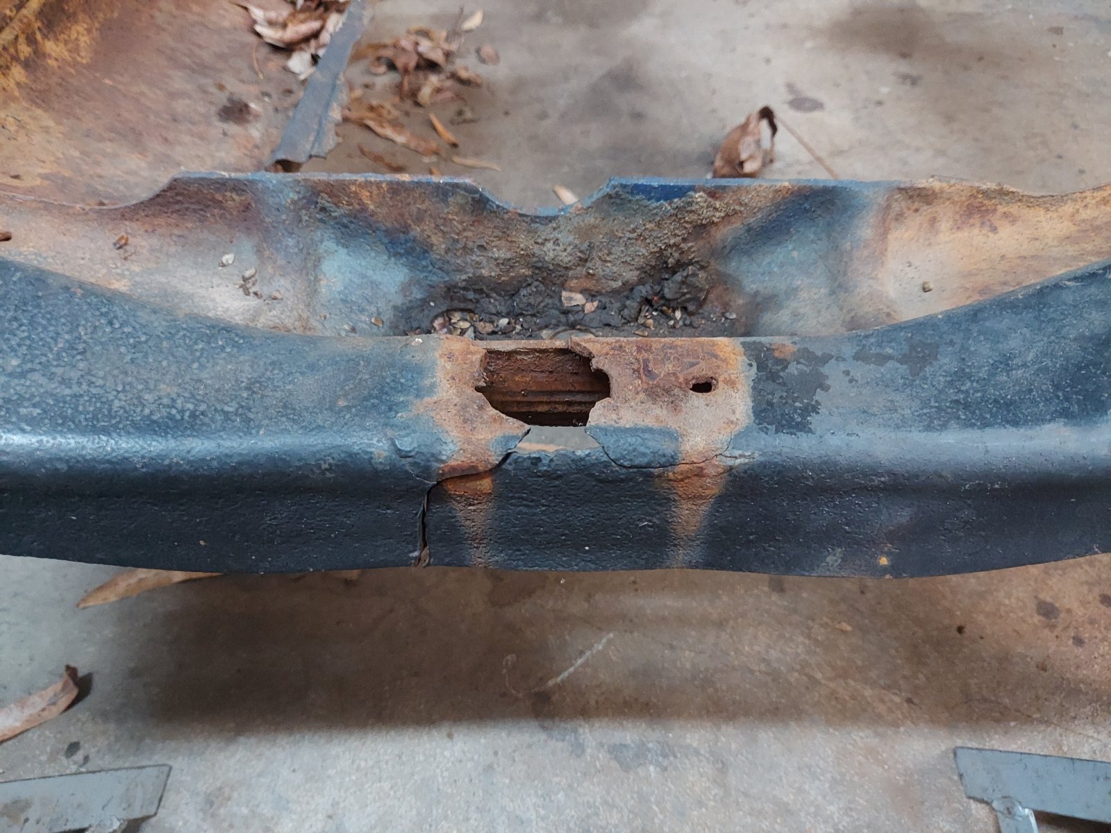

    After getting the subrails back from being media blasted, there was no question that replacing them was the next most logical step. I think they can still be saved so they'll get tucked away in the garage until the day comes that I decide to throw some hours at it. Worst case scenario, they'll make a great reference for a future car.
    After measuring everything eighteen or more times, they are finally mocked up. I decided to replace one of the cross channels as well because the rear of it was badly pitted/rusted through.
    I tacked everything in as it sits then flip it over to weld everything up.
