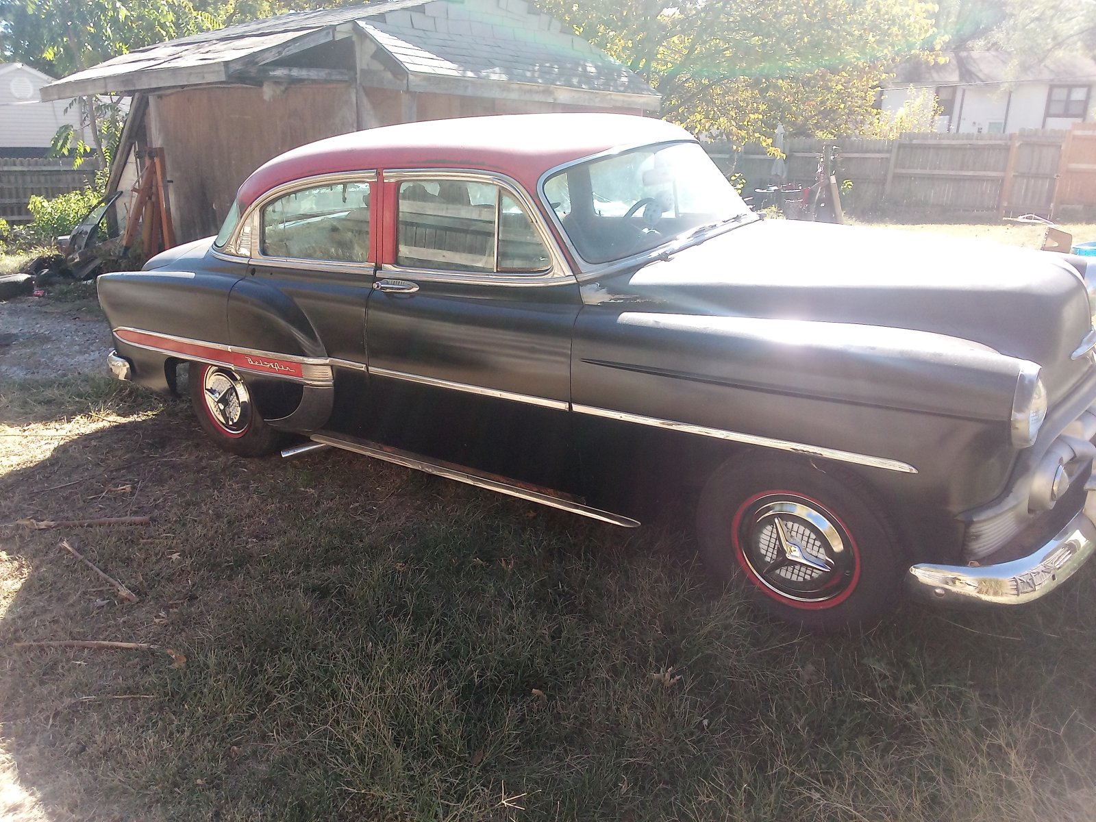

    FB_IMG_1694875386492.jpg FB_IMG_1694875390917.jpg FB_IMG_1694875382887.jpg FB_IMG_1694875395392.jpg FB_IMG_1694875398505.jpg FB_IMG_1694874470378.jpg FB_IMG_1694875402706.jpg Heres some pics of it as purchased lol

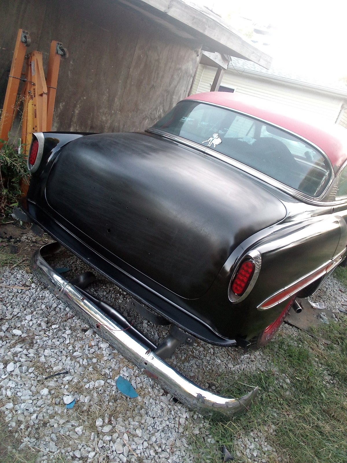

    So this one will be about more rattle can. This actually turned out to be a good before and after pic. Lol. Gonna start on the front door tomorrow and order the rest of the hardware for the trim Tuesday IMG_2023-10-01-18-25-09-717.jpg

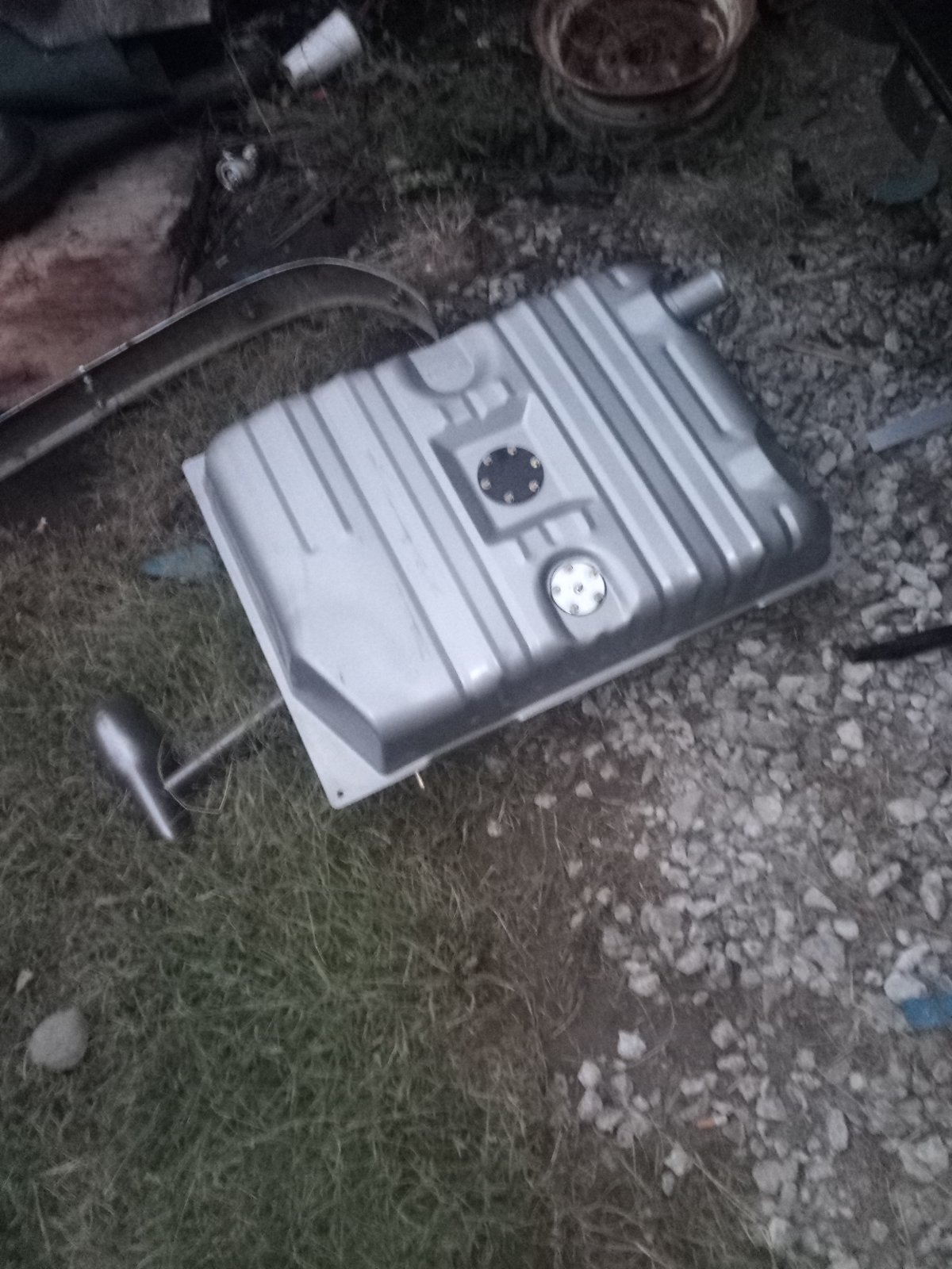

    And got my tank in the mail and installed today. Got a few small things to do to finish it up but it holds gas and the car runs lol. Really wanted a stock tank but they were either a lot higher or from a less reputable shipper than speedway. Ordered this Tuesday night lol. I just wish they supplied rubber gaskets for the sender and intank block off plate instead of crappy cork. I fortunately at least had a new rubber gasket for the sender that I got with the new sender. I'm getting close to being done with the required restoration parts and can get back to custom stuff soon. Lol. Also picked up the 58 Impala rear end this morning. Il start on it in the next couple days IMG_2023-10-12-18-53-41-243.jpg IMG_2023-10-12-19-51-47-022.jpg IMG_2023-10-12-12-03-29-550.jpg

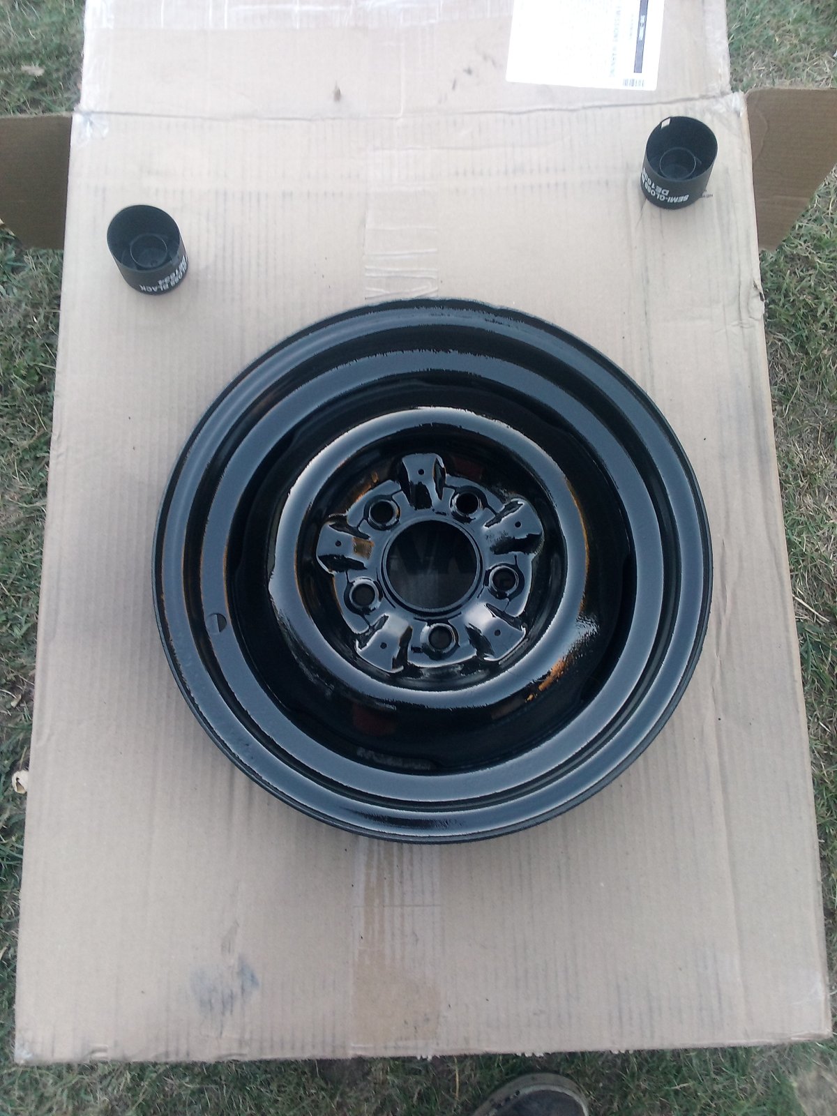

    And as I'm waiting on shipping and budget on more parts I decided to freshen up the one original to my car wheel I got with the car. First pic is after I started hitting it with a wire wheel and before I hit it with the sandblaster at work. Second is after blasting and spraying black to make sure no exposed metal. And finally the red to match the car. Figure I'll throw a whitewall on it and put it in the trunk as my spare with the one 53 Bel Air hubcap I have lol. Kinda tempted to find a full set and reverse and chrome them. I know they aren't the popular hoops for chrome reverse but I'm liking the inner lip IMG_2023-10-17-10-10-45-142.jpg IMG_2023-10-17-17-57-00-063.jpg IMG_2023-10-17-18-20-44-067.jpg

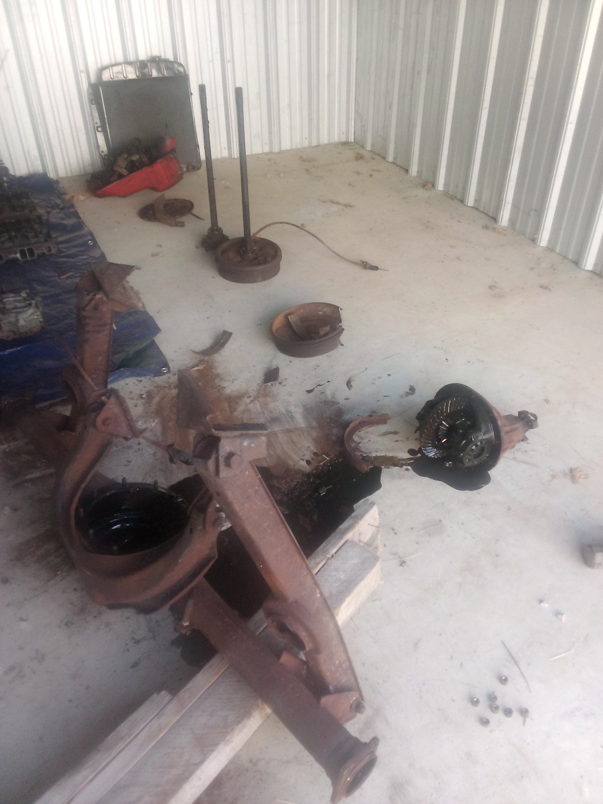

    Finally got the the 58 Impala rear end torn down. Aside from brakes everything seems to be in good shape. Will replace axle bearings. Couldn't find the numbers on the gears but counted pinion turns and roughly took 3.25ish turns to spin ring gear. So going off available gears that year I'm guessing 3.36.....which would be near perfect. Ill clean everything really well and swap mounts. IMG_2023-10-19-17-04-44-747.jpg
