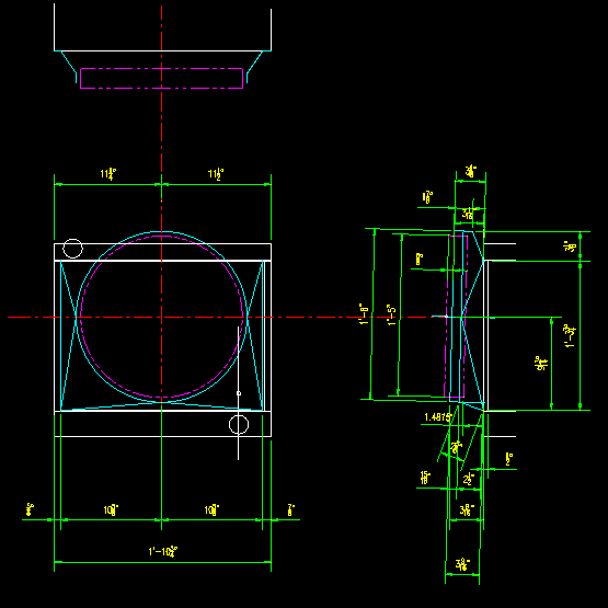

    I've decided I'm not gonna use the electric fan and instead go back to my original plan to use a mechanical fan and build a fan shroud. The 17" fan I had long ago purchased, so first I mounted it with a 1-1/2" fan spacer and then took a lot of careful measurements. Next, I drew the shroud up in CAD. Note that the radiator is 1.5 degrees out of parallel with the fan:

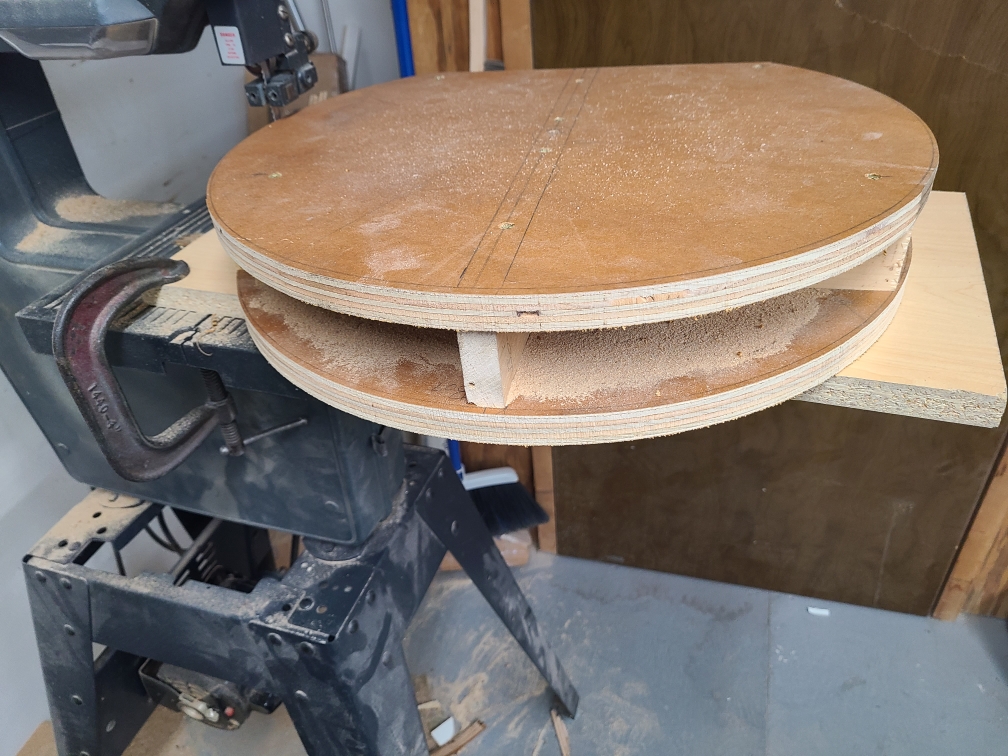

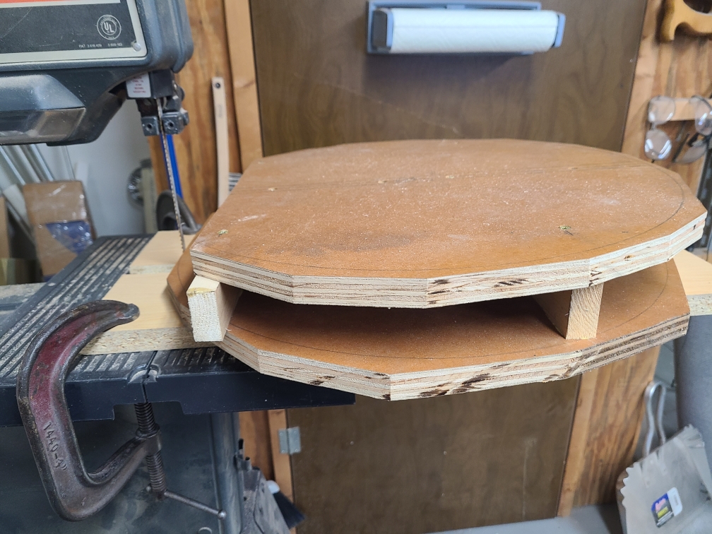

    Today, I made a wood buck, using various scrap wood:
    I am going to clamp an 18" I.D. band around the discs with the proper 1.5 degree taper, which I fabricated out of two almost-discs and spacer blocks. This is the setup on my bandsaw to cut the discs perfectly circular. It's got a pin at the center to rotate it asa a unit and cut the 9" radius:
    This is after the rotation:

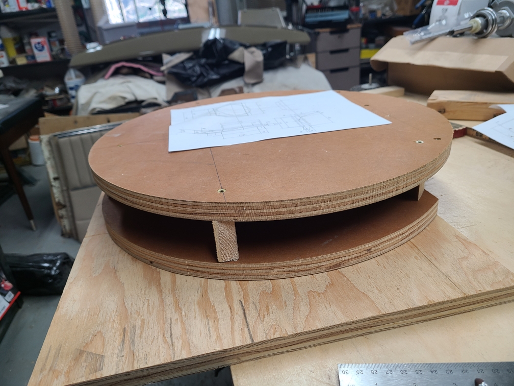

    And here it is with the tapered disc mounted to a plywood piece that simulates the actual size of the radiator frame to which I will mount it with #10 screws and nutserts:
    Well that's where I am now. When the Slick Sand arrives, I will get back on the fender, but, until then, I will start attaching sheet metal to the buck. I'm gonna mount the hoop and then build all round it with the corner pieces, etc., tack weld it together, and cut the inside part of the hoop off and finish weld. We'll se how that goes..
