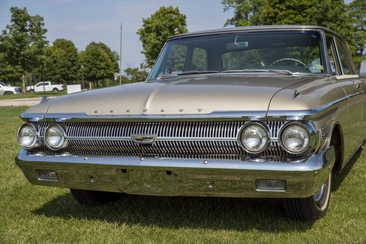

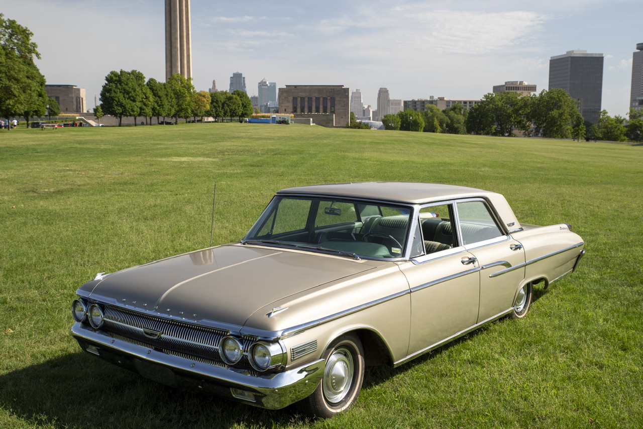

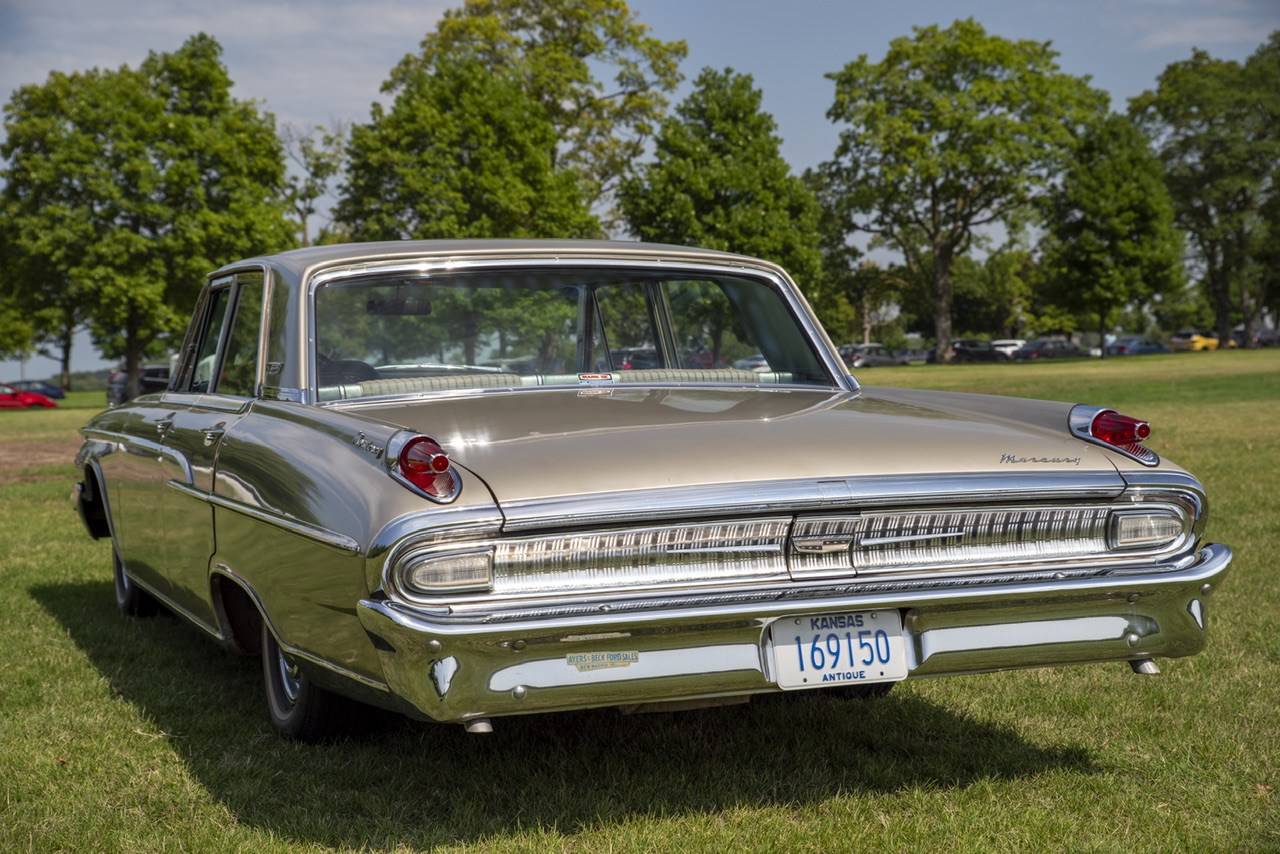

    This all started a couple of years ago when I built a second race car. You can’t have too many race cars can you? Apparently you can! I’ve just not got the time or energy to run two race cars so one had to go. What to replace it with? I started looking at 40s/50s Chevys and Pontiacs but then one day this popped up and I decided it was the one. Yep it’s got too many doors and it’s a Ford in a frock.

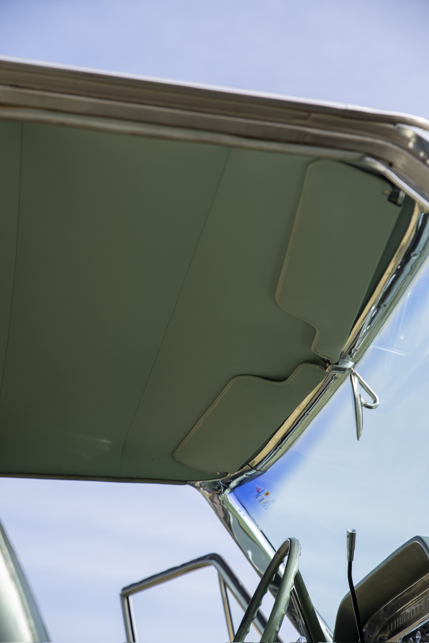

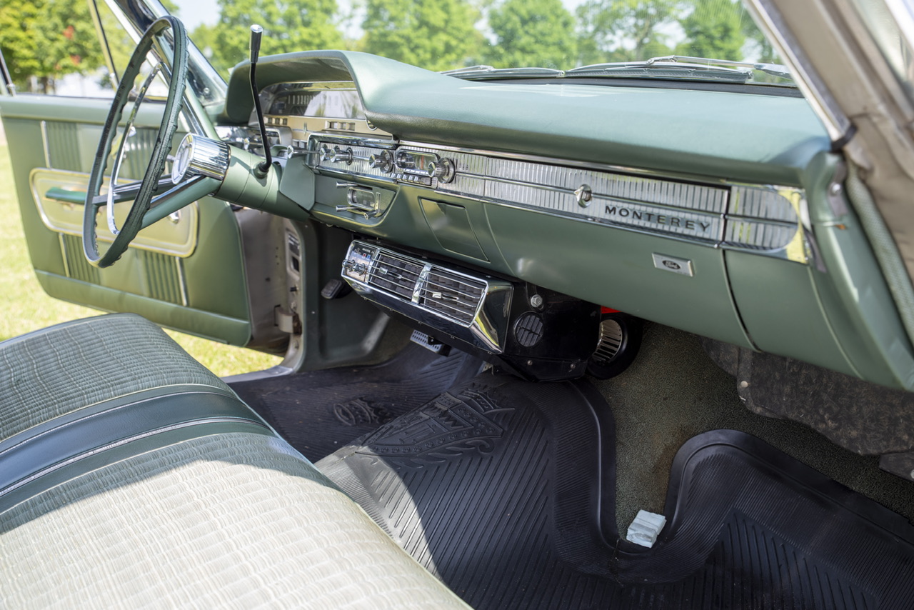

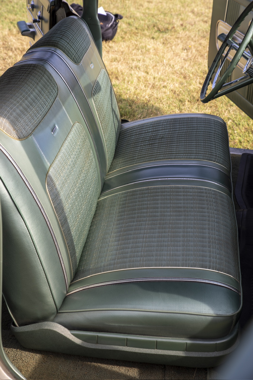

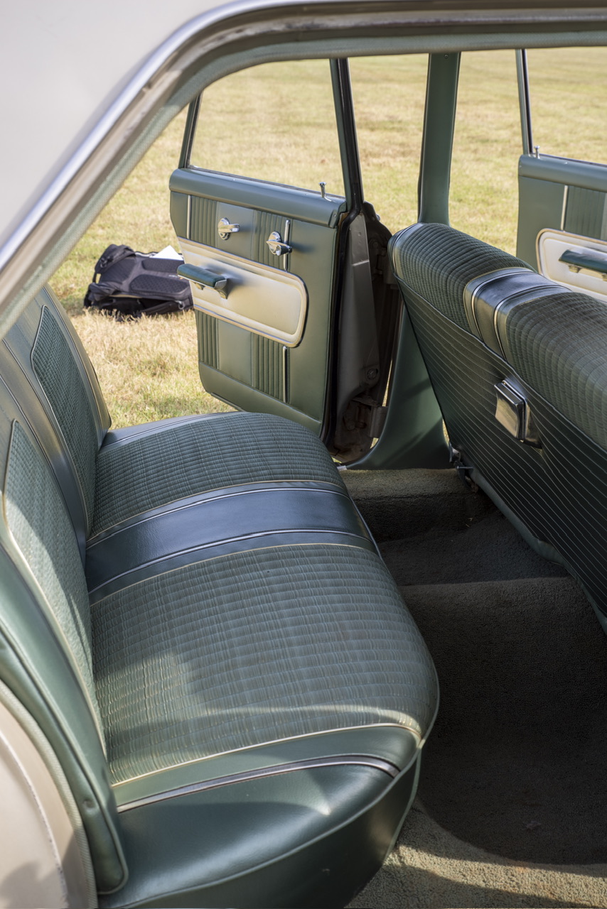

    The interior looked great

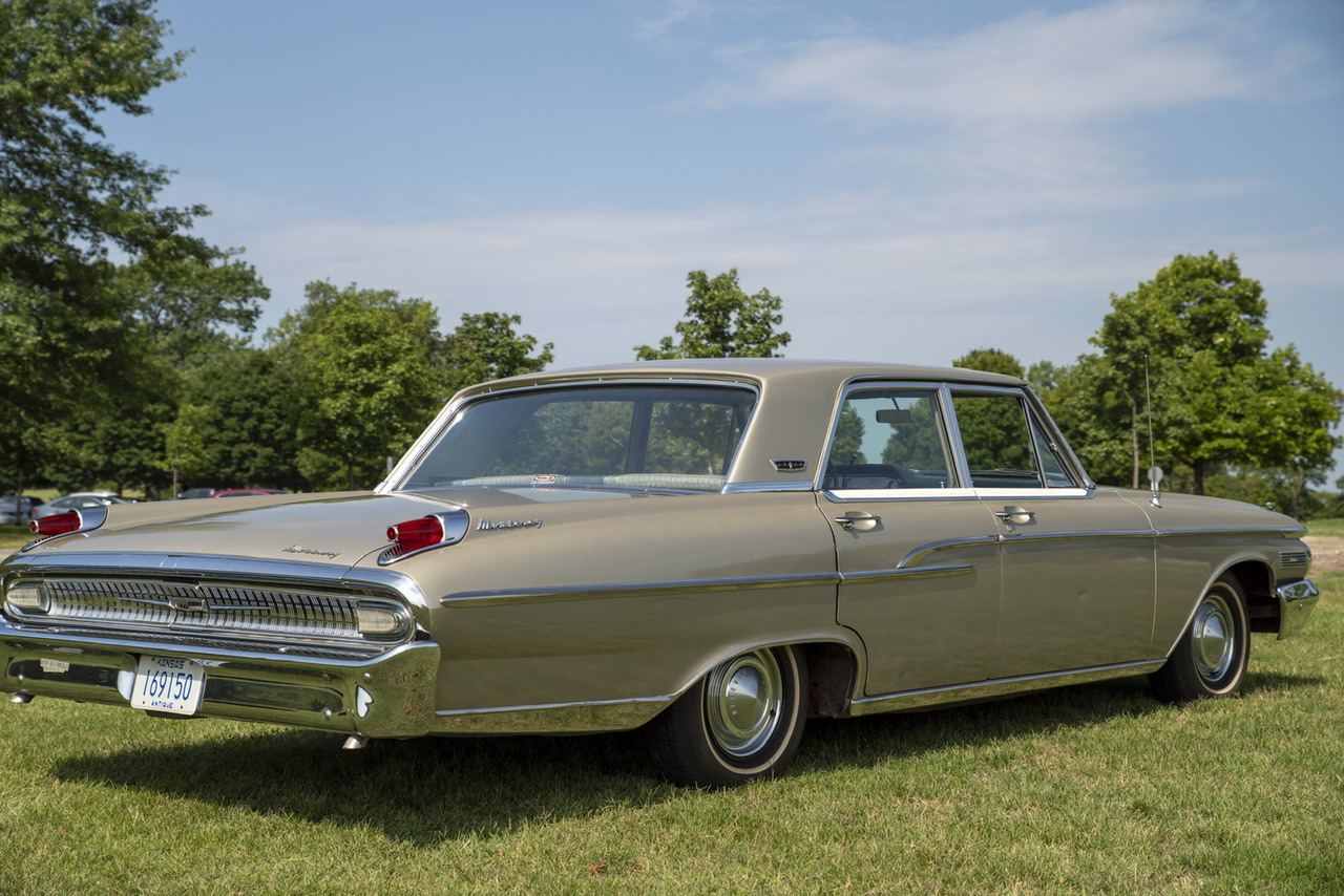

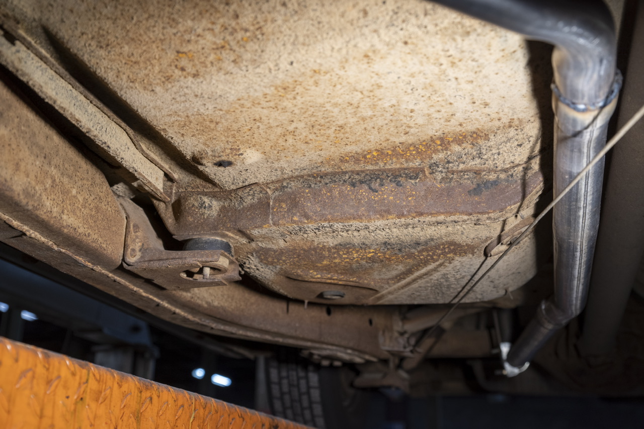

    And the underside is tidy compared with what we’re used to due to road salt over here.
    It seems pretty unmessed with so should be a great starting point not having to fix a bunch of Bubba’s doings.

  2. I’d drive it
    As is
    with a big ole cheesy grin
  3. Looks like a nice, unmolested car to enjoy. Congrats!

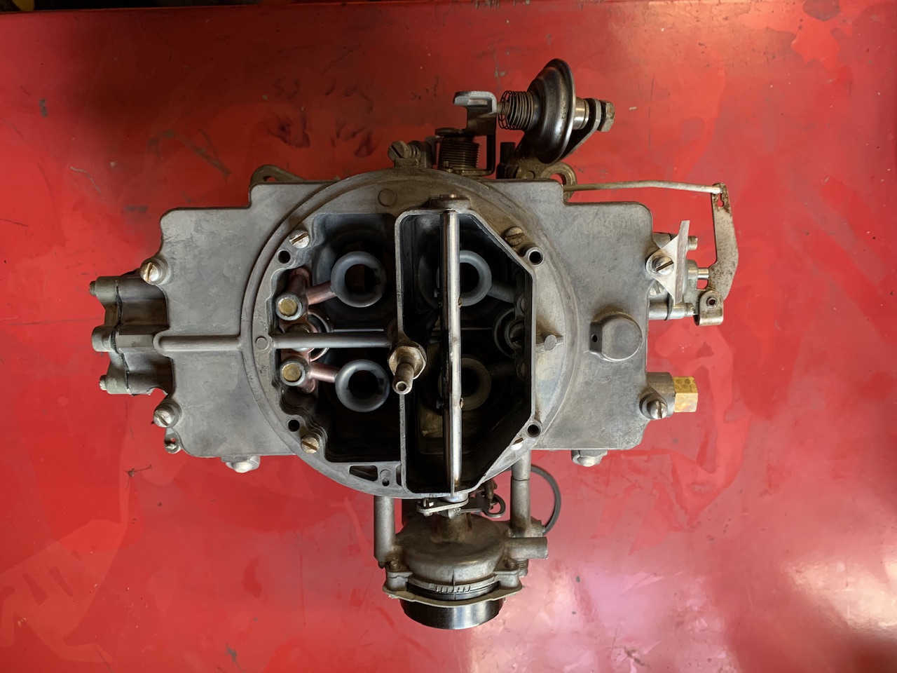

    It’s got a dual exhaust on at the mo so that’s covered although it’s welded to the existing down pipe. For cost I want to keep the existing exhaust manifolds but am worried about taking them off one is definitely leaking so there isn’t a choice, but the bolts in the head look tricky!
    I’ve got a 4100 off a Thunderbird, bit of a bargain hopefully, odd description on eBay so got it for less than the gasket set for it cost me. Rebuilt it this week so was thinking of going to a similar spec cam to the T-bird if I’ve got the engine out wasnt thinking of anything nutty. Run an additive for break in and then VR1 like the race cars. With a 3.0:1 rear end it’s going to need some low down grunt.
    I guess I always think 15” are better. There’s more choice in 15” tyres but perhaps 14” with a bigger white wall would be good too.
  11. That is a fantastic carburetor, pretty much exactly what I had in mind. Great score!

    Nice car. Kinda makes you want to go out and buy a moredoor. Question about your carb. It looks like the lever and link to the rear barrels are missing. Also the pivot for the lever that operates the rear barrels looks like it's been drilled out. Not a total loss though. They used to make an aftermarket part that you installed on the rear barrel linkage that eliminated the function of the vacuum actuator at the rear of the carb. Essentially made it a mechanically operated secondary. Don't know if they are still available but you can ck it out. Last one I had to make myself. Maybe it's just the way you took the Pic or you just haven't installed it yet but I don't see them.

    Thanks, it’s all there it’s just the angle of the pic and I think the pivot is shiny so it looks like a hole.

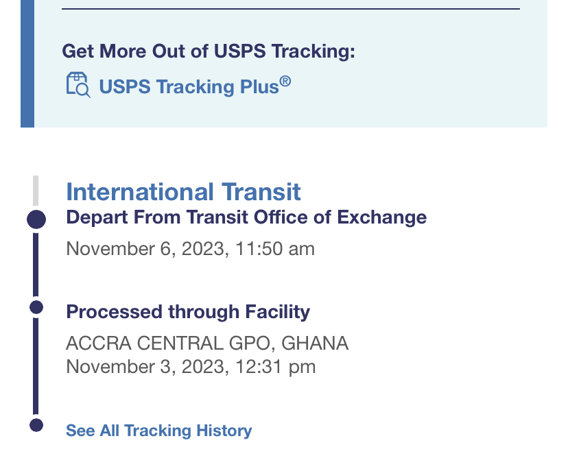

    Well the parcel isn’t lost, it’s in Ghana!
