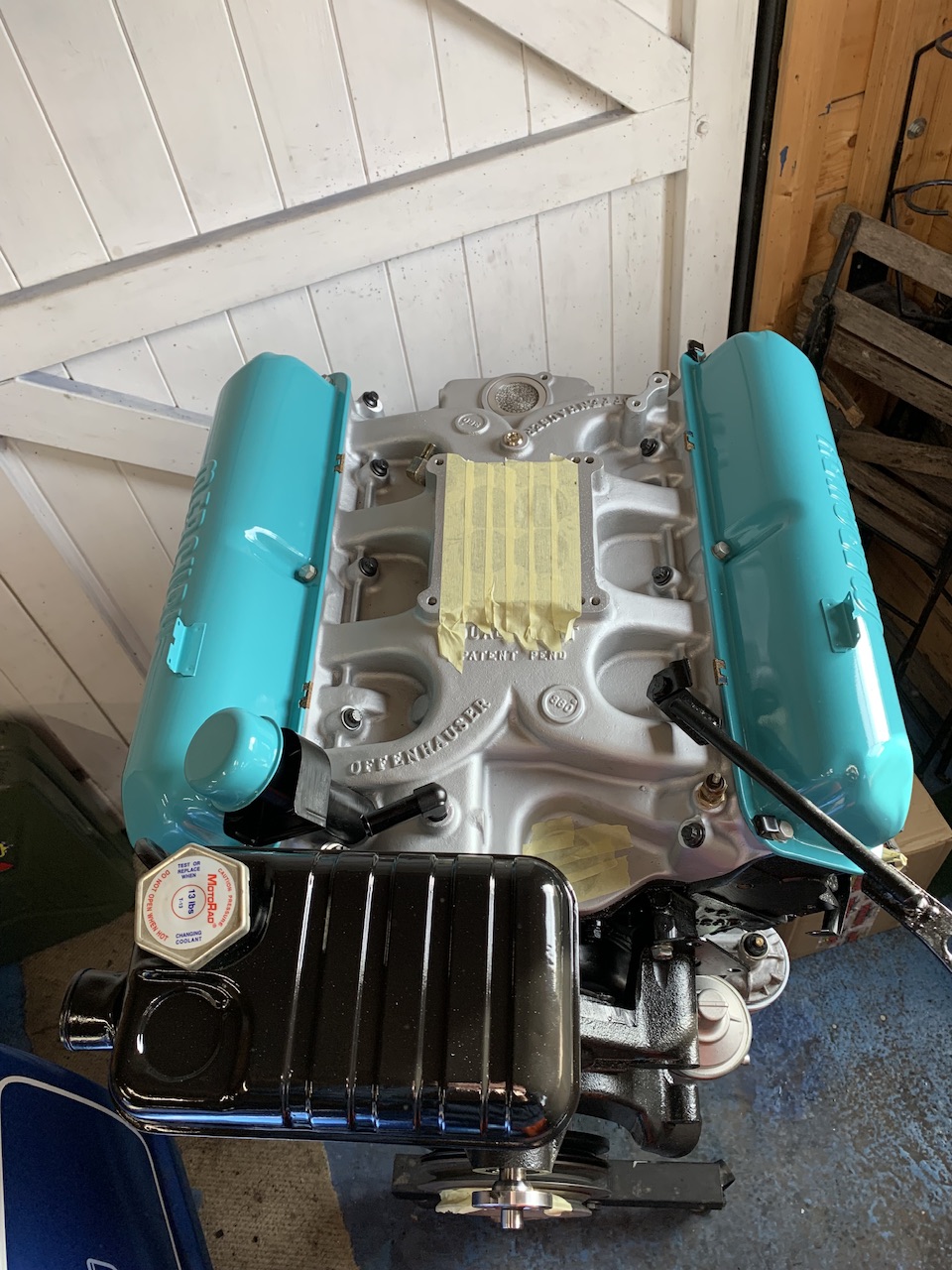

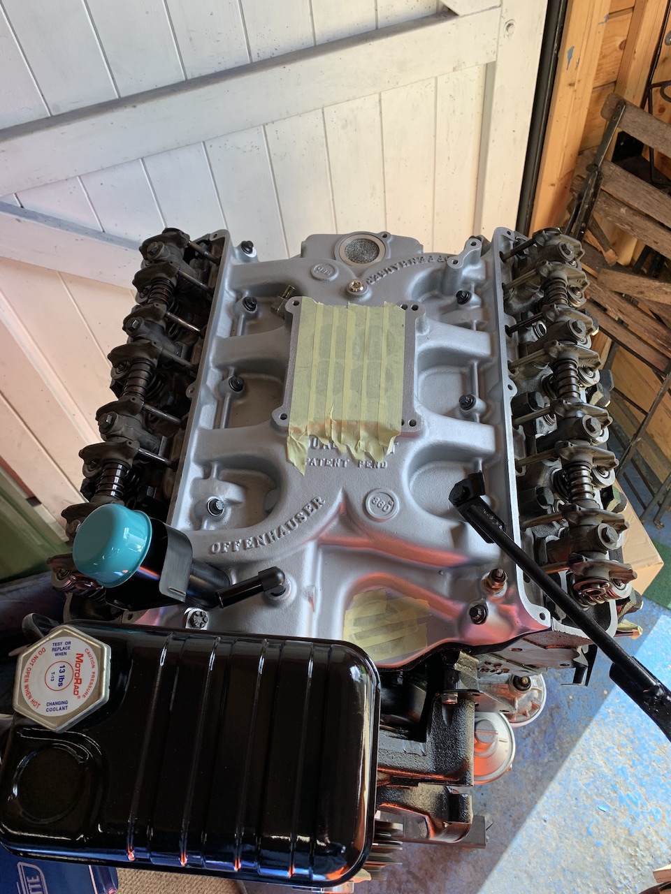

    Valve gear all in, couldn’t get the drip rails in with this intake so had to leave them out
    Exhaust manifold on too

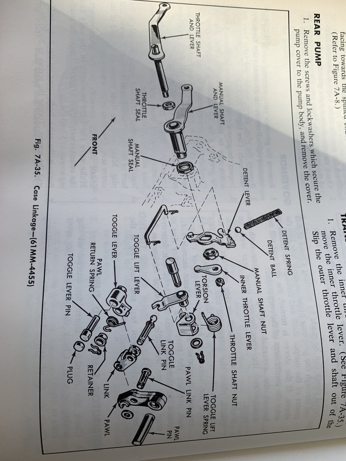

    Have you ever changed the shifter seal on a Ford-o-matic?

    Yes i have change shifter seal on a multi-drive transmission.need advice? Picture of dissambled one or something? No problem.

    Just wondering if there’s anything tricky, I’ve got the factory workshop book, the new seal I’ve got for the throttle shaft is an o ring but the pic in the book looks a bit more substantial

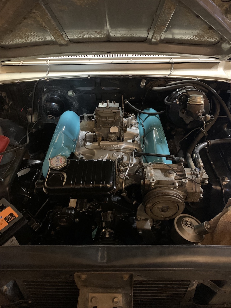

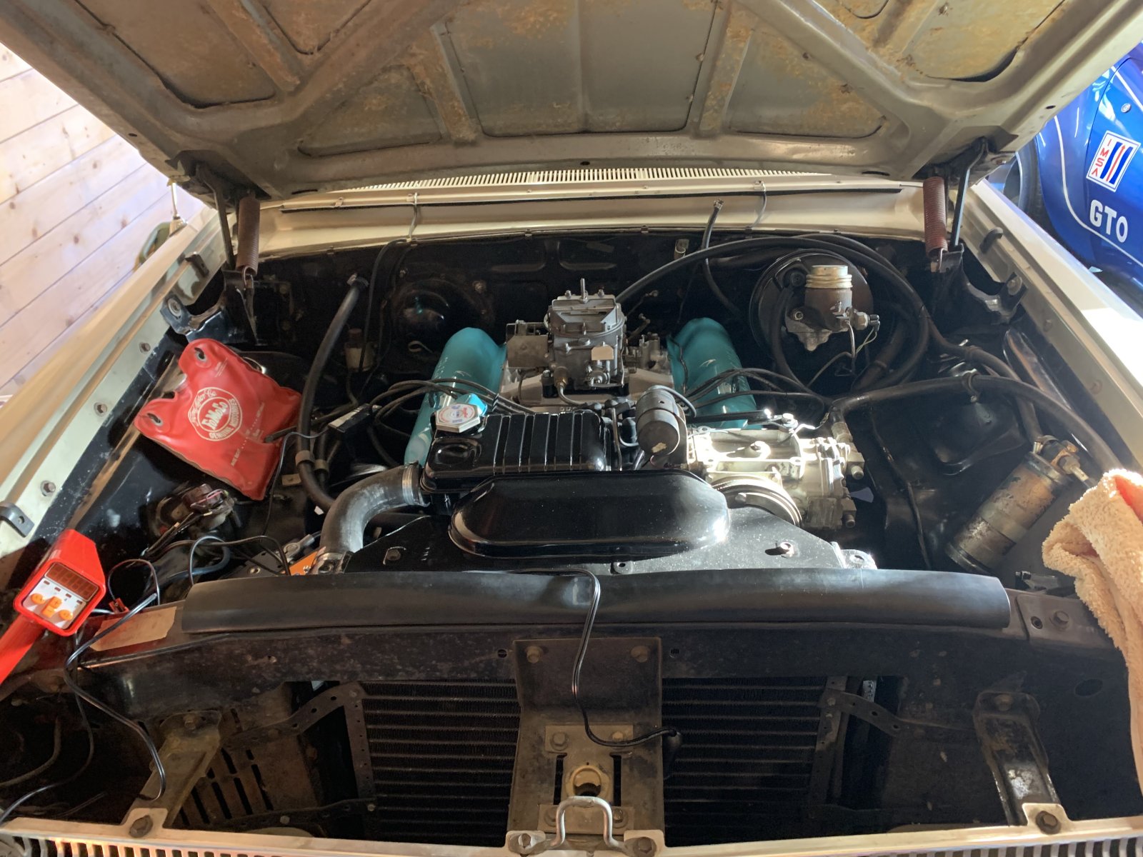

    Most people go for the HiPo gold but I thought that might not look right on a gold car. The original colour was bluey green so I went to paint shop a picked a colour I liked. It pops even more in real life.
    Need to do an air cleaner too. I tried the carb and air cleaner last night. It’s really close to the hood so need to find some plasticine or something for a proper check.

  15. J. A. Miller
    Joined: Dec 30, 2010
    Posts: 2,065
    J. A. Miller
    from Central NY
    A loosely balled piece of aluminum foil works well for checking clearances on things like that.
    I enjoy watching the progress you are making on this Mercury.

    For The kickdoewn shaft seal, its doable under the car but shift shaft seal....well, never donit under the car.detent spring and ball might be mission impossible to keep in their bore during installation.

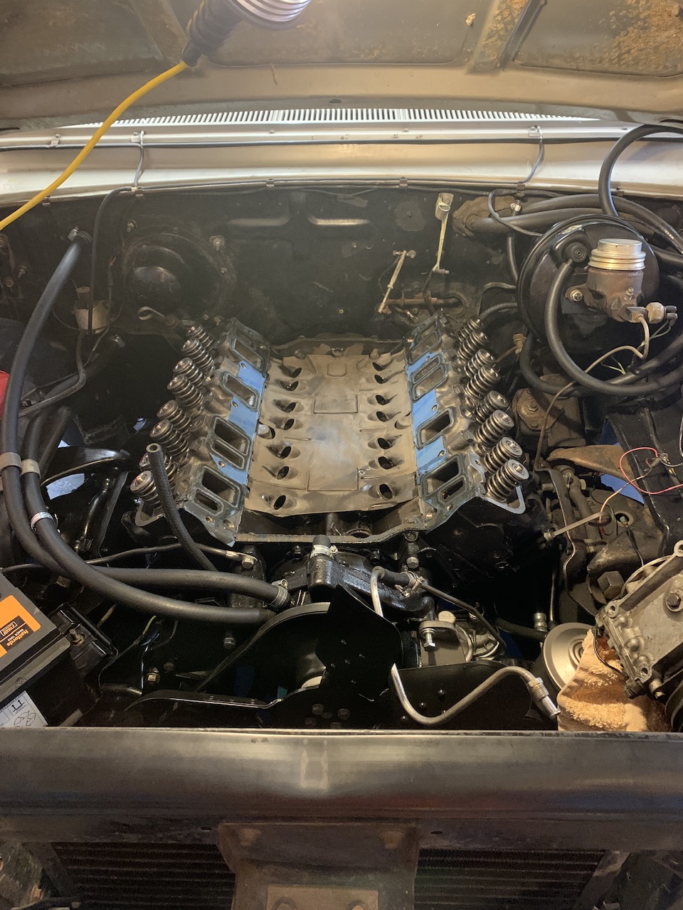

    Don’t you hate being right. I knew the surface finish on the heads wasn’t acceptable, they’re pissing water out without even being run. FFS!

  26. Is it leaking between the head and the block or from around the exhaust manifold bolt? Are the manifold bolt holes blind or do they go into a coolant passage in the head?
  27. Oneball
    Joined: Jul 30, 2023
    Posts: 730
    Oneball
    Head and block, the bolts are blind. It’s clearer where it’s leaking from in person. The other side is leaking in more than one place. I’ve drained the block so hopefully it’s not filled the bores up. Have got the day off work tomorrow so will try and pull the head. I’m a little worried I might not be able to pick them up over the fender, since my accident my left arm isn’t very strong.
