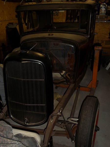

    So fast forward 50 years and I have just been hankering to build me another Olds engine. Picked up a 54 324 and had Dave50 rebuild it for me, then picked up a project from another member on the forum which consisted a 32 frame, 4 inch drop axle, 9 inch rear etc. Body is in fair shape with fairly good front sub rails. The OB had done a bunch of work on it to get it to be a roller. I have been looking at it for about two years now and have decided to get with the program before I run out of time or something like that.
    The Olds has a Ross cam and 4 97's mated to a 37 Lasalle. To date I have the engine in the frame and need to change a few things as the OB had set up the drive train for a cookie cutter SBC and T350. Not happy with the cross member or the rear set up either so all of that is being changed. Plan is to redo the X member to allow a set of 39 pedals to be used and a A cross member out back with an A spring to fix the interference with rear and the current cross member. Lots to do but all I have now is time so we are working at it slowly.
    This past week we cut out the firewall as it was trashed pretty bad and was to close to the Olds. Fabbed up a new cold rolled replacement and have that fitted now. Then onto the X member and the fitment of the new pedal assmb. Will work my way back to the rear.
    The drivers B pillar has dropped about 3/4 of in inch which has to fixed along with the sub rails so I will update this as the weather allows. It is 7 degrees here today so not much will be happening in the garage for a few days.
    Surely will look forward to input as I have never built a 31 before. Always stayed with the fat fender cars prior to this. Here are a few pics of what is going on to date.

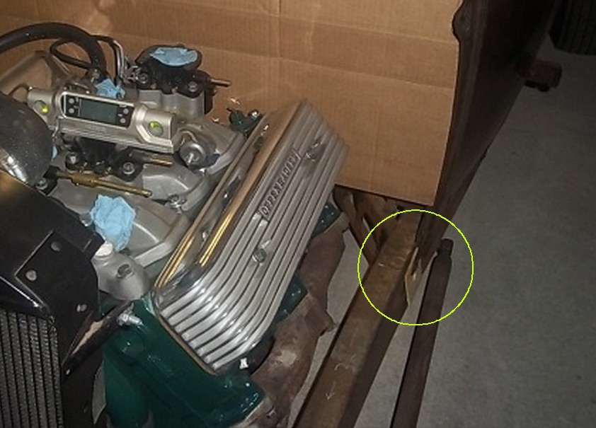

  4. 101_4216.JPG Here is a pic of the firewall "post operation".
    These rails are not pinched so now I can spread the lower panels to fit over the rails. Got a sheet of 18 ga cold rolled and made a pattern with card board which I have transferred to the steel. Cut it out last night and did a lot of fitting to get it to fit tight. Will weld it from behind as soon as I get the distributor recess done.
    The body sets to high in the rear and I wanted to C notch the frame so I am going to put an A cross member in with a new spring. If you look close at this pic you can see where the rear end housing would have come up and hit the spring and cross member. Gotta fix that.

    Something to keep in mind. As you lower that cowl the radiator and shell will need to be lowered as well to compensate in addition to the up-swept '32 rails. That nice Walker rad that came with the project most likely is too tall. Also, sometimes, the A bodies end up angled slightly forward to get that cowl down. This makes the radiator even shorter.
    It's unwise to order a radiator on a non-stock body frame combo or high boy until the grill shell height is established. Get the body together on the frame where it will be permanently located, prop the grill shell up where it should be, grab some masking tape and make a hood line from cowl to rad shell. Trim and drop grill shell and repeat as many times as takes to look like the proper slope following the cowl tops slope.
    Then measure and buy your radiator. Good luck with your project.
