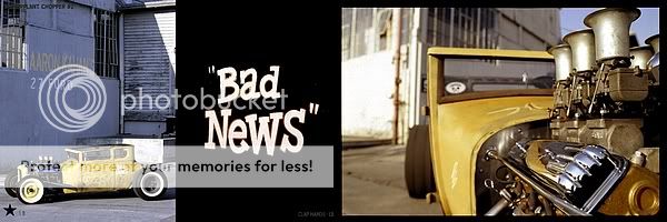

    I got a few PM's and E-mails, like I said it's been a few years and I haven't seen the show in awhile, although I do see the car alot.
    Yes, we are lucky to all live near each other and be friends that are into the same type of things, couldn't ask for a better situation!
    For the most part we built "BAD NEWS" the way Aaron envisioned it. Aaron has as keen an eye as there is, as to what a hot rod should look like.
    Here's hoping I get all this right...
    We chopped the roof 10 inches.
    We raised the cowl, cutting and lifting the top half straight up into the windshield while leaving the bottom half in the stock position. Then filled horizontal gap between the top and bottom of the cowl and finished it off with an aluminum firewall.
    It really was a $30 dollar A frame, when your always looking, for years, you come across stuff. (I'd like to find a few at that price these days!)
    The rearend is a 50 Merc that Aaron went and pulled out of a Mercury at Gene Winfield's place.
    Everyone in the club contributed parts or helped out. Deron had the American Mags, I had the slicks, Deron the intake I think, me the scoops. Aaron had the most stuff luckily for him, so he gets to keep the car. ha...

    I see in the later pics it had a windshield visor added, what is it off of?
  15. Verne
    Joined: May 15, 2009
    Posts: 82
    Verne
    from Burbank
    The visor was added soon after the show was finished, it's actually a chopped down and narrowed Model A visor.

    Does anybody know how much it was chopped?
  24. fattoy
    Joined: Aug 7, 2013
    Posts: 36
    fattoy
    Hey all. Haven't read all of this thread but am very keen to get hold of the rides program with the bad news T. I have never seen it and love this car. As far as I know it never aired here in New Zealand. Does anyone have a copy they could send me? Please, please, please
  25. Koz
    Joined: May 5, 2008
    Posts: 2,713
    Koz
    Several of the Burbank Choppers are on this Forum. I'm sure one of them will post up.
  26. Aaron Kahan
    Joined: Apr 29, 2011
    Posts: 123
    Aaron Kahan
    Thanks for the interest! My T is chopped 10" ... Leaving the side windows 8" high.
    -Aaron
