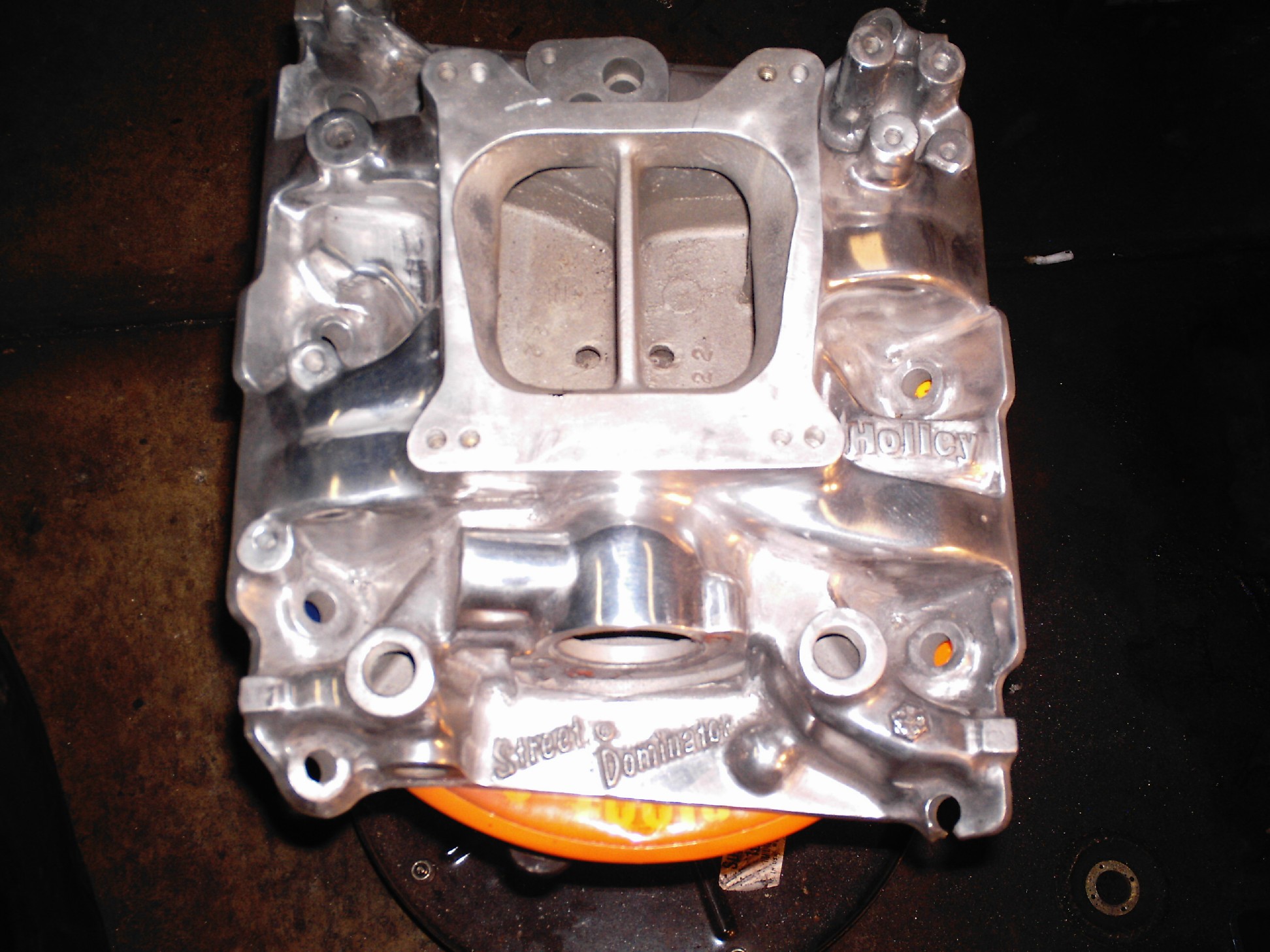

    Well I bought this manifold from Topolino Kid and was now seeking a carby solution to get the best all round performance out of my engine, any deals out there???
    This is a great alternative thread for V6 guys, glad you started it Kojack.
