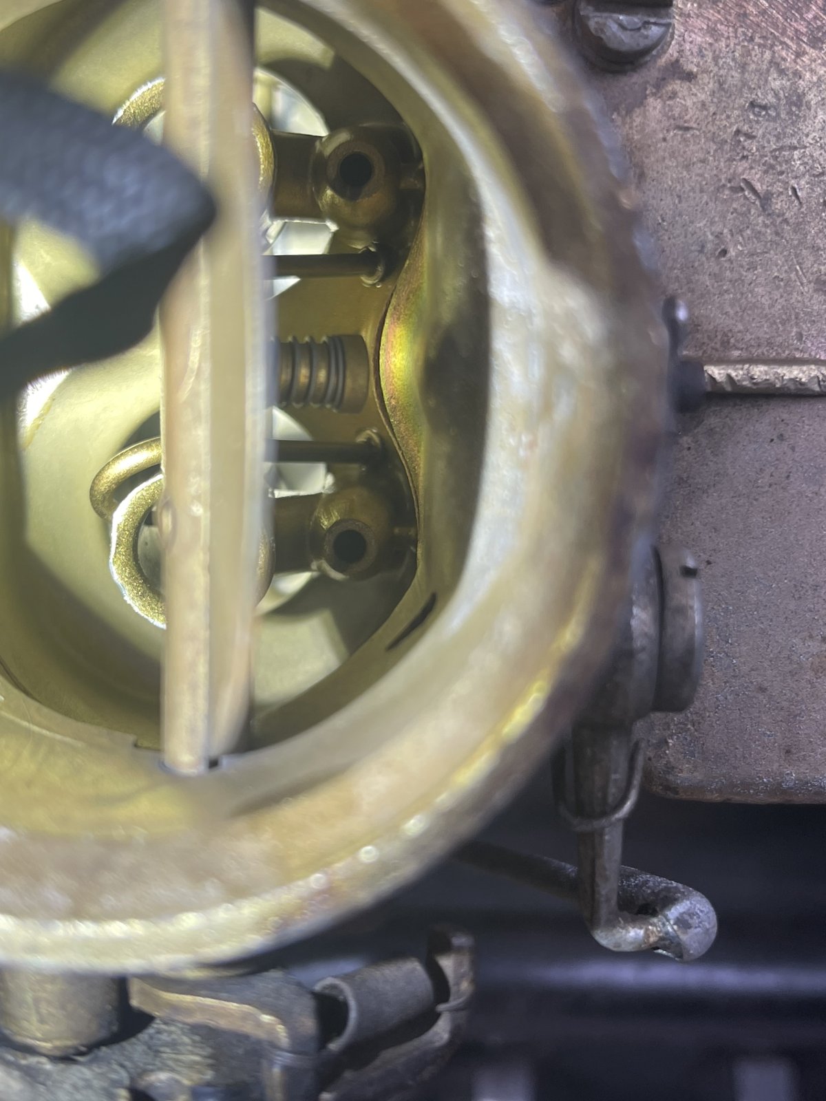

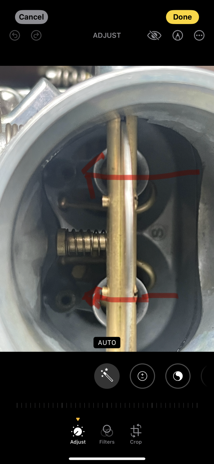

    I think after trying to drive it today i can clarify for sure . It will go into all the gears now without any issue on the column .. It is wanting to die when leaving from a dead stop in first , even when I tried to go in reverse it wanted to die. . The rare times it can stumble through first long enough to get to the other gears those run rough too like the car is bogged down . It’s got new gas tank /fuel pump/ fuel lines / new stromberg 97 all new wiring , new plugs /plug wires /crab distributor . This afternoon I decided to pull the air cleaner and try and look in the carb see if I noticed anything . I don’t know how long the gas in the car has been in there , I just recently bought the car . First pic is the inside of the stromberg 97 on my other car I daily drive . Second pic is inside of the stromberg 97 on car I just got. You can see those same holes on the carb are all gunked up to the point it has made the size of those openings a good bit smaller . Maybe it is gunk from today’s crappy fuel sitting in it ? I really don’t know .Thoughts ?

    Are you comfortable taking the carburetor apart and cleaning it properly? I can’t tell on my phone, but if you see crud in it, I’d start there.

    Yeah sorry I tried using a flashlight to get pics but it was just not getting good light . There’s for sure visible crud in there . My buddy is a mechanic who rebuilds carbs regularly, so he can give me a hand and make sure I do it right .

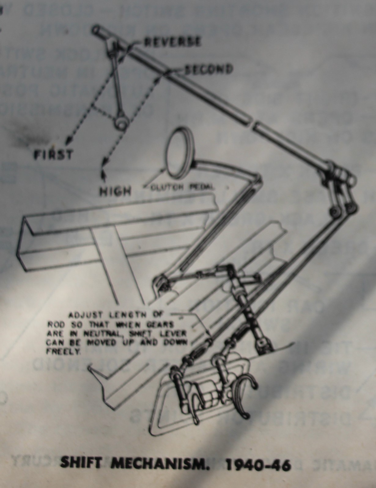

    This is what my 1946 Motor manual has on adjusting the shift linkage. You might want to save it for later. IMG_2218.JPG

    My thought is that you found the problem and know what is needed to fix it now.
    I would install a good quality inline filter between the tank and the fuel pump if it doesn't have one. and if it has one I'd change it. I've had more trouble from dirty gas and crud breaking loose from inside the tanks and plugging things up in rigs that sat for a while than the law allows.

    Parked down in Tucson even inside and in low humidity, I’ve had this crappy gas go bad in a little as 4 months. My generator at home in Seattle quit idling, and its carb looked just like yours. Ethanal fuel dissolved the rubber fuel hose and plugged the idle jet.
    Clean the carb, check any rubber line in the system (as in replace with ethanol rated hose) and get the old gas out. Then at least you’ll know where you’re at.

    Thank you !! I will save that pic/info and have my buddy help with adjustment to make sure it is properly dialed in
