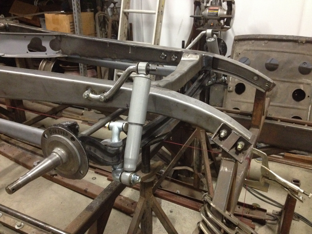

    Alittle chassis update, got the rear ladder bars set up in and whipped out some taper bushings to make some frame mounts for the split bones, made a front tie rod and got the front end together and set up ImageUploadedByH.A.M.B.1421690592.921211.jpg ImageUploadedByH.A.M.B.1421690612.744837.jpg

    Working on getting the front end finished so it can come out of the jig, machined up some threaded bushings for the front shock mounts and got them fitted, gotta get these finished welded in and then onto the c notch on front and rear

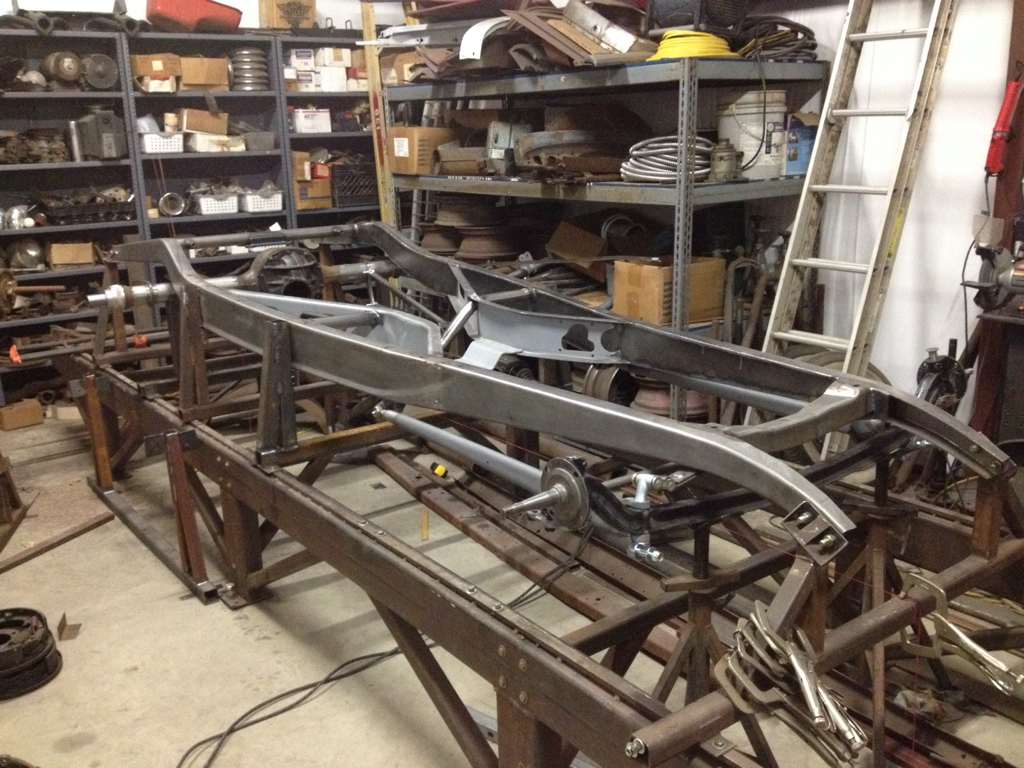

    Here's some progress, got the frame tidied up , rear c notch done, rear frame rounded, and front notch done, and out of the frame jig ImageUploadedByH.A.M.B.1424189306.307743.jpg
    Next up was to get it back assembled on the ground
    Whipped up some lower rear shocks mounts
    Had to set the mock up motor and tranny in place ImageUploadedByH.A.M.B.1424189516.970422.jpg
