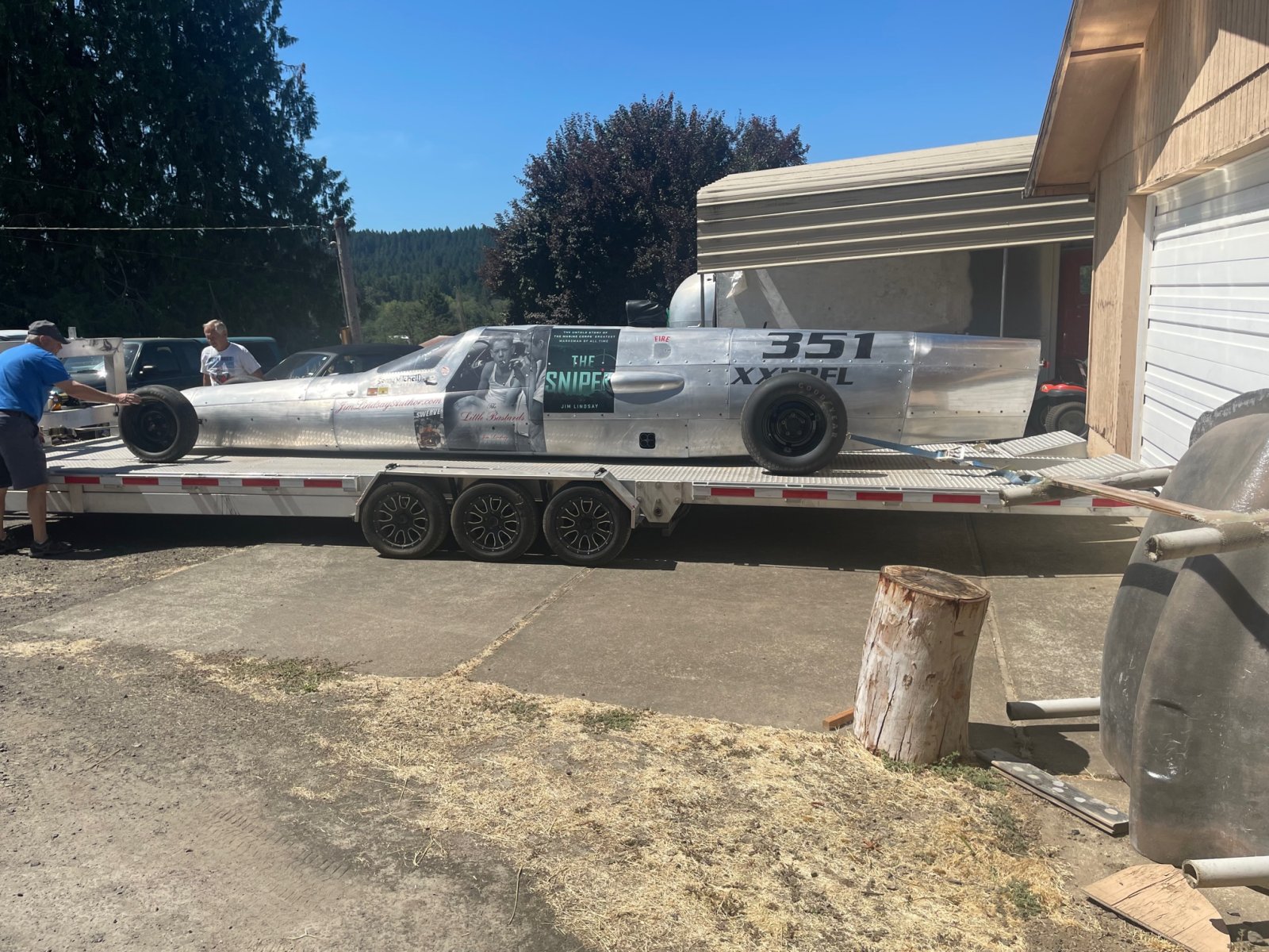

  11. Marty Strode
    Joined: Apr 28, 2011
    Posts: 8,948
    Marty Strode
    I have used Dzus fasteners for 50 years on race cars. I have grown fond of the Allen head, dome style, and use a T-handle wrench. The lakester has in excess of 300 buttons. IMG_0201.jpg IMG_0202.jpg IMG_3540.jpg

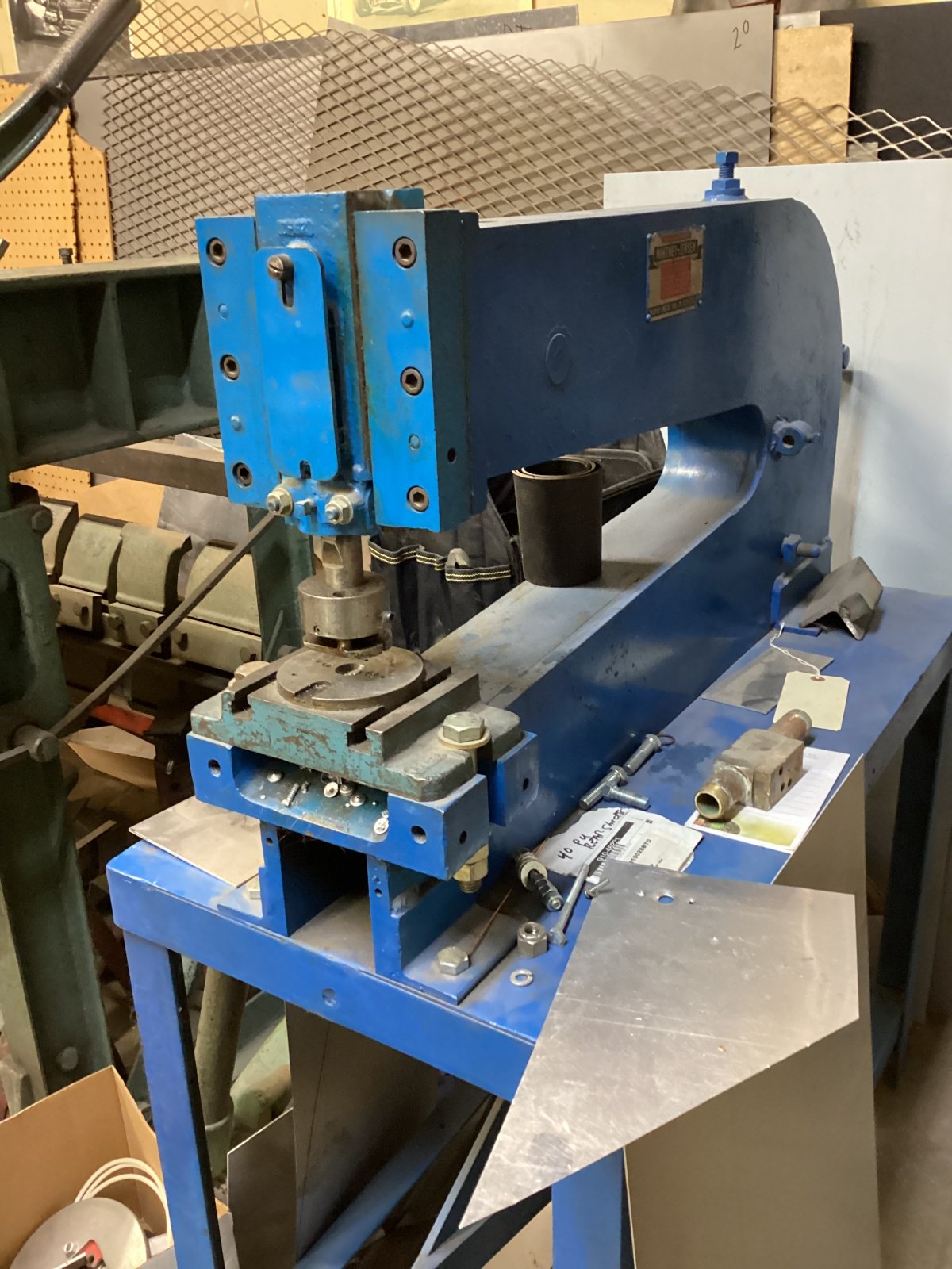

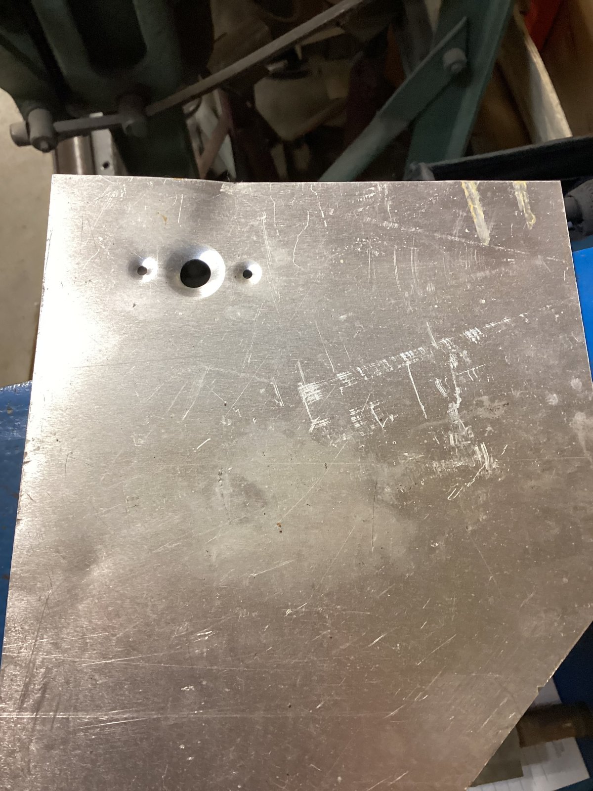

  13. Marty Strode
    Posts: 8,948
    Marty Strode
    I have this kick punch, that does all three holes and dimples in one strike. IMG_0203.jpg IMG_0204.jpg
    dana barlow, bymanr, warbird1 and 9 others like this.

  30. Marty Strode
    Posts: 8,948
    Marty Strode
    A buddy of mine Jerry Hill, had a race car fab shop for years, built Dragsters and Funny Cars. It was in his estate, and that's how I acquired the Whitney Jenson punch, with the die in place. Makes it fast when doing multiples.
