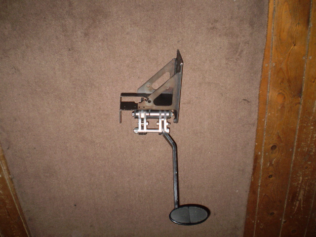

    little progress this week.got some brackets laser cut and drilled the pedal.assembled it.no welds so i can adjust pedal on the pedal still brake linkage 001.JPG brake linkage 002.JPG

    heated th tyres 008.JPG e pedal and gave it a small tweak.sits comfortable now ,it feelsin the correct place.paint is next on the agenda the trottle pedal is adjustable mount to help locate the optimum position

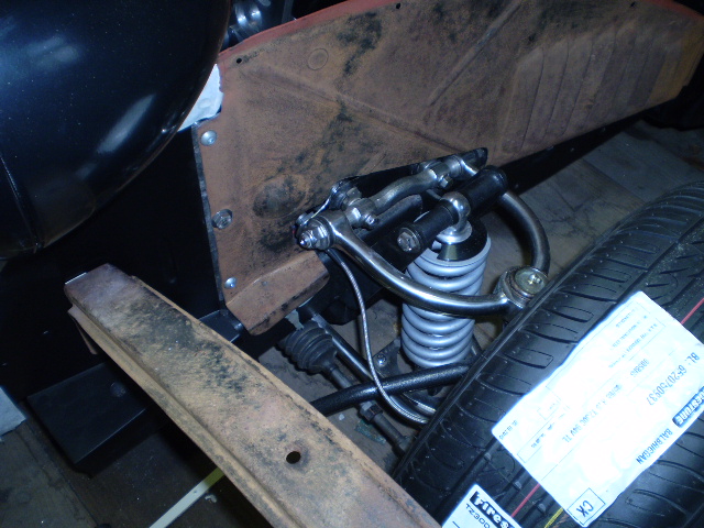

    with 205 /65 on the front ive 1 3/4 inch clearance between edge of tyre and edge of fender.
    3mm rubber strip.think ill cut a s/s strip to support the rubber instead of current stainless washers
    when I offered up the running boards for the first time I loved them.they need a little massage but they will be great real solid with surface rust underneath.POR 15 should preserve them
    considering its 78 years old this year its in great condition.had it spent its working life here its unlikely to have survived the damp winter weather.

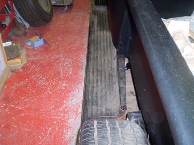

    this morning I started straightening out the drivers side running board its getting there.i had enough of that after a few hours. so collect the fender supports from blasting.SODABLAST did a nice job.should be painting them tomorrow

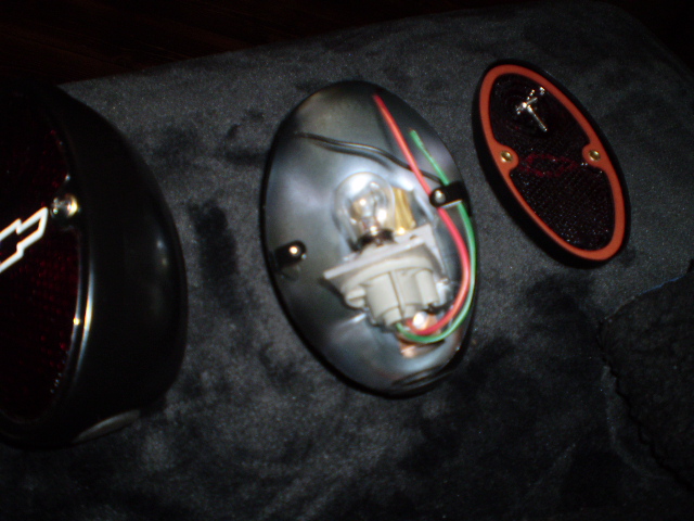

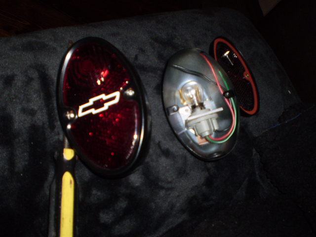

    mgtstumpy and 32SEDAN like this.

    my good friend mick modified the lights this evening,did a great job.some stainless screws and a lick of a file and the jobs wrapped up taillights almost done 001.JPG taillights almost done 002.JPG
