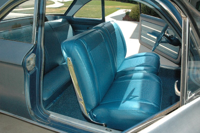

  10. I would keep an eye out for 'Vair seats, I always thought that they were perfect in a rod. if you want stylish I would looks for '65 and newer 'Vairs, but in a beater the early 'Vairs have the perfect silhouette.
    If you have to buy the whole damned car I would drool over the rear springs.LOL
    here are the early seats:
    And here are the '65 and later seats
  11. Beano,man those look great. HRP
  12. I thought about the 'Vair buckets, but I'm pretty the early ones are too wide for a Deuce. I like the later ones though!!
    mnjeff and HOTRODPRIMER like this.
  13. I have ridden and driven both and while the late model seats are sleek the early seats are really comfy. If you know where there is a vair wasting away that would be the real deal in a hot rod.

  15. My mom had a 65 Corvair so I know the seats are comfortable but they are a little wide.
    I know have a bench seat in the beater,just looking for something a little more comfortable for long trips,after about 4 /5 hours the old bench seat starts feeling like a park bench.:D HRP

    The Corvair buckets are really great looking, the early ones share a frame with Impala, Grand Prix and Nova SS although the big cars got a chrome band over the top, they are otherwise the same. 65-66 Corvairs got the same seats as the 64-65 A-body GM cars, which look similar but are a bit narrower, might be helpful in an early sedan. Even the 4 door Monza model Corvairs got buckets and they fold too, I got a pair out of a '66 4 door for my '65 Tempest and they'll take the factory Pontiac covers like a GTO or LeMans. That interchange also helps if you want to pick out a pre-made reproduction seat upholstery kit, lots of options. I don't think the plastic backed seats as shown above came out until '67 or '68. For a 60's look though, I'm fully on board with the Corvair buckets.

    I have been looking at Corvair seats for my fake Gasser. The early ones folded straight forward, 64 or so they folded towards the middle. Later ones had locking backs with some years latches on the side and some on the back .
