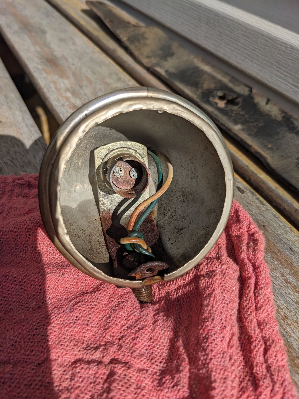

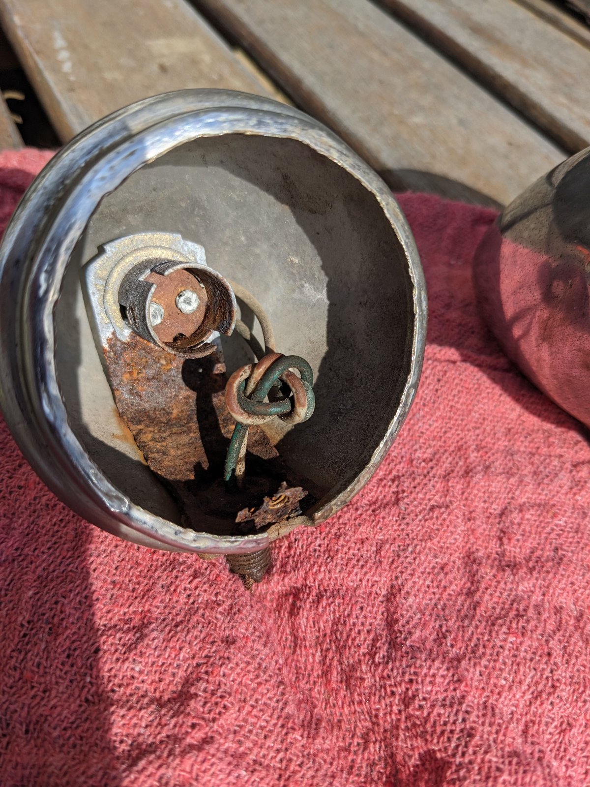

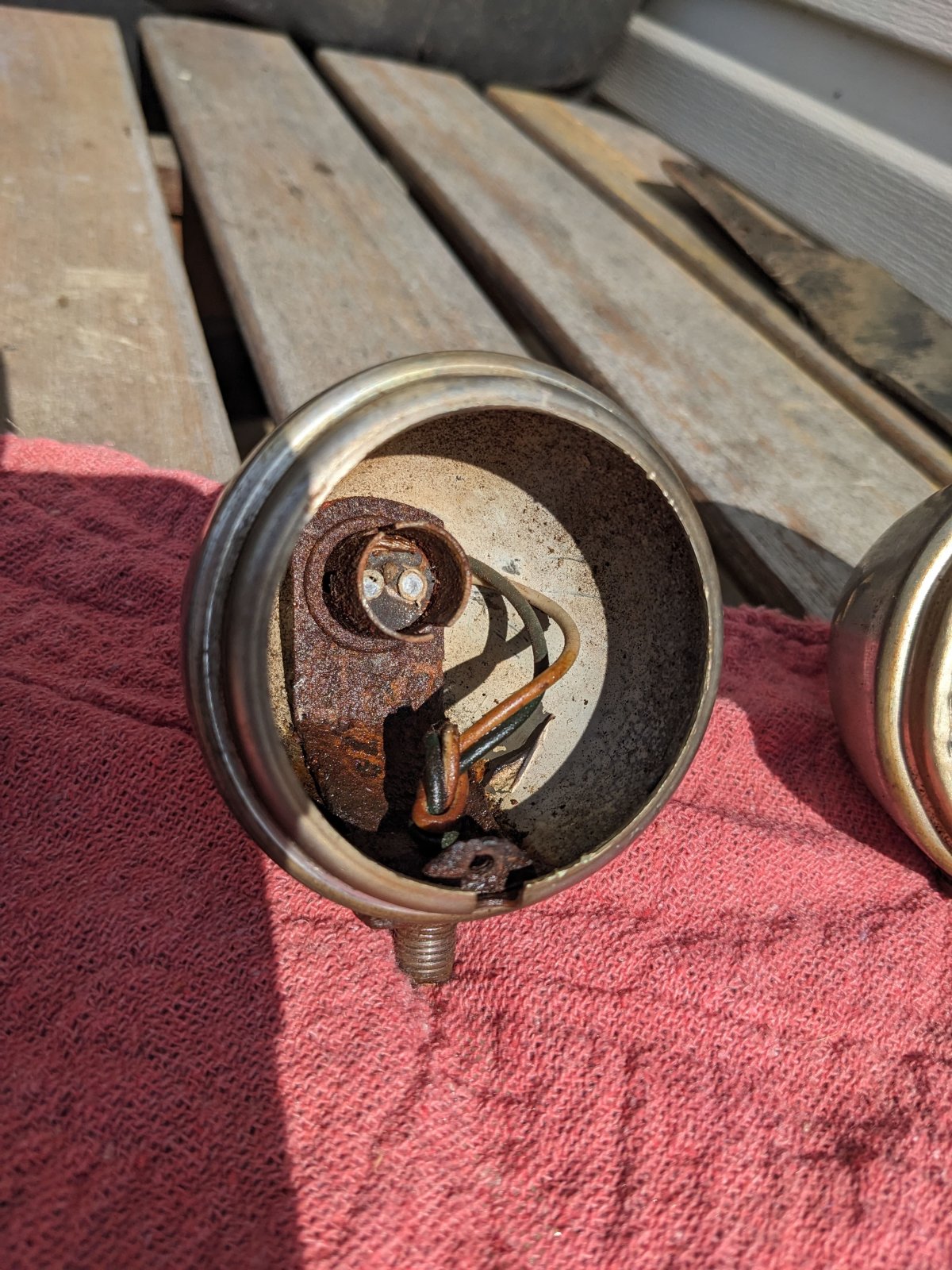

    Picked up 3 Guide B-31 lights this weekend at GOODGUYS Raleigh and want to use them for front turn signals on my 34 pickem up.
    How do I remove and replace bulb socket and wires? They are a bit crusty. Maybe even replace with led?

    I’m jealous, I’ve got them as turn/park lights on my 38 Chevy and my units looked about like yours. I taped of the exterior, after cutting the wires to get the remnants of the wiring , I then sandblasted the interior of the light, polished the interior of the socket, installed new wires and was done. Good choice, I would like to of had another pair for the T Roadster but couldn’t find any
  4. Help parts at auto store. The cards and ends are available. Push ends out clean paint and drop new ends in place.

    I see…by “card” you mean the round part with 2 contacts on them. I can replace with new like so. Once I find right size and remove card and put in my light.

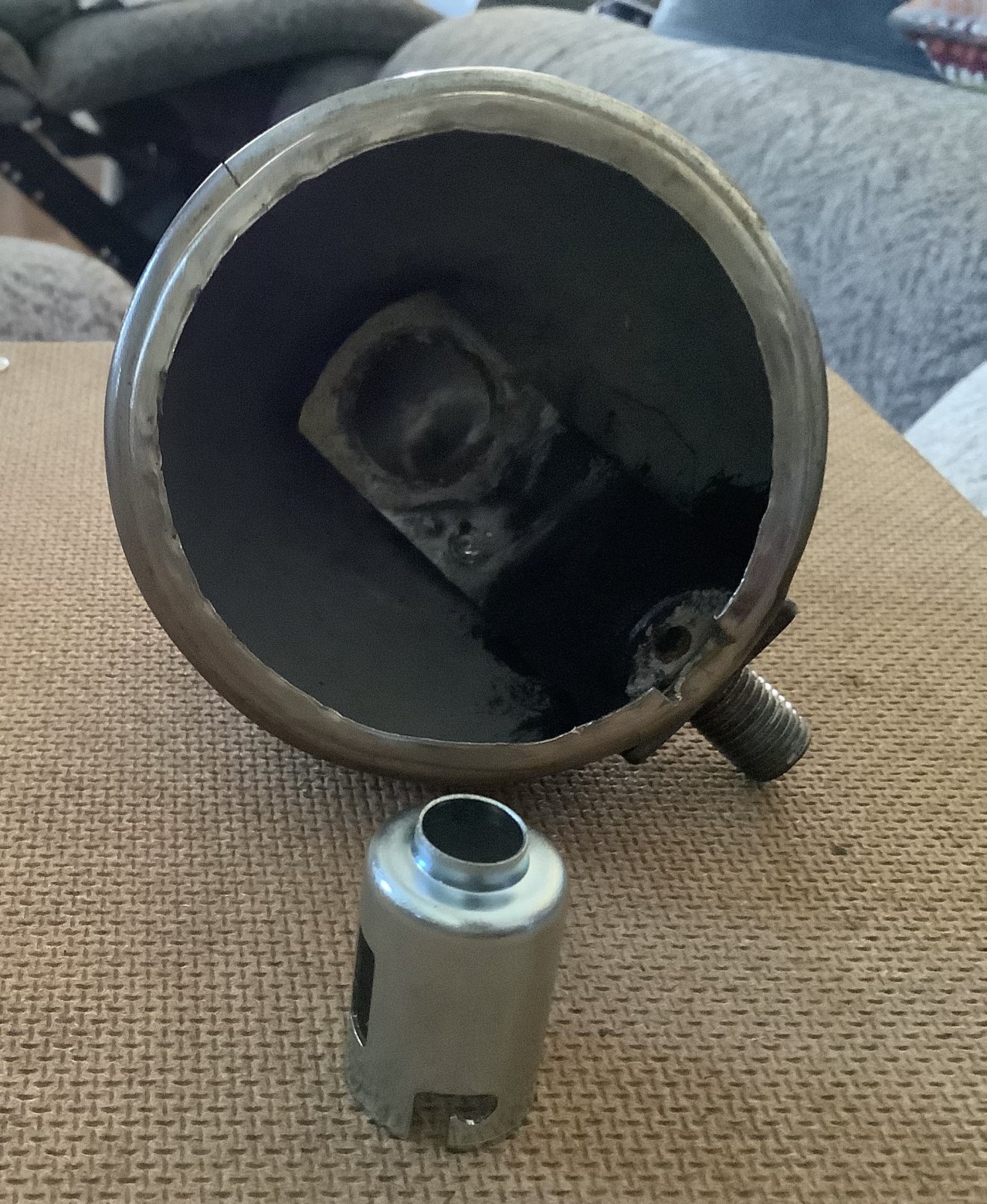

    bought new cards from Napa, installed them with new bulbs but because the flange the socket is in is so rusted I have no ground suitable enough to provide power to the light when I attach a ground wire to the threaded housing mount stud. Only way I can get light to work is touch ground wire directly to outside of socket housing. I then attempted to add a ground wire but in the process of trying to drill a tiny hole in socket support tab, bit broke and I crushed bulb socket so I removed it.
    so now I am left with the dilemma on how to attach new bulb socket and good ground?
    IMG_0824.jpeg JB weld? How do I ground it?

  10. Couple of small tack welds. That'll damage the OEM plating some but won't affect functionality.
    tarheelrodr likes this.

    I took on a project like this a few months ago - this is what I found out - first the bolt that holds the brackets in place is crimped on the outside on the square shoulder of the stove bolt to hold the body mounting bracket and inside bracket holding the light socket - after trying to remove the stud - I finally wound up grinding off the head of the bolt very carefully - found the B-31 body had square hole for the square sholder of the bolt to lock it in place - found a double socket from Snyders with a flat base that bolted to the inside bracket - found some good 2 -wire electric cord from my local hardware store and with some tweeking got everything back together
    vtx1800, 302GMC and tarheelrodr like this.

    Well I was able to get the brackets, bolts and sockets removed from the housings and blasted to bare metal. Put them back together with new cards and bulbs and they work great..!! Thanks for all the help.
