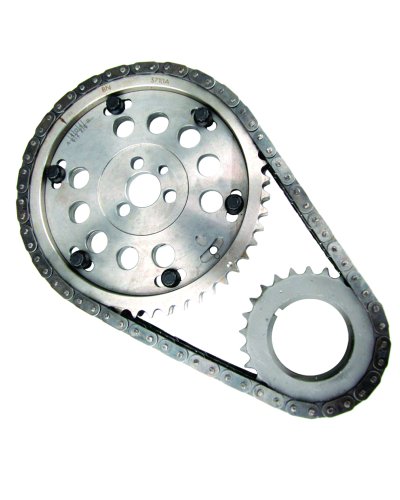

    I thought it could be done through the timing chain set up. Advancing or retarding cam timing like the Cloyes Hex-adjust.

    Add SAYS revolutionary new cam, intake-n- exhaust in 5 min, but things that are adjustable are ---> well here see pictures.
