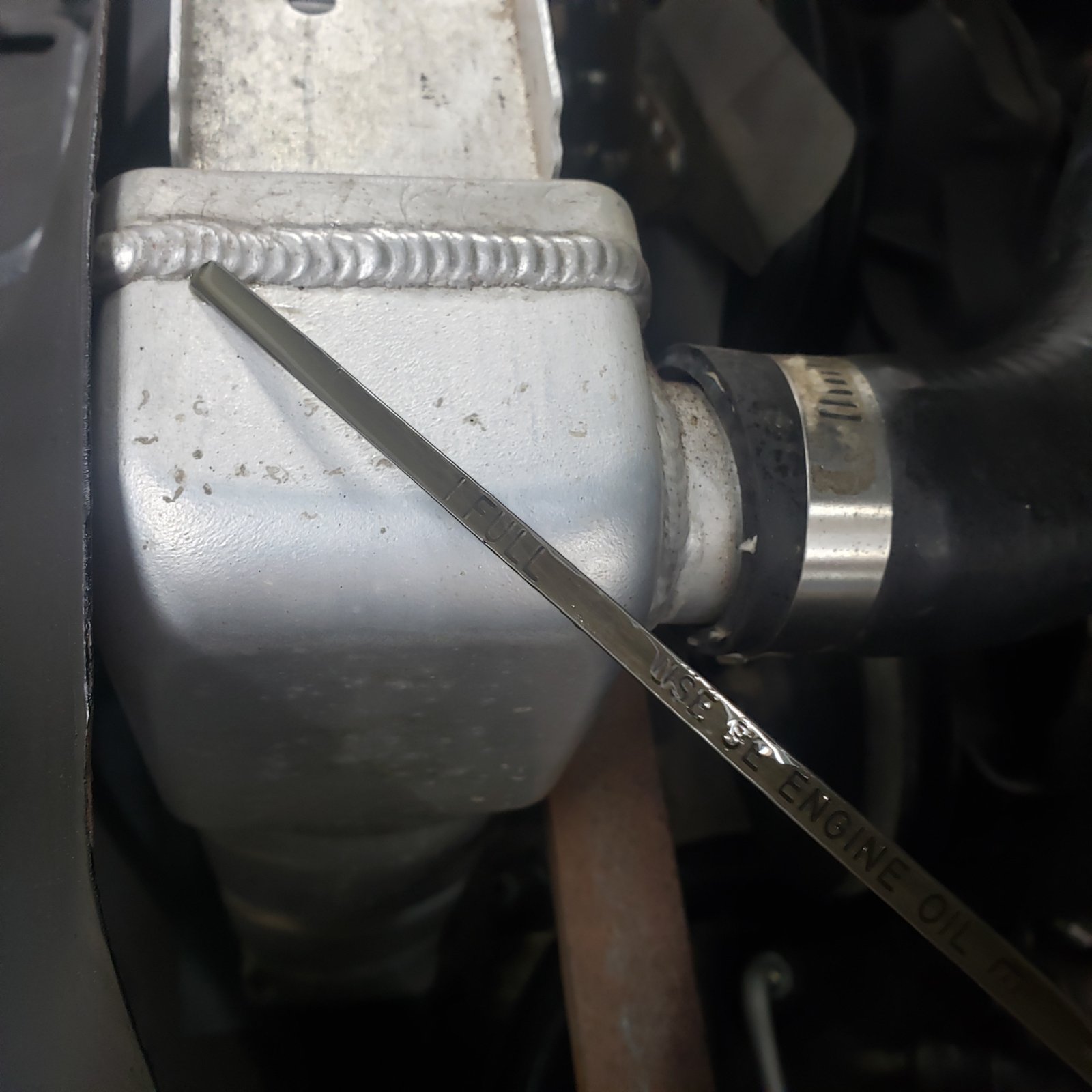

  1. So do you guys ever get tired of old cars?? Set the timing this morning, figured I'd check fluids before I backed it out. 20240409_110725.jpg 20240409_110748.jpg

  12. Well, the trans cooler is separate, and the oil in the engine is clean and full. No clue what it is/was. I flushed the cooling system probably 5 times. Did a pressure test and it held 17lbs for a while, got tired of standing there. Drove the truck up and down the road, and everything looks pretty good. Wish I could say what it was, but I can't. Unless the block is cracked, but then again, the oil in the pan is full and clean. So there you go! :confused:

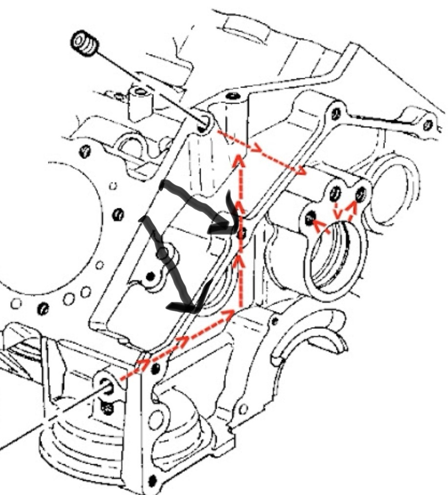

  14. Johnny Gee
    Joined: Dec 3, 2009
    Posts: 12,706
    Johnny Gee
    from Downey, Ca

  16. That's about the only thing it could be right? But the oil level is dead on full and clear. No water in the oil, no oil missing. The bottom radiator hose was off of it all fall and winter. I'm gonna run it and see if it comes back. Like I said, it pressure tested good on the coolant side.

  20. Since the oil is in the radiator and the engine oil is clean, oil pressure is higher than coolant pressure. Other than some kind of goofy internal crack, I cannot think of where oil and coolant would meet on a Small Block. If it were a diesel, I would say the engine oil cooler is cracked, but, it ain’t a diesel. You also mentioned the transmission cooler is separate from the radiator, so that rules that out. There is no pressurized oil in a small block cylinder head, so even a cracked head would not cause this. Sorry for the long winded post, I was thinking out loud. Some goofy internal crack is all I can think of. Please keep us updated. Was the radiator ever used on something else?
