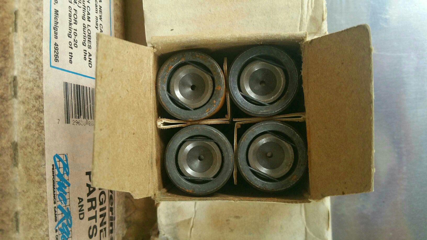

  4. HAMBsterLady
    Joined: Aug 24, 2009
    Posts: 91
    HAMBsterLady
    You were right about the lifters. HL2011 lifters Mopar 1968-1992. Brand: Elgin

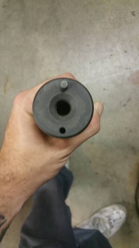

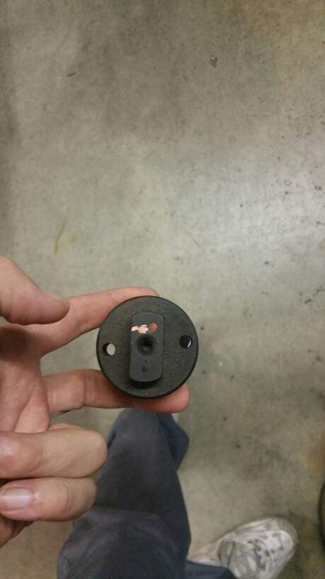

  9. Old6rodder
    Joined: Jun 20, 2006
    Posts: 2,546
    Old6rodder
    from SoCal
    1. HA/GR owners group
    Everything's in correct position for a slant 6 cam (though I'm not familiar with that rectangular lug on the back). If it's the same vintage as the lifters, then that's most likely, as that's the only passenger car six Ma had in '68.
    ps. Are the lifters dumbell style? And is there a cross drilled hole in the rear bearing journal?

  10. 64 DODGE 440
    Joined: Sep 2, 2006
    Posts: 4,422
    64 DODGE 440
    from so cal
    Yup, looks like a camshaft.
    Daniel Clark likes this.
  11. CrkInsp
    Joined: Jul 17, 2006
    Posts: 513
    CrkInsp
    from B.A. OK
    There is not a cross hole in the rear bearing.
    The lifters are not dumbbell.
    That rectangle on the back has confused a lot of people.
  12. 64 DODGE 440
    Joined: Sep 2, 2006
    Posts: 4,422
    64 DODGE 440
    from so cal
    The rectangle may have been to index it in the machining process. Possibly marine or industrial grind, it doesn't appear to have a large amount of lift.

  15. Old6rodder
    Posts: 2,546
    Old6rodder
    from SoCal
    The lifters look like they may be the dual use shells type that could take either solid or hydro internals, strictly an aftermarket item. Still haven't found any lobe specs, but will be dealing with Oregon Cam later this year, and will ask.

  17. 64 DODGE 440
    Joined: Sep 2, 2006
    Posts: 4,422
    64 DODGE 440
    from so cal
    The lifters definite look like hydraulics. Probably a replacement cam for a late model slant as the early models all had mechanical lifters.
