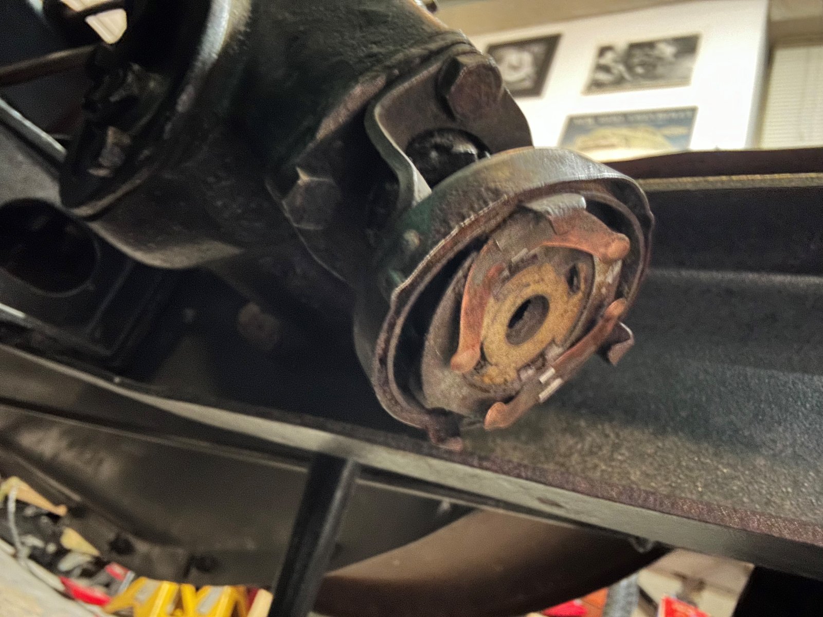

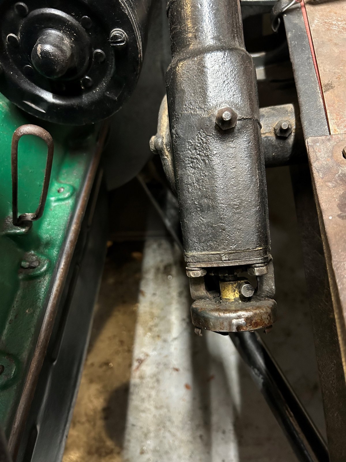

  6. Figured out I have an early '28 column in my '29 roadster, hence why my new light wiring harness isn't playing ball. Going to pull the column and see if I can trade it for a '29 and up one.
    The car was put back together out of a couple barns and fields, so I'm thinking its a combo of a couple different years.

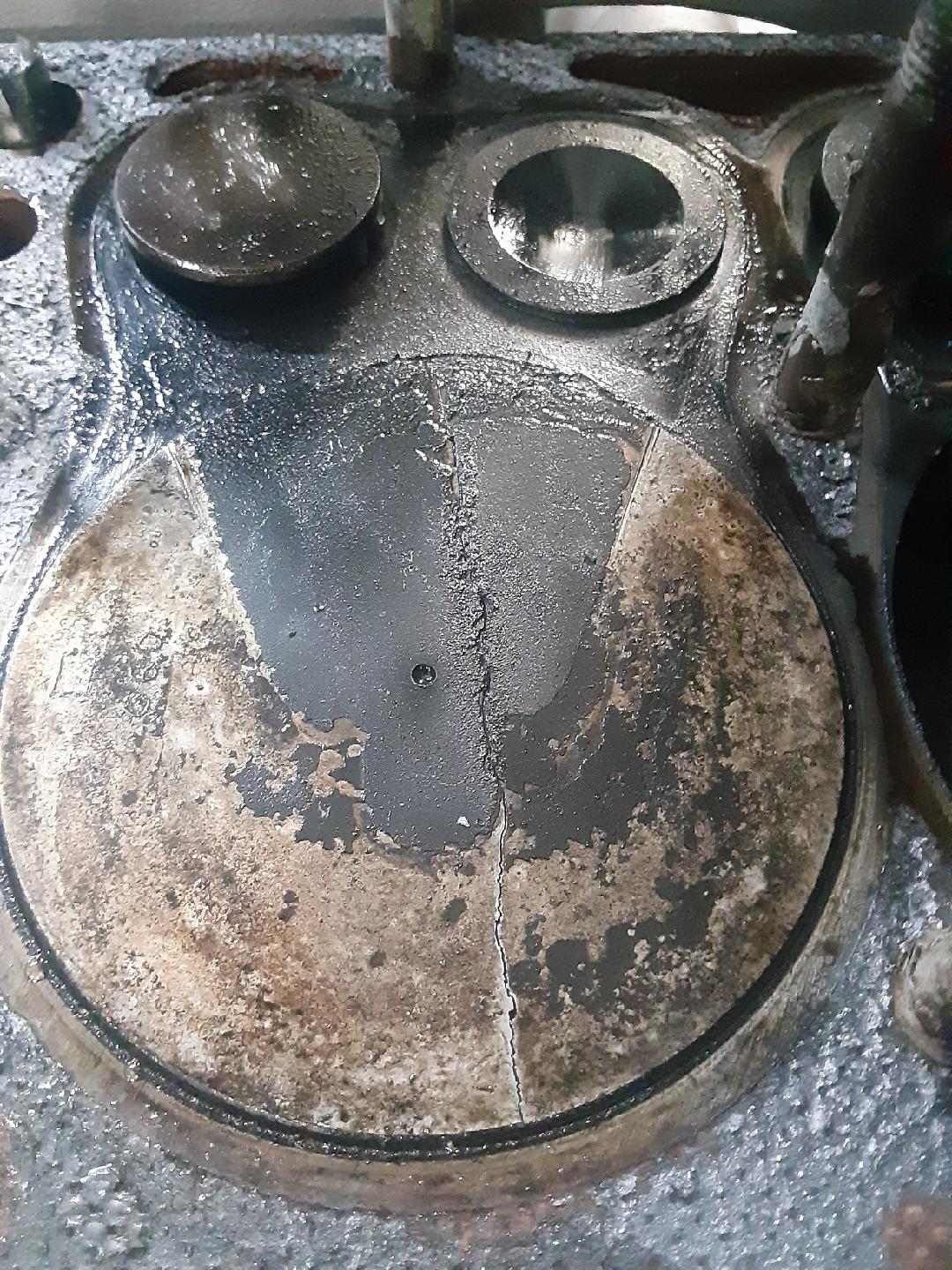

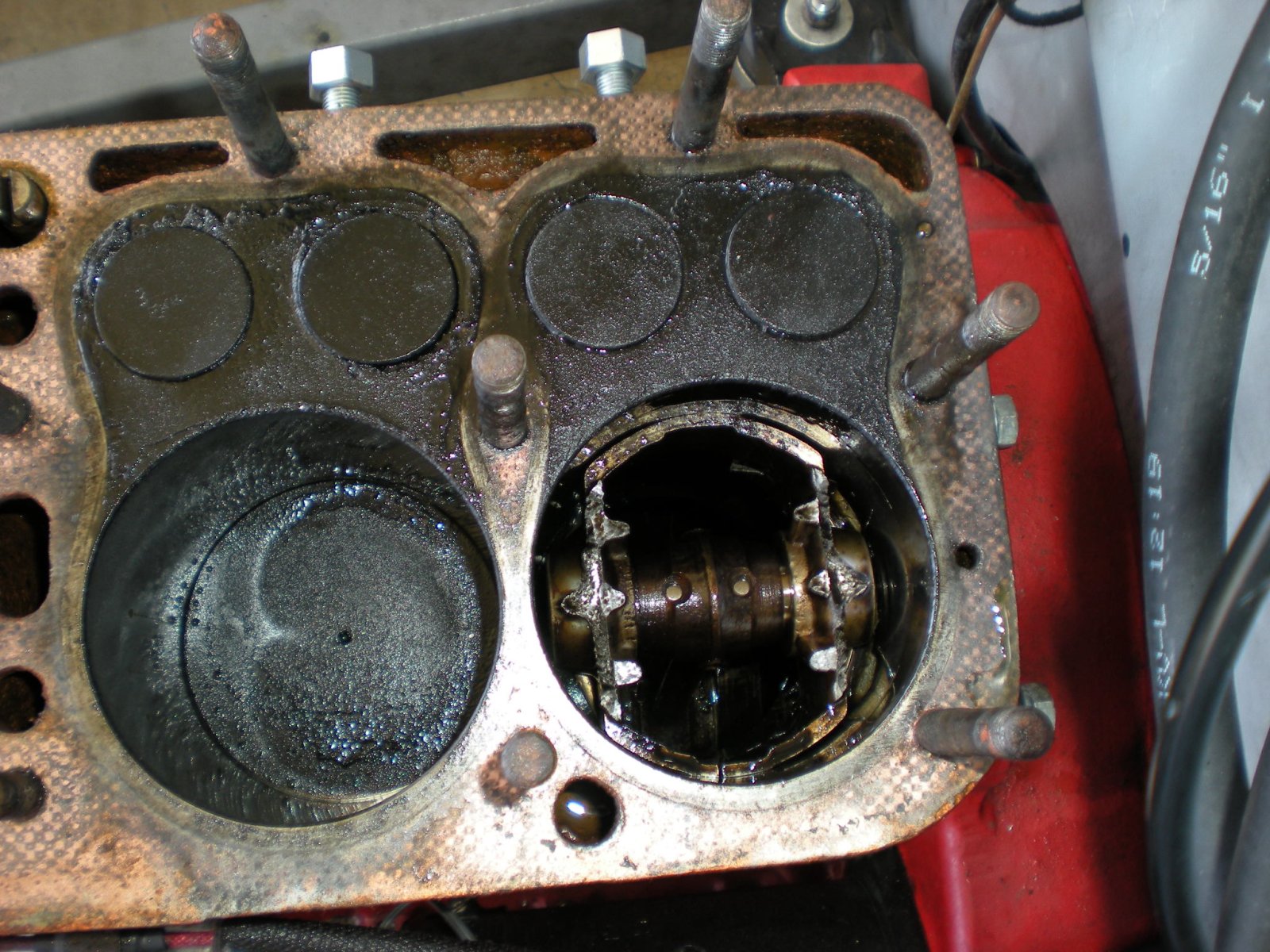

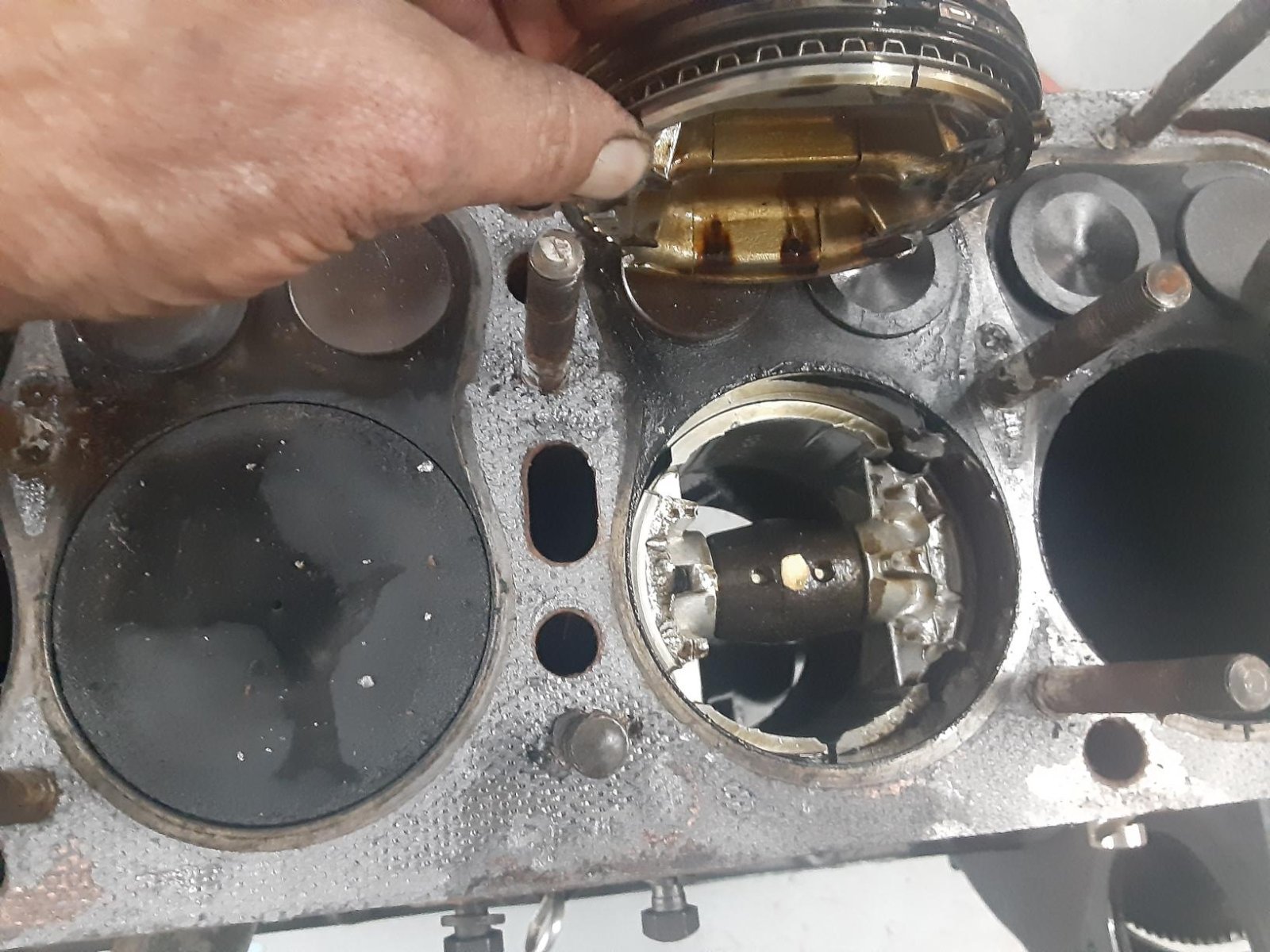

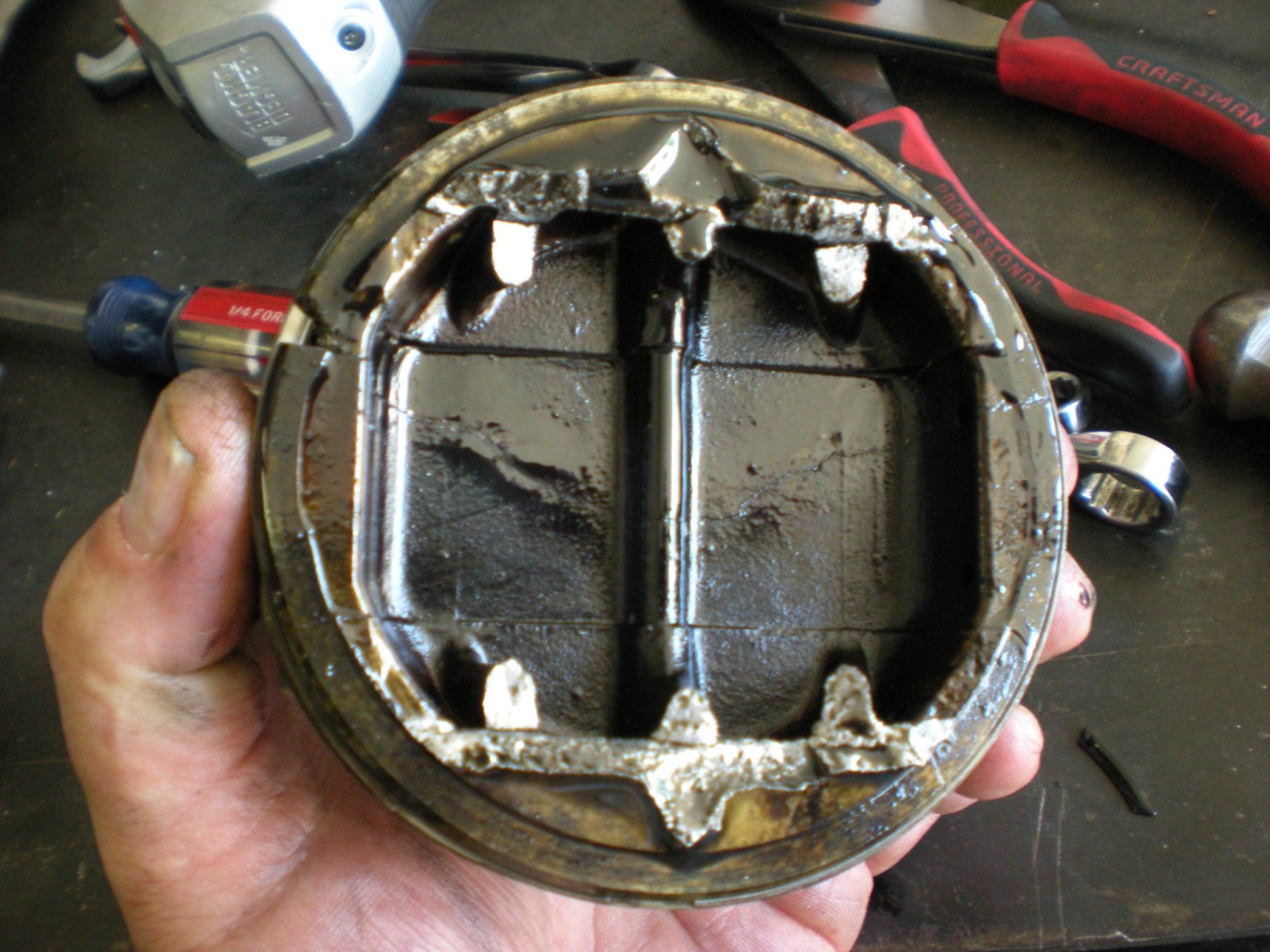

    Sooo, Dan....what do you attribute it to.....
    This is in my buddys car. Not real sooped up but a healthy runner until
    bang... about 5K miles on it.....I've got him a loaner to go in while we sort this out
    Outback likes this.

    I guess my 1st question would be how much total advance are you running and what's the compression ratio. When I see damage like that, I'm thinking detonation. Did you ever notice any pinging when under a hard pull?
    How does the top ring land look? It does not show in your picture. What brand pistons are these? Does not look like there is alot of support for the top of the piston above the pin, but something caused that top to separate other than just normal running. When the engine was assembled, were the ring gaps checked? Was there any indication of the engine getting tight or hard to turn over when warmed up? Is there any sign of scoring on the cylinder walls?

    These were stock Ford factory pistons. I got the engine well used. I reset the bearing clearances but didn't pull the pistons. I installed my 7.5-1 head, mild cam, and dual Stromberg intake. I probably only ran it for 2-3000 miles until it did this. It didn't owe me anything, so I didn't analyze the failure that close. I just took it that the stock pistons were not up to what I was making them do. I was fortunate that it gave up while I was idling at a light. When I tore it down, I just cleaned everything, ran a hone through it to break the glaze and installed new Federal Mogal modern style pistons and rings, and ran it until I knocked out the rod bearing babbit at the drags. That set up lasted @ 7-8000 miles.
    Dan

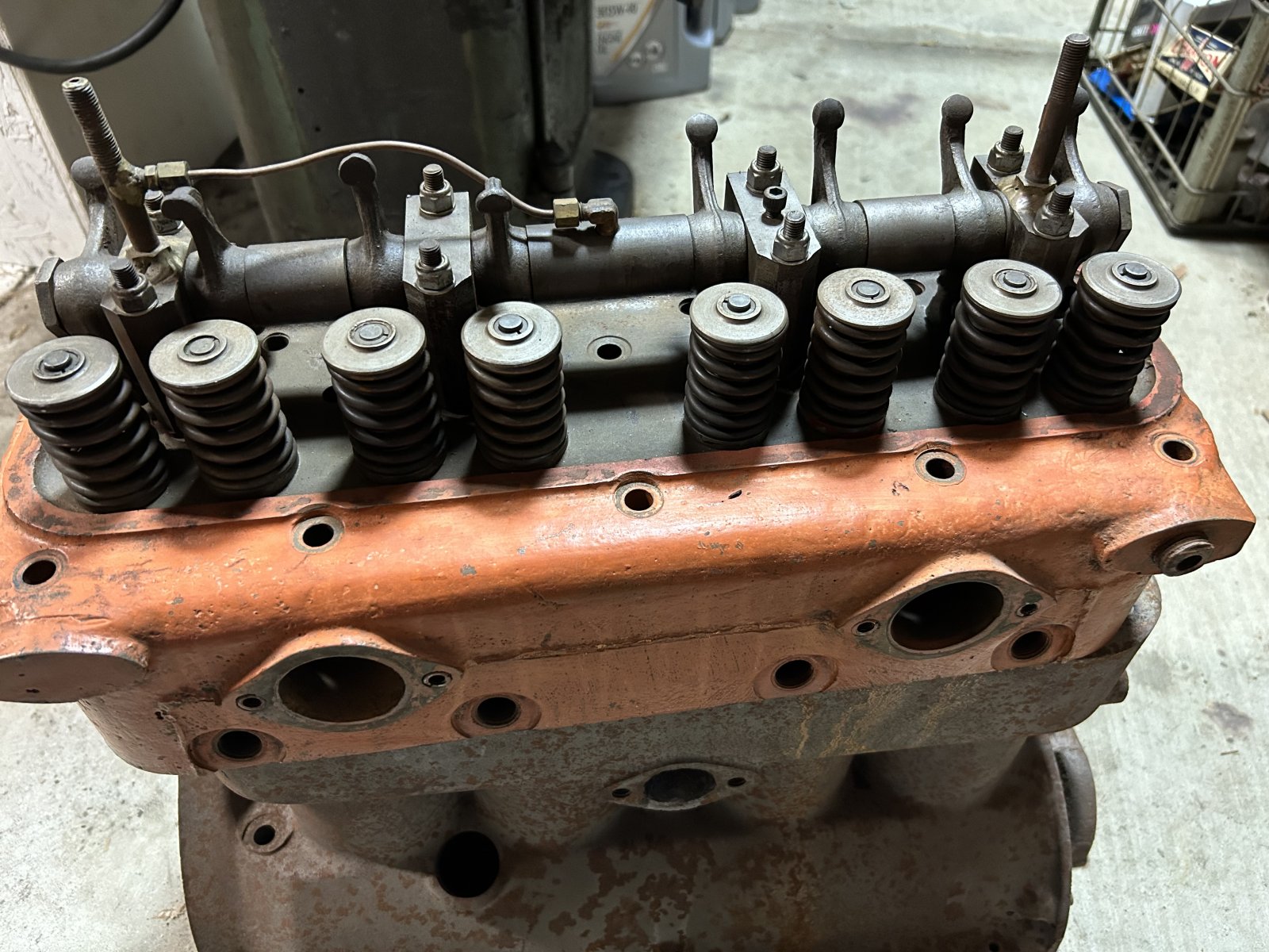

    Been busy making trinkets need to build an engine soon. db1.jpg db2.jpg db3.jpg db4.jpg db5.jpg db7.jpg db8.jpg db9.jpg db10.jpg db11.jpg .

    22 degrees total advance at about 2800 rpm....we are running around at 7000' elevation and he is as deaf as a post
    ring gap was checked and he believes that the top rings were gapped at .018....
    the engine has 7:1 compression on a Lion II head
    we are thinking it was just a faulty piston and he doesn't recall where he got them but nothing exodic
    no tight turning engine prior to it failing
    no piston wall scoring...and it was being torn down later on because it was using oil....he used a full synthetic during the 'break in period' and the rings never seated
    we will tear into it later

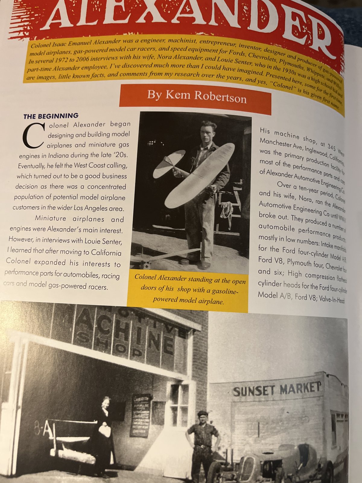

  19. Since I have one, I was knocked over with the huge article (13 pgs) in the January Secrets of Speed magazine on the Alexander Racing head and its innovative maker, Colonel Alexander. Lots of old photos of him and the different speed parts he manufactured, including Spin Dizzy small race cars. Thanks to Charley Yapp and author Ken Robertson for filling a big gap in my knowledge of these rare bits of racing history.
    Awesome info for any banger enthusiast.
    SOSS #33-3, January 2024:
    Mine:
    Old Dawg, Six Ball, Okie Pete and 9 others like this.

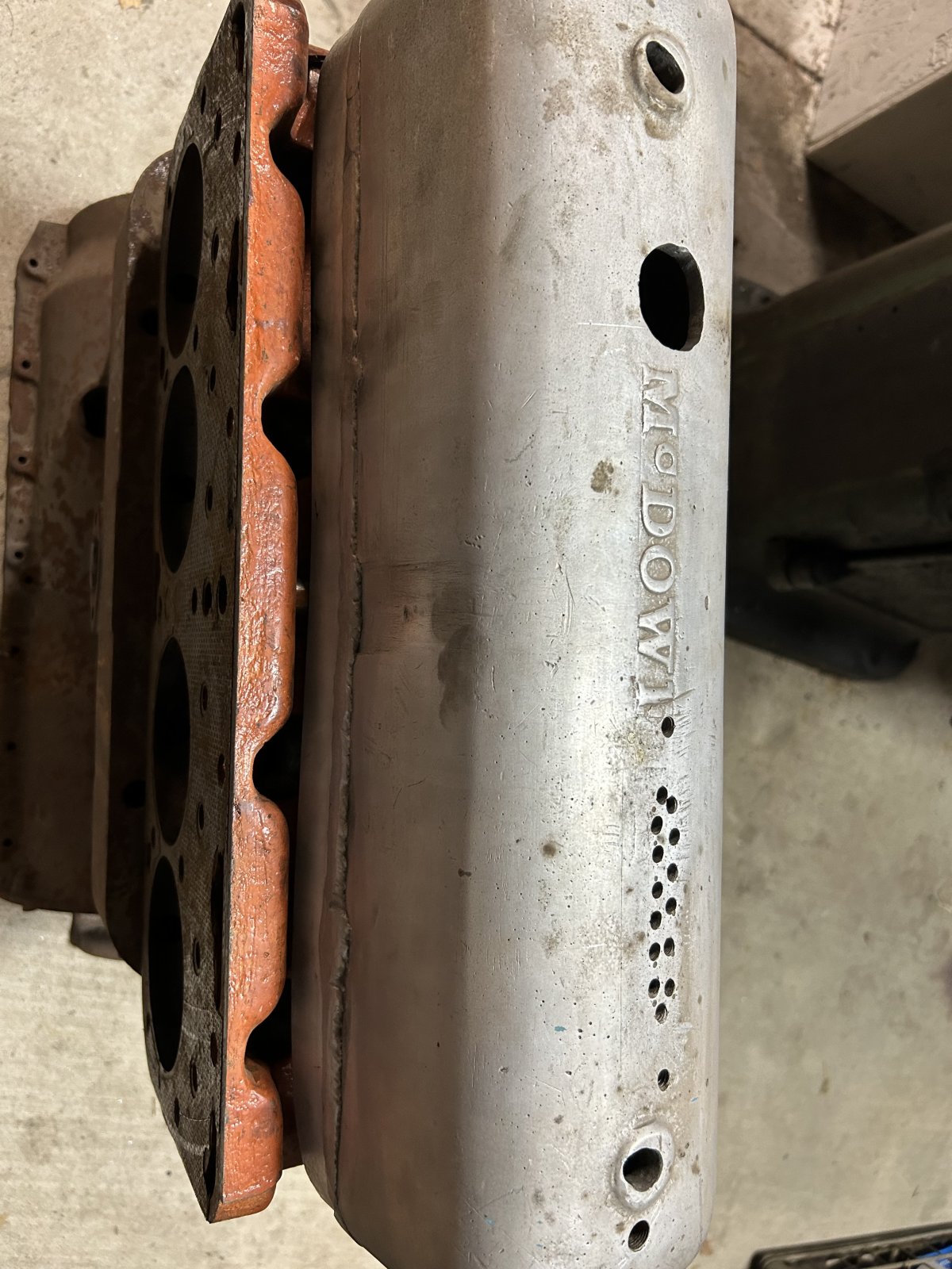

  21. Hey fellas

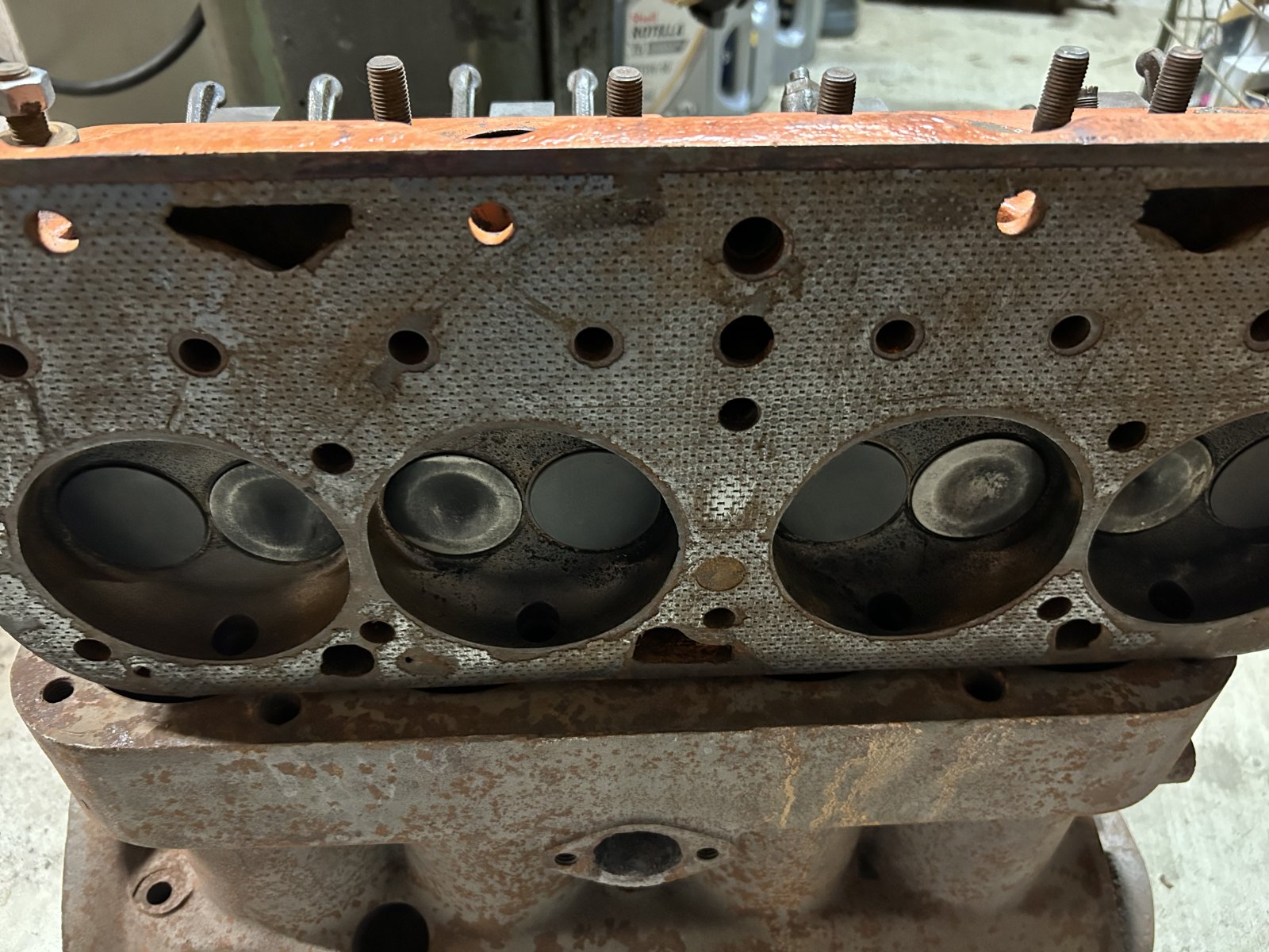

    Time to move this McDowell 2port head
    The gentleman I acquired it from broke the crank and it has been sitting for 20 years
    No cracks visible
    $3500 takes it
    Shipping available at cost

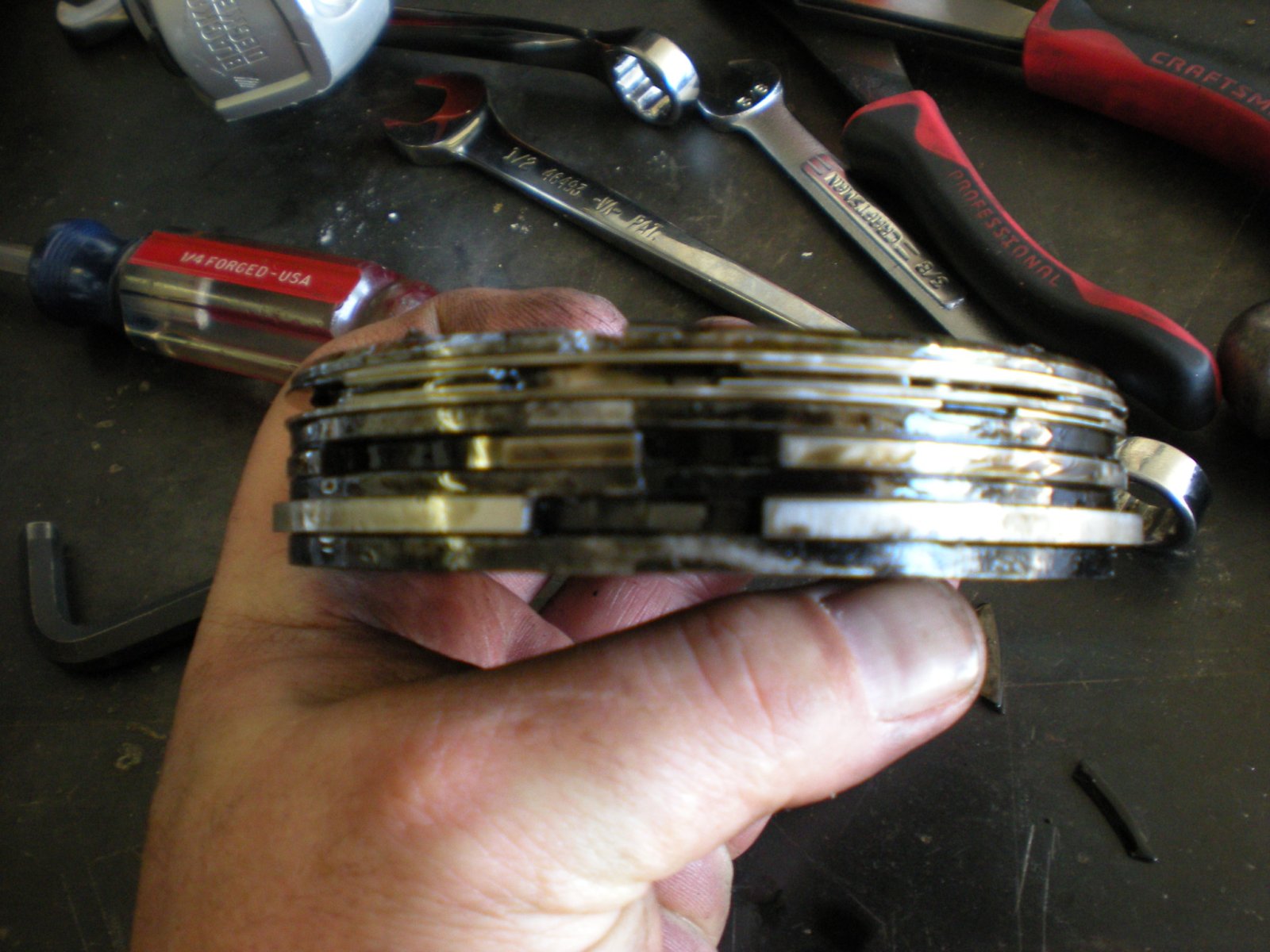

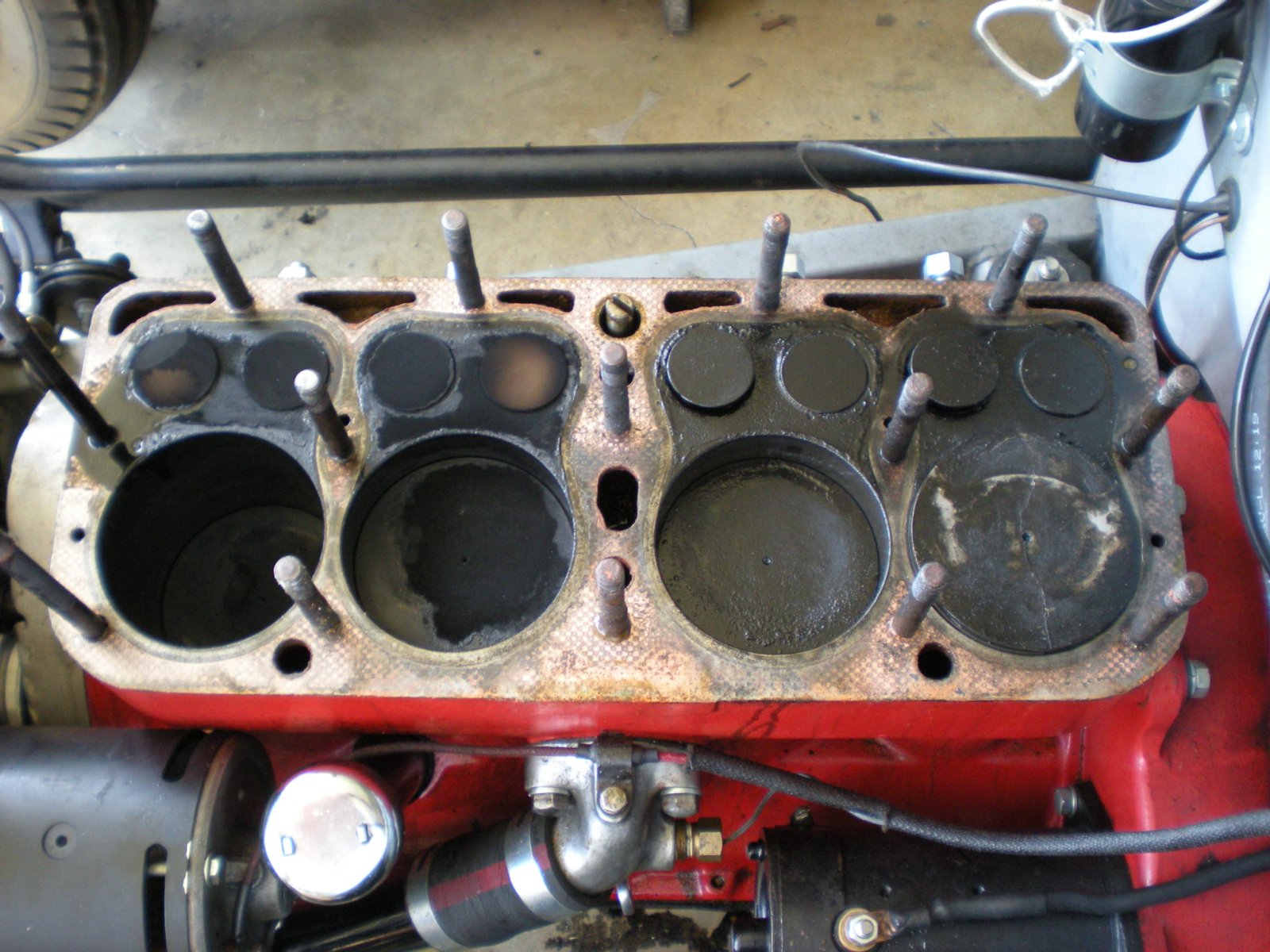

    Pulled the rods today, second ring on the first piston came out in 2 pieces. Put the rings back in their respective holes and checked gap at a the same depth:
    Dan noted last month that "Ring pack should be .125, .125 and .187 oil. Any scoring on the skirts or ring lands?"
    One:
    #1: 0.045
    Two:
    #1 0.046
    #2 0.058
    Three:
    #1 0.048
    #2 0.052
    Four:
    #1 0.046
    #2 0.045
    did not try to remove the oil wiper ring
    MTFCa says 0.003 x bore to set gap. Seems a bit worn?
    Seems the original builder tried really hard to balance the engine. Happy March! IMG_0467.jpeg IMG_0468.jpeg

    Checked the pistons at 90 degrees to pin, on center of the plane.
    Piston - Cylinder bore (U/M)
    #1 3.788 - 3.7910 / 3.7915
    #2 3.783 - 3.7905 / 3.7900
    #3 3.785 - 3.7910 / 3.7920
    #4 3.784 - 3.7910 / 3.7905
    The webernets says to use piston diameter x 0.004 to determine bore? Assume, as long as bore is smaller than that, all is ok?
    Piston x 0.004 - cylinder bore (U/M)
    #1 3.80315 - 3.7910 / 3.7915
    #2 3.79813 - 3.7905 / 3.7900
    #3 3.80014 - 3.7910 / 3.7920
    #4 3.7991 - 3.7910 / 3.7905
    Can I hone and re-ring this, or will it need to be punched out?
    thank you.
