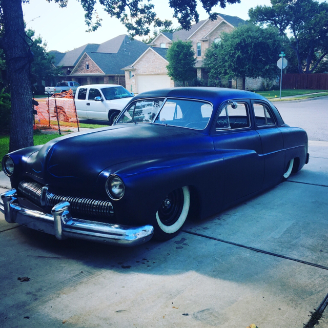

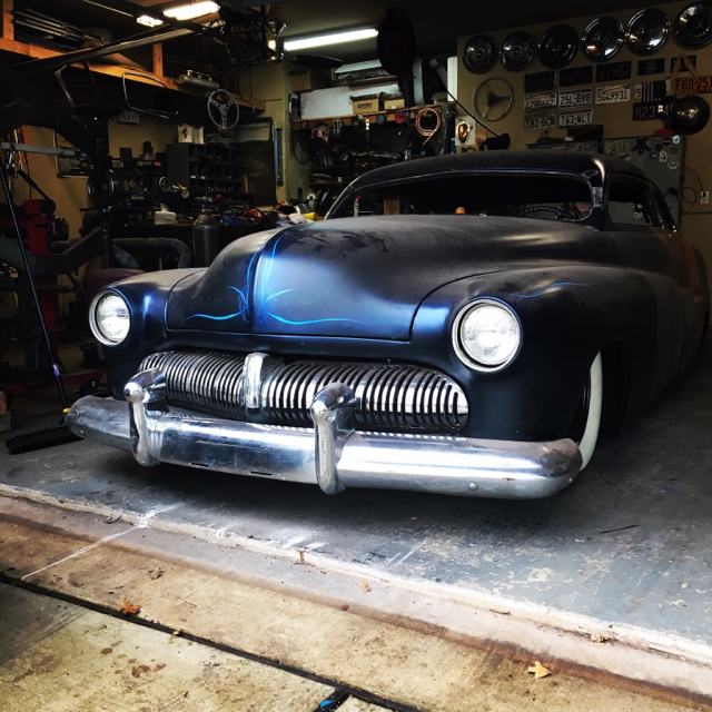

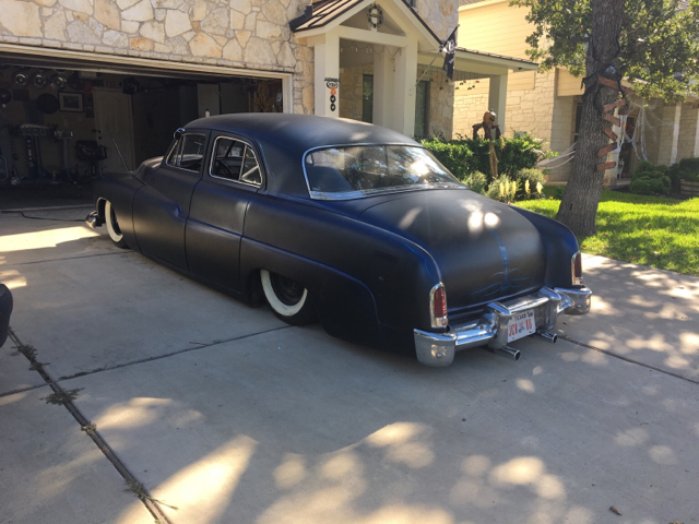

    [​IMG][​IMG][​IMG][​IMG]
    It's actually a pretty solid rust free four-door. I'll be updating the next couple of days.

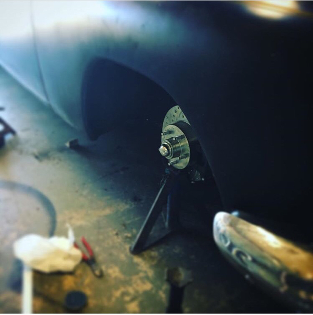

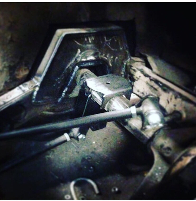

  3. Naturally when I got the car it was mechanically terrifying. I was able to drive home and for a few days before I tore into it. Went through the motor and transmission dealt with that stupid ford TV cable. Put a fire wall mount master cylinder. The previous one was terrifying. It had zero suspension. So put a four link in the rear. I had a set of mustang to drop spindles in stock. So I made adapters to my original a arms to mount them. Replaced my drag link with a one out of a Chevelle. And made all new tire rods in steering. And then put air ride in all four corners. A frame notch and new floors. And completely rewired it. I will try to get suspension pictures shortly. [​IMG][​IMG][​IMG][​IMG][​IMG][​IMG][​IMG]

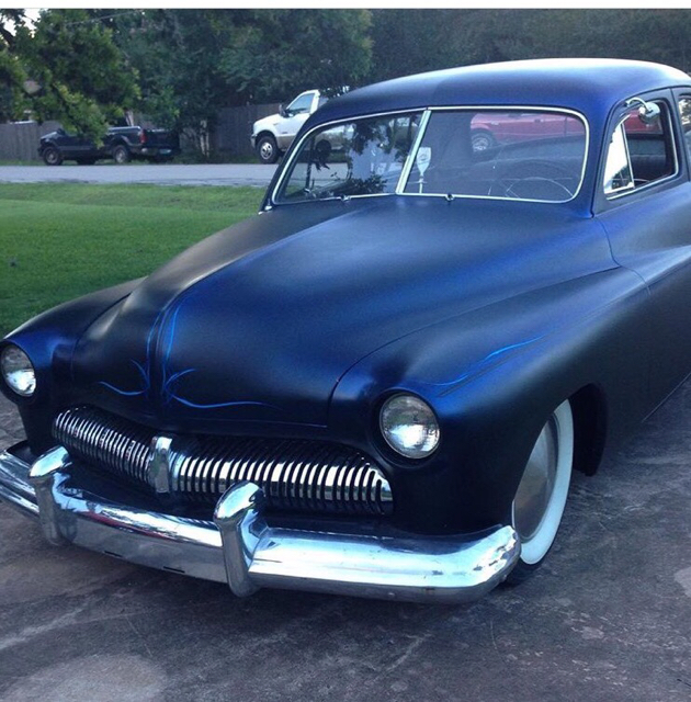

  5. [​IMG][​IMG] so now that the mechanicals are in good order it time to make it pretty. I picked up a repopped desoto grill. I still need to make a pan.

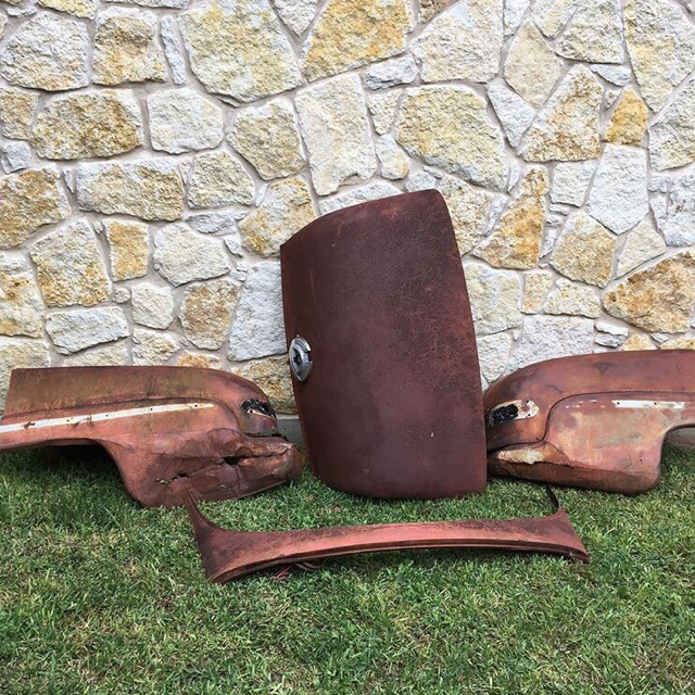

  6. It just so happens a friend of mine had a 50 body in his back yard. It was beyond repair due to rust. So I made a road trip and drug it home. I got the full body and doors. [​IMG][​IMG][​IMG][​IMG]

  8. selling any unused parts from that merc shell?

  11. I have the rear quarters and deck lid. And door skins. Pm me

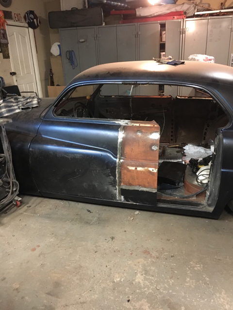

  13. So next is to start on converting it to two-door. The two door doors I had were so rusty in bent from being picked up with a forklift they were unusable. So I lengthened my four-door doors. [​IMG][​IMG][​IMG][​IMG]http://www.jalopyjournal.com/mobi

  14. [​IMG][​IMG][​IMG]. Next I started working on the quarters. Since I was chopping the car I went ahead and cut the window out and welded in the top separately. Reinforcing the B piller and leaving the dog leg for the rear door. [​IMG]

    I am subscribed and already loving this. Very good use of the donor car so far. Shame the original coupe doors got trashed but looks like you were able to salvage enough of them to stretch your doors anyway so that's good.
    I have a '51 coupe I'm working on and I have a '49 rear roof section to use the window from so I'm very interested to see any and all pictures of the roof work, even if they seem mundane, please post them, it's all good info and I have enjoyed your previous builds.

  24. Much easier. A merc is a pretty simple chop. It took more time to build my 36 deck lid than this chop. It's the little stuff that kills. I need to make a pan for my desoto grill. That should be a challenge. If anyone has one laying around I can use to pull a buck off of hit me up.
