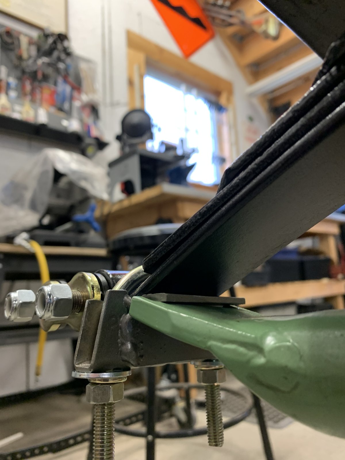

  24. For spreading reverse eye springs, I used a variation of winduptoys approach, i.e. run-of-the-mill exhaust pipe clamps (1-3/4" for the front, 2-1/4" rear) with the angle iron pieces welded to them. Works great.
    34 5W Paul, chryslerfan55 and Outback like this.
