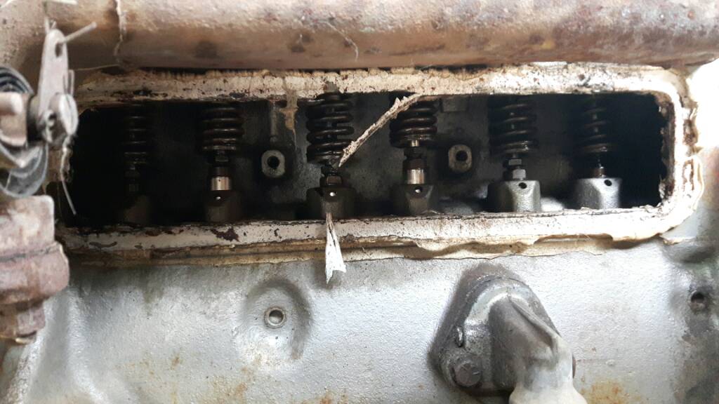

  5. OK getting ready to pull the valves out ..originally thought one was stuck open so I figured after all the head work I might as well pull the . Deck the block and lap the valves and maybe get the Pistons down and run a dingle hone thru them

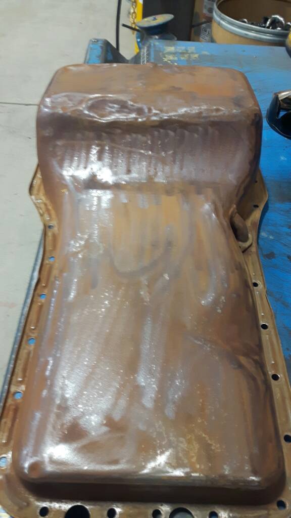

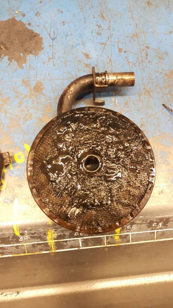

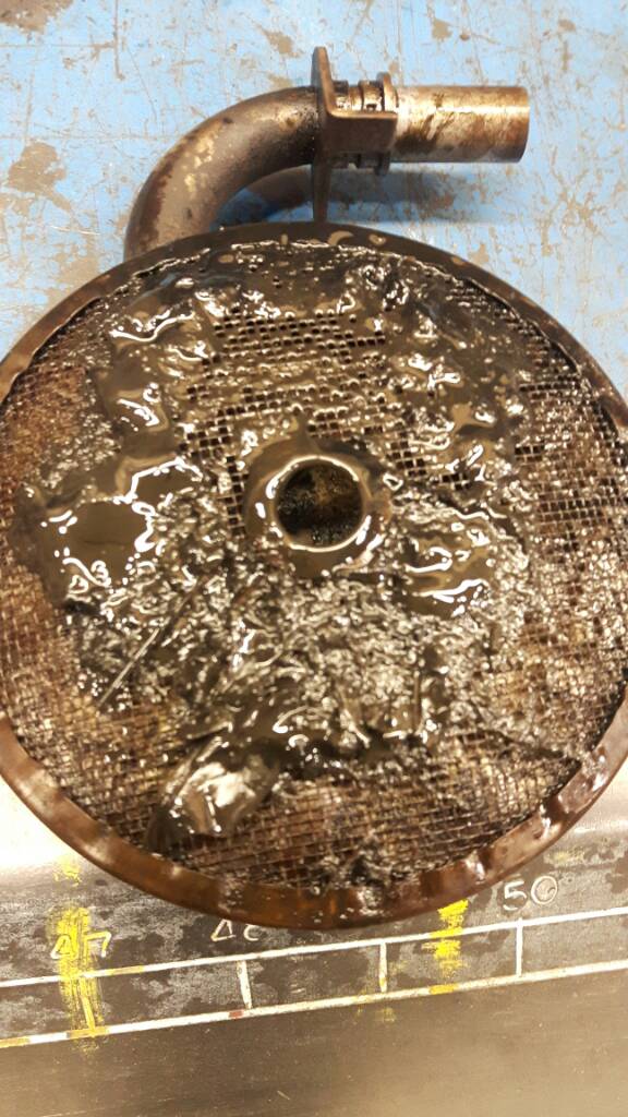

  6. Finally got the oil pan off ...not too much sludge and the bottom end looks pretty clean. Rubbed vaseline all over cam and exposed gears . Going to clean the pan and pick up and re install and pack the oil pump with vaseline and move back to the top of the motor

    Wow you are making progress quickly . The inside of your engine looks cleaner than my 57 Y-block did.

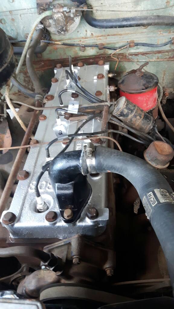

  12. We're getting there guys....cylinder head back on and oil pump packed full of vaseline

  15. Have no spark at all . Thought coil was bad so I bought a new one and still no spark ....took distributor off and bench tested coil and condenser and have a small spark but can't seem to get anything when turning over the car

    Try powering the coil directly from the battery. If it works, something is grounding the coil. If it doesn't, check inside the distributor and make sure nothing is grounding out inside there. The wire coming into the points should have an isolator block to keep from grounding them out. I've seen them missing and cause problems like you describe.

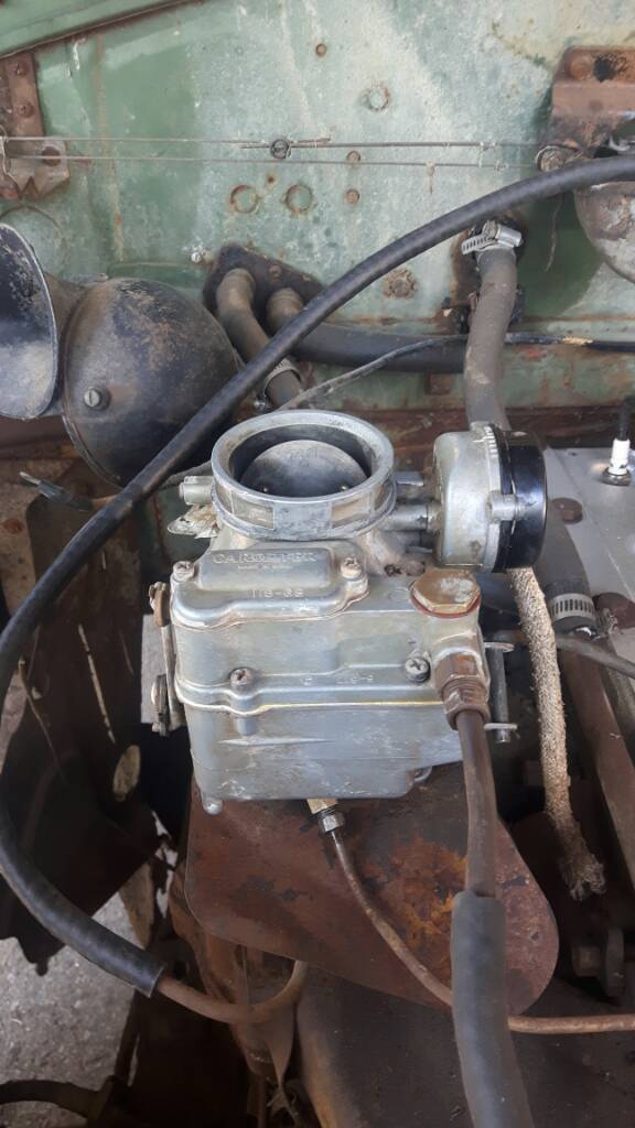

  19. Wish I could upload video but I don't know how ...anyways I sorted out my spark and the car sputtered to life .....but the carb is shot and will only run with squirting has or ether down the throat lol
    ..took my carb apart and I'm cleaning it now .....I don't want nor can I afford a rebuild kit right now ...I just want to make the 3 main gaskets . What materials can I make for the middle and float gasket ? [​IMG][​IMG][​IMG]

  20. scotts52
    Joined: Apr 7, 2008
    Posts: 2,725
    scotts52
    Usually a good local auto parts store will be able to hook you up with some gasket material. Be sure to check all the passages for crud. I've sometimes used sewing needles to clear tiny little passageways.

  21. KustomKreeps
    Joined: Jan 7, 2016
    Posts: 324
    KustomKreeps
    just go to your local garage. With luck one your kinda friendly with or who are old car friendly.
    The amount you need is so small that with luck they will just give it to you. They have it in rolls so an of cut wont mean a thing to them.

  22. OK so carb is all cleaned out and put back together. And I installed a inline fuel filter incase there is any junk in my tank lol ...hopefully I can get her to hold a idle .......question for you guys .....I got some psi gauges at work and I want to plumb one on the motor for my oil pressure? Where do people usually hook these things up to ? .....I'll take a pic of the gauge when I get to work
