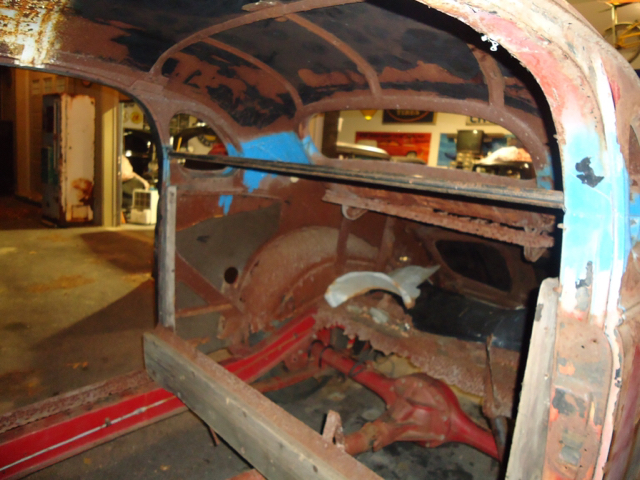

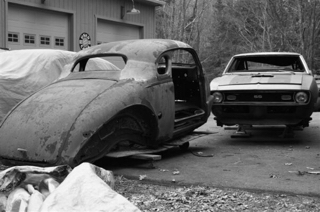

    You can see the extent of the work ahead of me, but at least it was a blank slate! About all I had done at this point was weld the cross tubes to keep the body square
    The chassis has some minor rust issues, but is more or less a healthy roller with 57 Chevy rear, and a grafted 69 camaro front clip

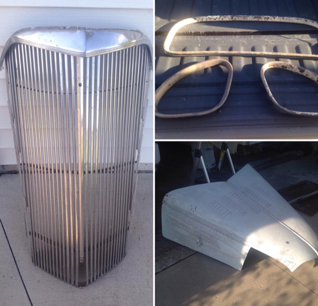

    One of the first components purchased, was this leaded 37 lasalle grille shell attached to 36 ford fenders for $100 at the Amherst NH swap meet.
    The fenders were beyond saving and are long gone (which says a lot considering my enthusiasm to save the coupe lol)
    But the lasalle grille and shell remain a serious option for this traditional custom build. That grille alone has kept me committed to the build

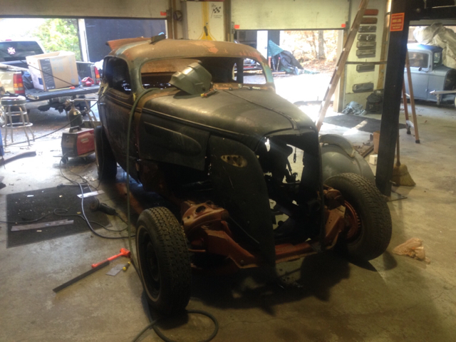

    As you may have noticed, the car already has a nicely done 2 1/2" chop that was leaded.
    This traditional chop is the the only thing that's kept me tied to bringing this car back from the dead. Someone took the time to do such a beautiful chop, I committed myself to putting in the time to make sure it can be enjoyed

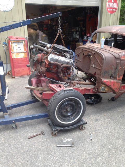

    Originally there was a 283 and powerglide which I had to pull in order to pull the body forward. They put some hokey ass motor mounts that not only looked horrible, but positioned the motor too far back.

    One of the biggest scores was the hood, front and rear fenders, doghouse, and two factory grille shells for $400. Took my dad and I 4 years to find them, but it was time and money well spent! Package deal baby

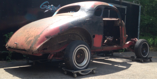

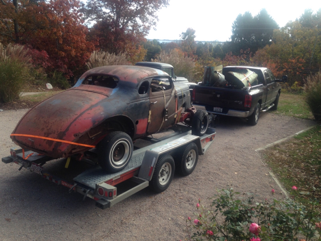

    As stated in the original post, I was ready to bring the 37 out west in November of 2016. So I drove 22 hours straight to rhode island, and spent a day getting the car ready for transport and packing.
    To ensure the body didn't fold in on itself, my dad and I welded a square tube structure to the body and chassis, and bolted down some 2x6's so I could stuff the car with fenders etc, since it'll take some metal work to get them mountable
    At least they were pressure treated!!!

    So I packed up the dodge and the coupe and was on my way west with hopes and dreams of creating a traditional custom 37 Chevy coupe

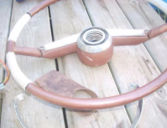

    As stated early on. I've been acquiring parts for almost a decade prior to actually starting this build. One key component I got was a busted $50 56 packard wheel that I restored (partially).
    Using JB weld to fix the cracked wheel, and silver solder to repair the snapped horn ring, I got the wheel to presentable condition. It's not in the car, but it's one of the first custom accessories I plan to install.

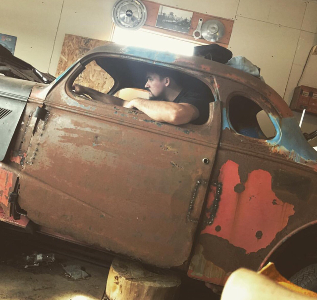

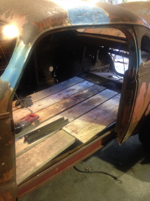

    If I was smart, I would buy a new set of doors. But I'm stubborn, and dedicated to make my doors work. Especially since I have to chop them anyways to fit the car.
    Basically the inner skin and outer skin need some work. But what connects them was completely gone!
    To ship the car I had to go demolition derby and weld the doors shut because the hinge mounting locations were completely trashed.
    Since the floor doesn't exist, and the rockers basically fell off after 8 years of storage, I had to hang the doors to see where the floor should land. So I started on the drivers door
    I cut the hinge mounting portion from the door so I could rebuild it from the inside out
    Then I moved on to the inner door skin bottom
    And finally I hung the door on the car for likely the first time in 30+ years.
    Door still needs a ton of work, but it's close enough to let me start working on the floor and rockers

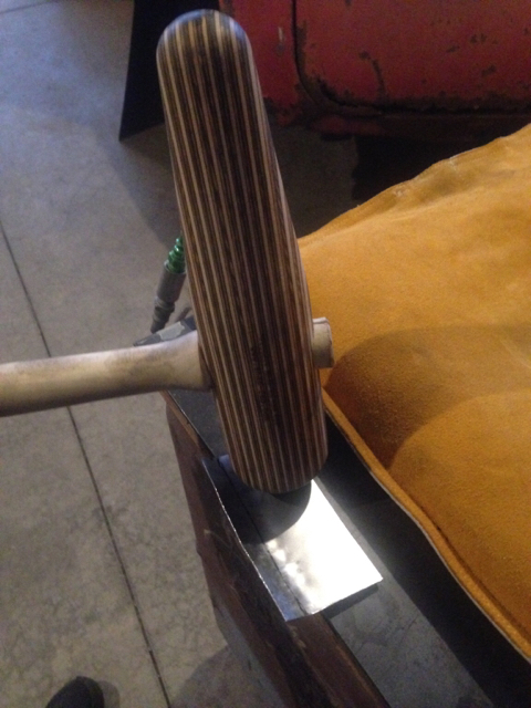

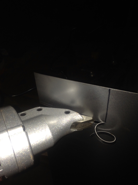

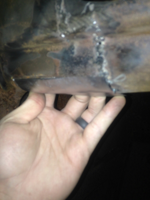

    The last post of the night to catch you guys up to speed was just a little patch I did for the last part of the dash that my donor dash didn't cover. Most of you guys are probably way better than me and have better techniques (please share if you are/do!) but there's probably some guys that could benefit from seeing the process in its simplest form.
    Use paper to layout the true flat layout size of the compound curve patch.
    Trace the paper, and cutout the flat steel to the proper size. This method is best for us simpletons that can't predict the bend deduction in formed/ shaped material
    This piece was small enough to not worry about shrinking or stretching to shape, so I simply used my snap fab mallet and sand bag to pull the right compound curve. Of course some straightening is necessary when I get over zealous
    [​IMG][​IMG]
    Test fit the piece to ensure curve continuity
    I then just used the edge of my bench (followed with some hammer and dolly) to form the hemm to match the rest of the dash
    Before and after shot before weld
