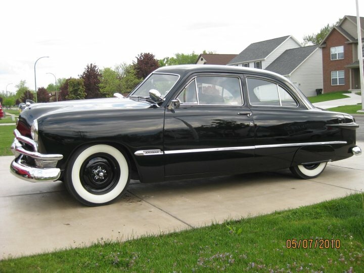

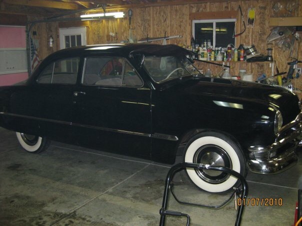

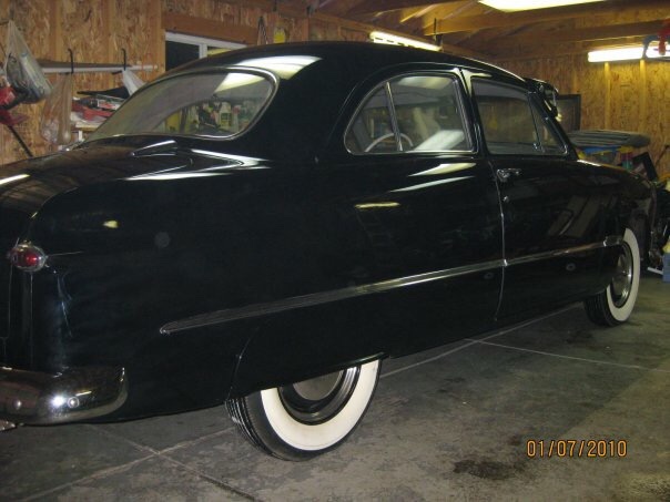

  1. A little back story on this car. 7 years ago my son was born. At the time I had a '34 Chevy coupe ( glass body) that I had built. Seeing how the car was a coupe and had bomber seats there was no way a car seat was going to fit in it. I ended up selling the car and buying a Shoebox. I found the car on Hemmings website, it was about 4 hours away in Horseheads NY. It was a all original 42k mile North Carolina car. [​IMG]

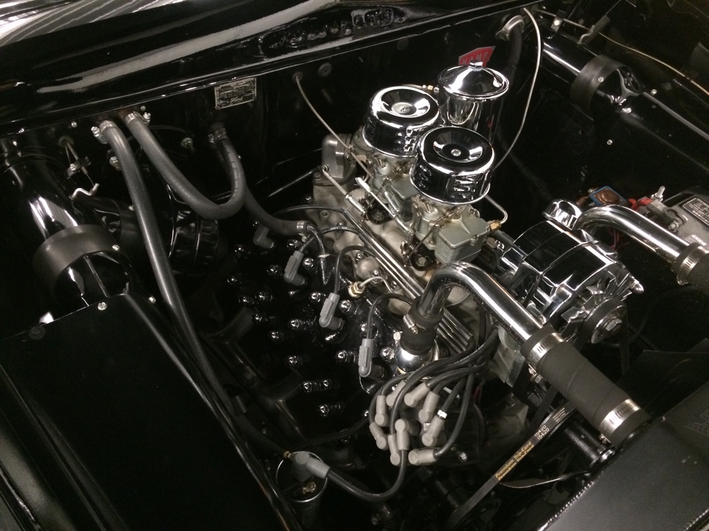

    After I bought it I tracked down one of the previous owners. He was in his 70's and in poor health. When I started telling him of my plans of hopping up the flathead with dual carburetors, and lowering the car he flipped out. He started telling me I shouldn't have bought that car because I'm ruining it by hopping it up. So I stopped telling him what all I had planned for this car. I ended up doing Areostar coils and 3" blocks, I redid the flathead with strombergs, duel exhaust, t5 transmission, and more stuff I'm forgetting. [​IMG]
    Over the last seven years I've put around 20k miles on this car, most of those miles with my wife and son in the car. [​IMG]

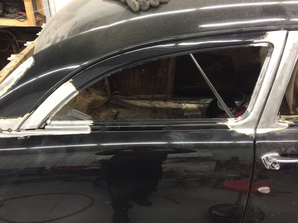

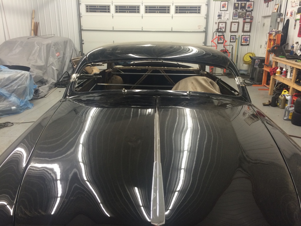

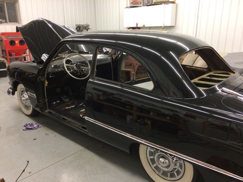

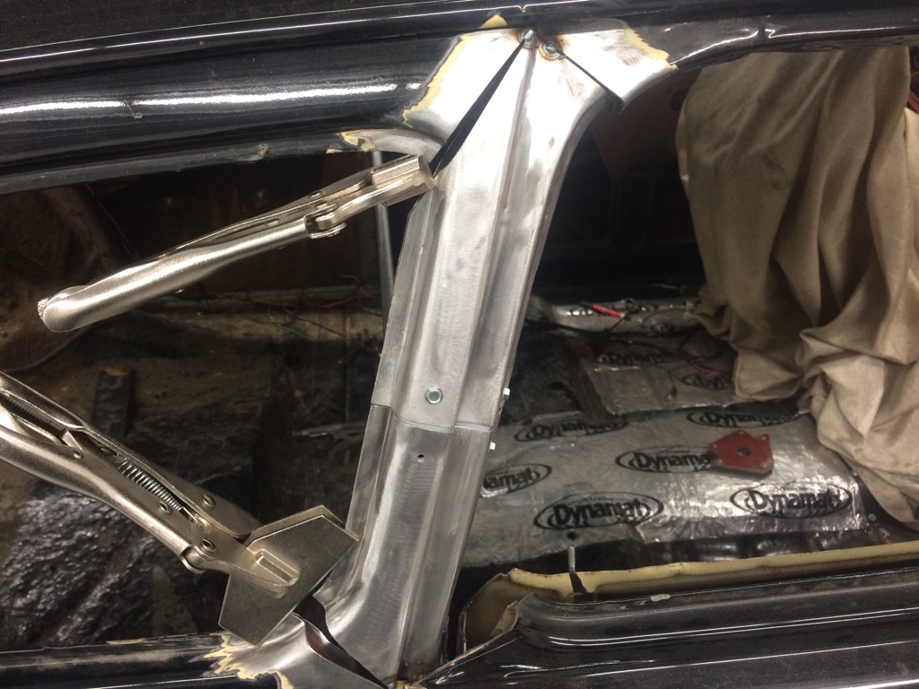

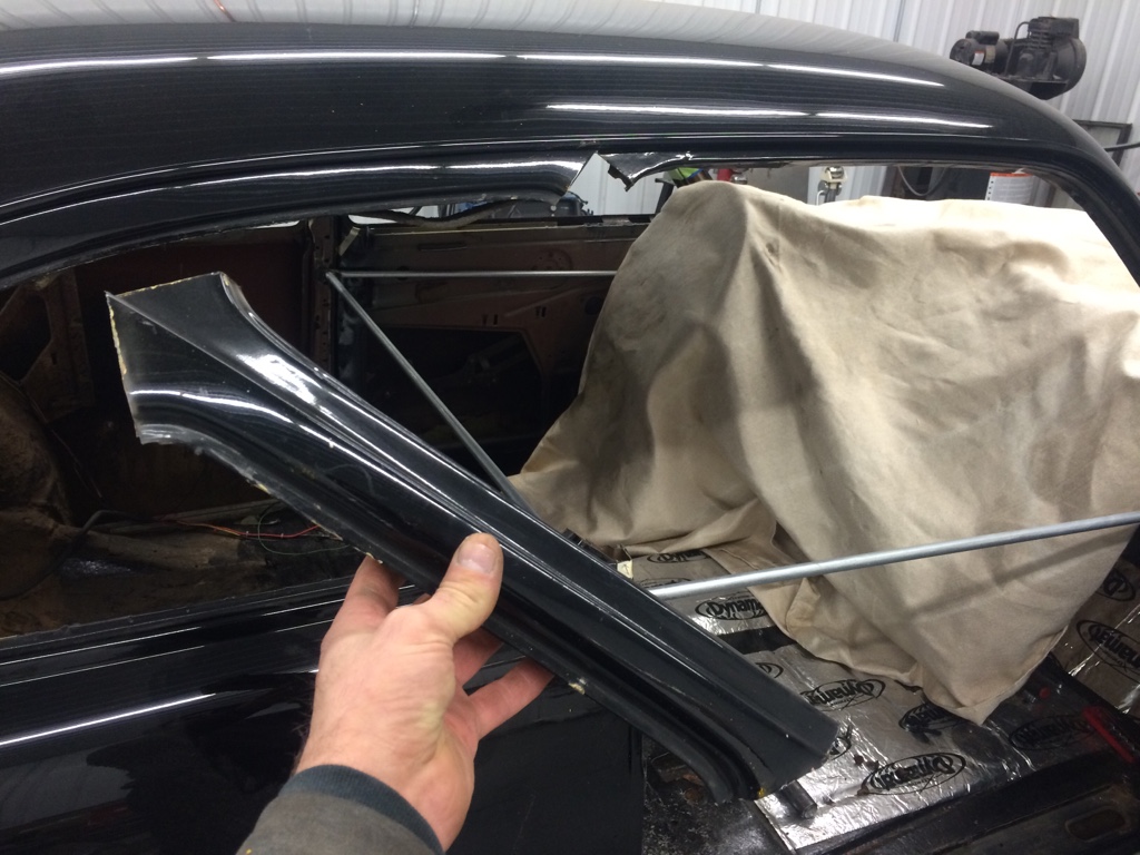

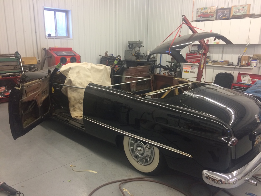

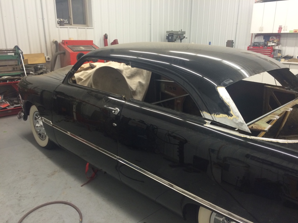

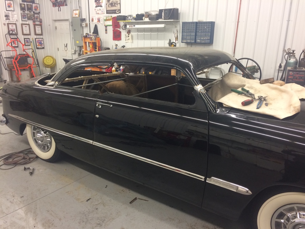

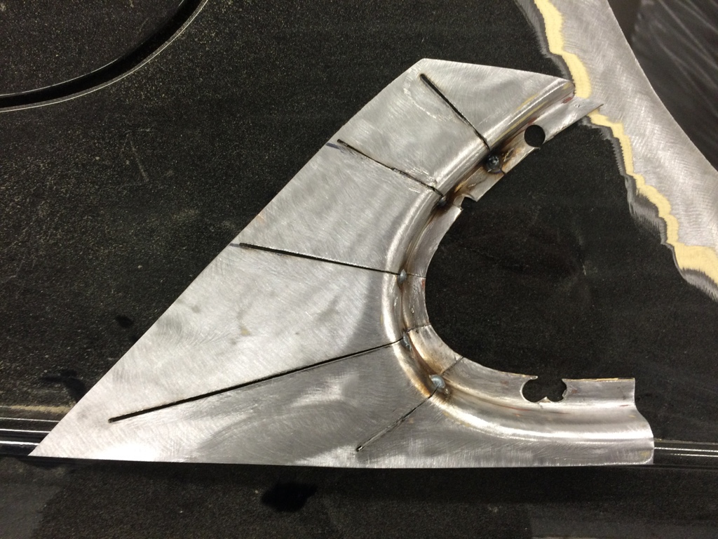

  2. [​IMG]
    [​IMG][​IMG][​IMG]

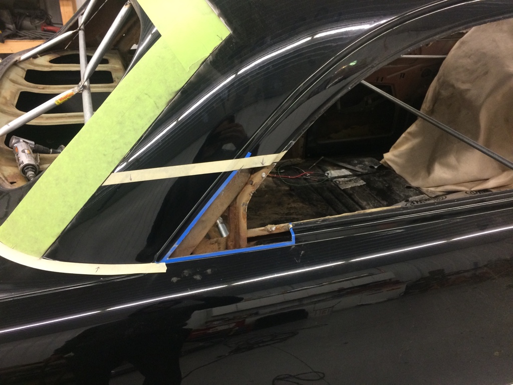

    Plan is to change the color, run the skirts, and '55 Pontiac side trim. I'm gonna keep it pretty simple. I want to leave most all the chrome on the car so the door handles are staying along with the hood trim. All the chrome trim around the glass will be put back on also.
    Sum54ford, 0nedon, Hombre and 15 others like this.

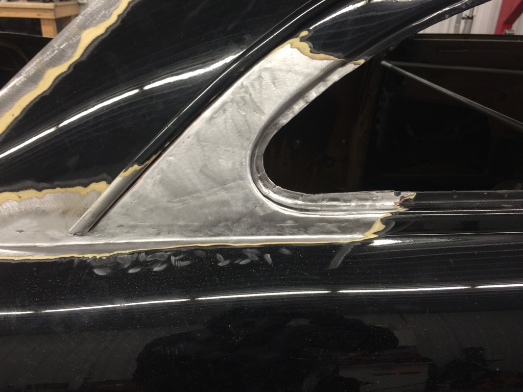

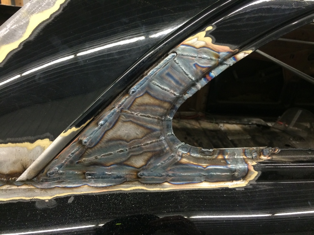

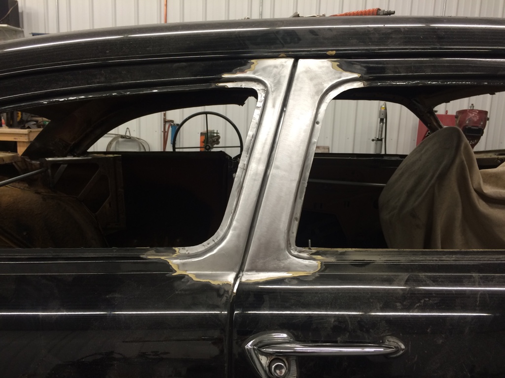

  3. [​IMG]
    Slanted B pillars
    That's pretty much where I'm at on the car right now.

    WOW! Nice fab work.

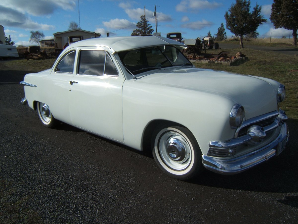

    Well, being a shoebox lover and owner I thought it was really really nice the way you had done it before. That being said, I am afraid I'm gonna like it chopped too! I can already tell by your workmanship it will be killer.
    I don't think I could have cut the top, let alone do the work you do. I'll leave my '51 Coupe roof stock height. Suspension is lowered though with Aerostar springs and blocks and it has been partially dechromed. 1951 Ford Club Coupe 006.jpg

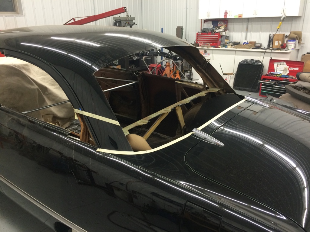

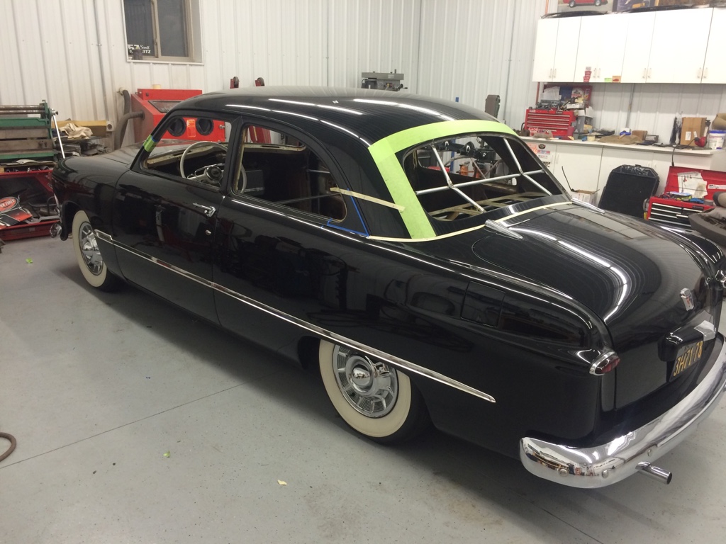

    Very nice work... You know what you're doing. Tell me about the rear glass, I'm curious.

  12. Those 2 door sedans actually need a chop to bring the roof into proportion. The sedan roof is too long. Chopping makes it look more like the coupe which looks so much better.
  13. kept the pictures coming thy show a lot of detail on how your doing it

    Your not a body man or a fabricator, your an artist.
    Nice work.

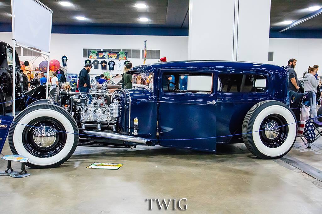

  15. What are you thinking for color? Good to see another new shoebox build thread, hopefully it'll give me some motivation to work on mine. Nice work so far, he sure is spinning now for sure. I agree though, the 2-door sedans do seem to need a haircut just so they don't look so dang tall. Your A build is one of my favorites on here, I expect this one will be as well. Keep up the good work!

    The chop looks like its going to be about perfect! Beautiful work, how much did you take out?
