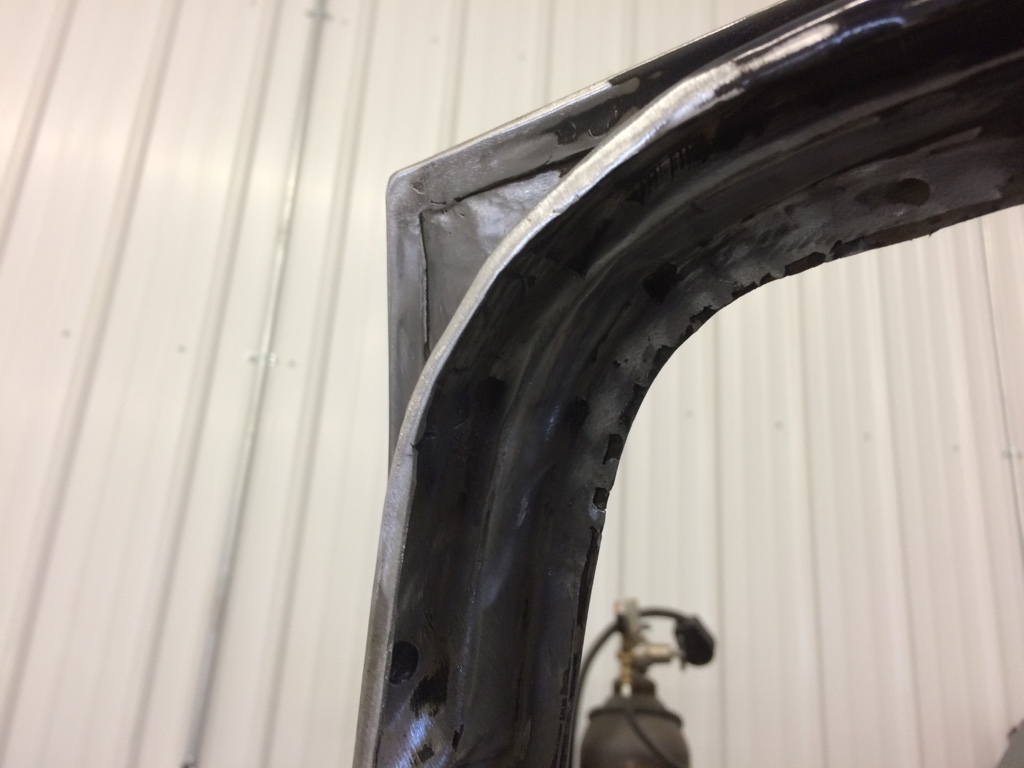

  7. [​IMG]
    I made templates off the passenger side so the curves will be as close as possible from side to side.
    I always try and make the inside of the door look as close to factory as possible. I hate when you open up a door of a car and someone cobbed it up and you can't see the skin edge on the inside.

  9. Mule Farmer
    Joined: Jun 1, 2005
    Posts: 1,508
    Mule Farmer
    from Holland MI
    Great work looks really nice. I agree with you. The work in the inside of the door jam is the difference between I very nice job and a hack job.

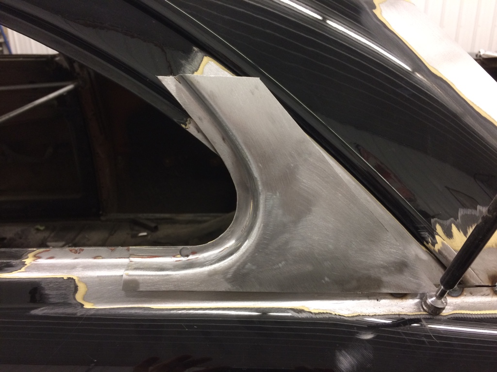

  15. [​IMG]
    Got the back of the quarter window finished up.
    Last night I started laying out the back window placement.
    I have the window moved forward about 3 1/2". I wanted to kind of split the difference between a sedan and a coupe. I'm probably gonna stare at it for a few days and fine tune it a little before I make it permanent.

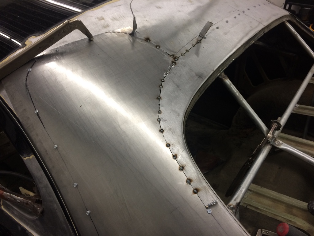

  21. I got the back window set to where I want it. [​IMG]
    I covered it with masking tape to get a better feel for how it's gonna look. I ended up moving the window forward 4" at the bottom.
    I have the left side sail panel roughed in. I spent about two hours wheeling it, it's pretty close. The black marker lines are where it's gonna get trimmed and spliced into the roof. [​IMG]
  22. Very nice work that is impressive! Hobo Jim
    tudorfritz likes this.

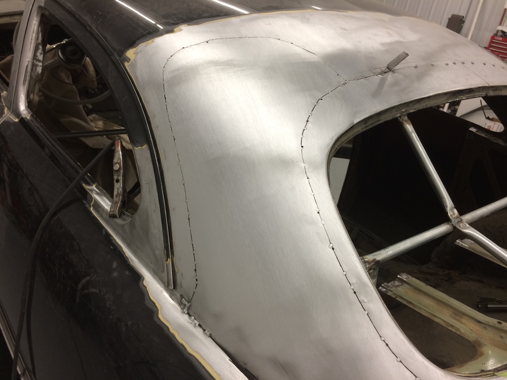

  28. I haven't gotten much done in the last two weeks. Last week I cleans the shop up and got the Model A out for a show. Last Friday while I had my trailer hooked up I went and picked up a lift.
    I spent three nights putting it together and setting it up. [​IMG]
    Back to work now. I got the left side sail panel trimmed and tacked in place. [​IMG]
    Working on the right side now, hoping to have it all tacked together by the end of the weekend.
