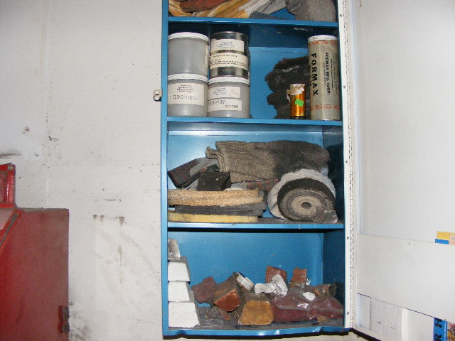

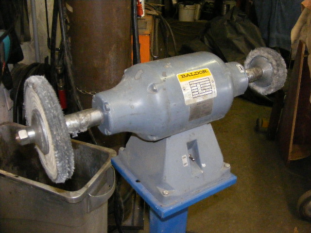

    I bought one of those pads like the polishers use about 1" thick and 9-12" around and 3 different "bricks" of different compounds and use my bench drill press on a mandril I made. Makes a mess a bit so I've learned to hang some plastic sheets around it ( actually big black trash bags) and normally need to do my T-Bird valve covers once a year to look good.

  25. I've got the same set-up as Brigrat, and that will polish anything with the right prep. Your valve covers don't look too bad, so with a buffer (preferably something that turns around 3400 RPM; most any of HF's bench grinders will do the trick, and less power/RPMs will increase time) and a sewn cotton buff, start with red rouge compound. After you're happy with that, if you want the 'chrome' look, follow up with a loose cotton buff and white rouge. Definitely remove them for buffing, it WILL make a mess.
    For not-too heavily oxidized/corroded parts, or to remove scratches, gouges, etc, I really like 2" Surface conditioning discs (AKA Scotchbrite) on a 1/4" angle-head grinder. The Blue disc is great for cleaning to 'good' metal if there isn't any major pitting, follow up with gray and the part will be ready to buff. For really heavy stuff, use the red or brown discs, but be careful; these will remove metal.
    I'll also note I've been the happiest with Eastwood's buffs and compound. Make sure you use a separate buff for each compound.
