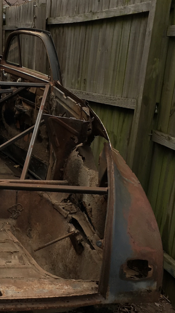

    Thanks, definitely out of the box. But I couldn't see scrapping a car with a good title.
    Body was much worse than you think. Beltline up was great, everything below that was Swiss cheese. The undercoat was all that was holding much of it together. The rear fenders were held on with bailing wire and two bolts each. I put my socket on one bolt and it fell thru. And it provided many hard to find parts for my other '47. Fenders, doors, etc. are stored away in case I need anything from them.
    I knew it was rusted when I bought it, but it was complete. Once we pulled the interior and the rust started falling out, the whole body would sway when you shut a door. So we braced it to keep it from falling apart in the driveway.

    The photo in post 15 says it all as far as the car's actual condition was and now it gets to live a new life more than a little bit reconfigured rather than just giving up the good parts and heading to the crusher.
    I'm in as I want to see where this goes. and it looks like a fun one
