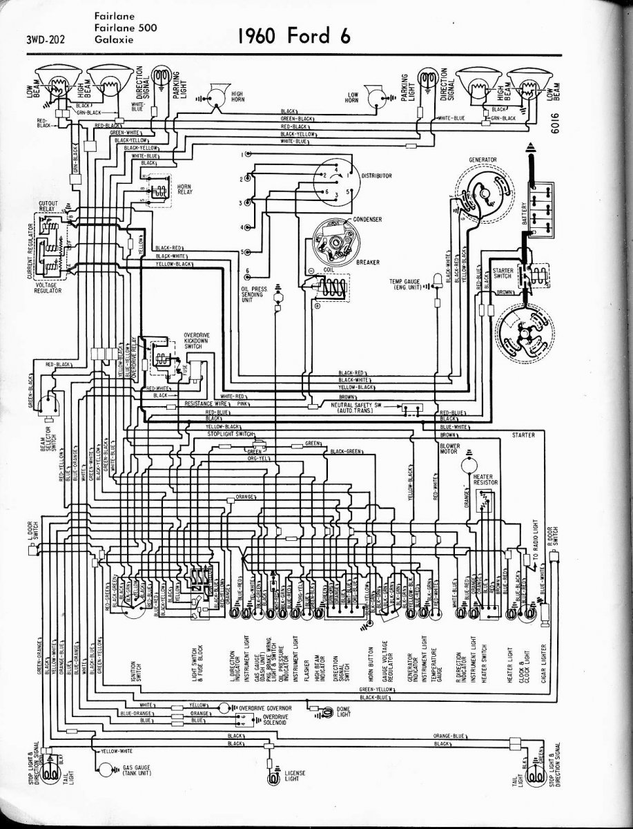

    Also, in the wiring diagram below it looks like the wires from the back of the car go into some plugs or junction boxes in the front part of the trunk area. I couldn't find anything like that in the trunk or under the back seat so what exactly is that supposed to represent? Thanks again....

  24. Lebowski
    If the wiring diagram above is correct for your car,the wire leading FROM the t/s switch to the right rear bulb is orange and blue.
    Simply disconnect the t/s switch under the dash where it runs into (and up) the steering collum.
    Take a test lead that is 12 volt hot from anywhere and apply 12 volts to the orange /blue wire going back into the wiring harness. (Not up the collum)
    If your wiring is good all the way back to the right side - applying the voltage will make the right side bulb lite up.
    Its the direct wiring "hot" path from the t/s switch all the way back to the right side.
    If it lites up (as I suspect it will) then your t/s switch is fubar !
    If it does NOT lite up then start looking for a problem in the wires path such as bad grounds,poor connection at a junction point,broken wiring harness in trunk,etc.
    Your old back will just love laying under the dash.
    Hope this helps,Oldmics
    54vicky and Hnstray like this.

    It may be simple for you but unfortunately it's not that simple for me. I have one of those test light things with the wire with the alligator clip on the end that you clip onto something metal and then stick it in a wire to see if it lights up. Will that work? If so I stick it in an orange and blue wire at the bottom of the steering column and see if it lights up? Thanks for the tip...

    The wire coming from the right brake light is solid orange. There are 4 wires coming from behind the steering wheel and down the steering column but the closest one is orange with a black stripe. It plugs into one wire under the dash. Is that what I'm looking for or is there supposed to be some type of plug that several wires go into? I made a wire with 2 alligator clips so should I unplug the orange and black wire from the other wire and put one alligator clip on a hot fuse in the fuse box and the other end on the end of the orange and black wire that goes up to the steering wheel and then jam a 2x4 between the brake pedal and front seat and see if the right brake light works?
