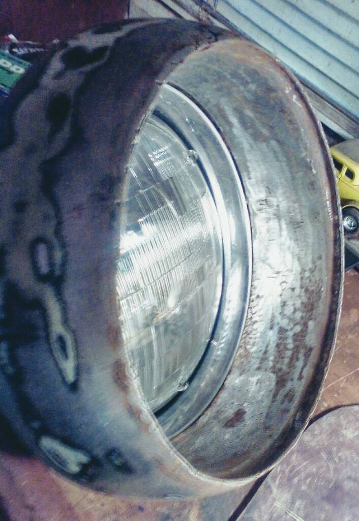

    I came up with a set up that I'm doing on a 50 Chev Bel air mine are more of a tunneled Frenched headlight I have them posted on here somewhere. I started with Frenching kit turned out to be crap so I gave it my own twist took the can part used Hillman head light bucket and mounting ring a 57 ford head light ring and a 53 54 inner ring put it all together and ended up with a tunneled Frenched headlight that is all adjustable and removable from the front.....

    Here's some pics of what I did, the inner ring I'm going to make some clips of some kind that wedges against the ring when slid in to hold it then there's going to be drain holes in the bucket, I'm in Oregon it rains sometimes.......And I will probably put a brace from the back of the bucket to the fender for support....[​IMG][​IMG][​IMG][​IMG][​IMG][​IMG][​IMG][​IMG]

    The studs that are in the bucket that the bulb holder goes on too are spring loaded so you put your bulb into the base ring, then put the bulb retaining ring on 3 screws hold it together then slid the assembly into the bucket, line the three slotted holes up with the three spring loaded studs push down and twist once it is locked in place use a long skinny screw driver the adjustments are made by turning the three spring mounted studs that the headlight assembly twisted on to ....When adjusted slide the stainless inner ring in to the bucket down over the light it is locked in to place with three clips but I think Im going to put a couple of peaces of Velcro to hold it in so it is easier to remove also if you use a suction cup on the headlight it helps when lowering the bulb assembly into the bucket

    Ah, thanx for the explanation. Get how it works now. Need to do some measurements on my bezel. Don't think I can drop in the buld 'n bucket the the front of my bezel. Like your idea tho!
