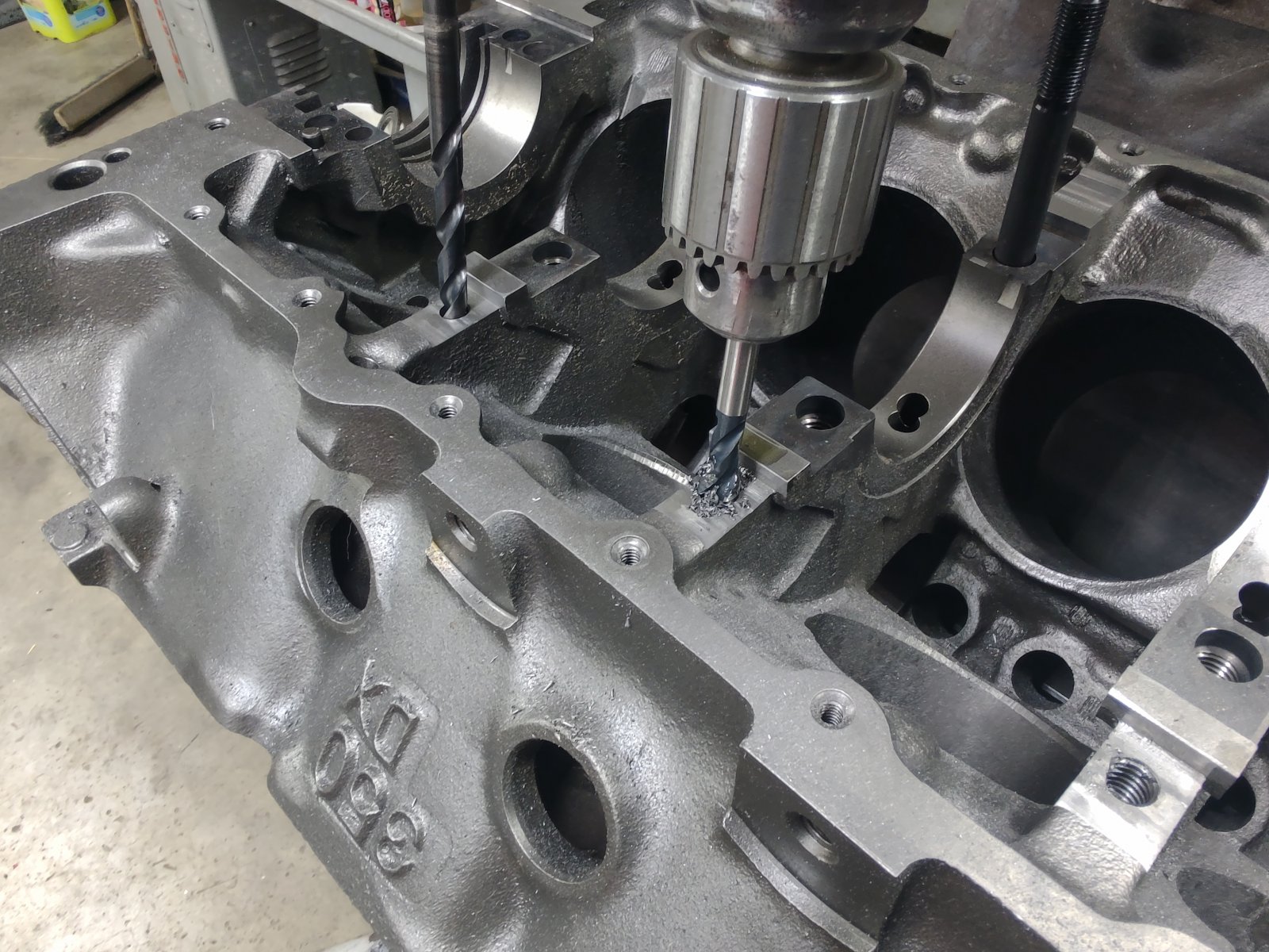

    Drilling for the splayed caps this evening. I used a transfer punch to find my angle and center on the holes. Then swapped to a drill bit the same size to spot drill the block. Then went to a U bit to drill for tap size. I'll set up to tap the holes later in the week. IMG_20220531_181312800.jpg IMG_20220531_181321518.jpg

  3. Atwater Mike
    Joined: May 31, 2002
    Posts: 11,624
    Atwater Mike
    Always was drawn to manual machining. Use your head, find solutions.
    Go, man...Go!
    OahuEli, Saturn V and 427 sleeper like this.

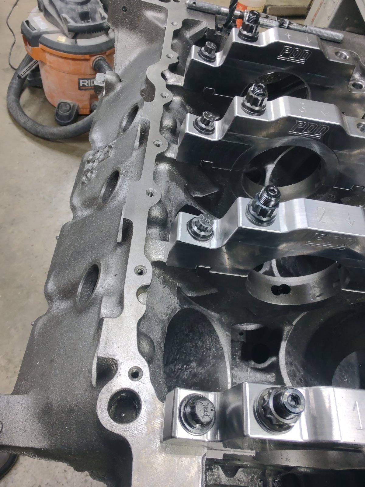

    Putting wrinkles in holes tonight! IMG_20220602_181935669.jpg IMG_20220602_184052241.jpg

    These kind of processes have always amazed me! I wish I had the Patience, Skill, and equipment to do this kind of thing! Lookin' Good Brother!
  10. Looks very racy!

    I thank you all!! I wished I could still be able to do it in a timely manner, like 5 yrs ago. But I can still do it. Just takes way longer!!
