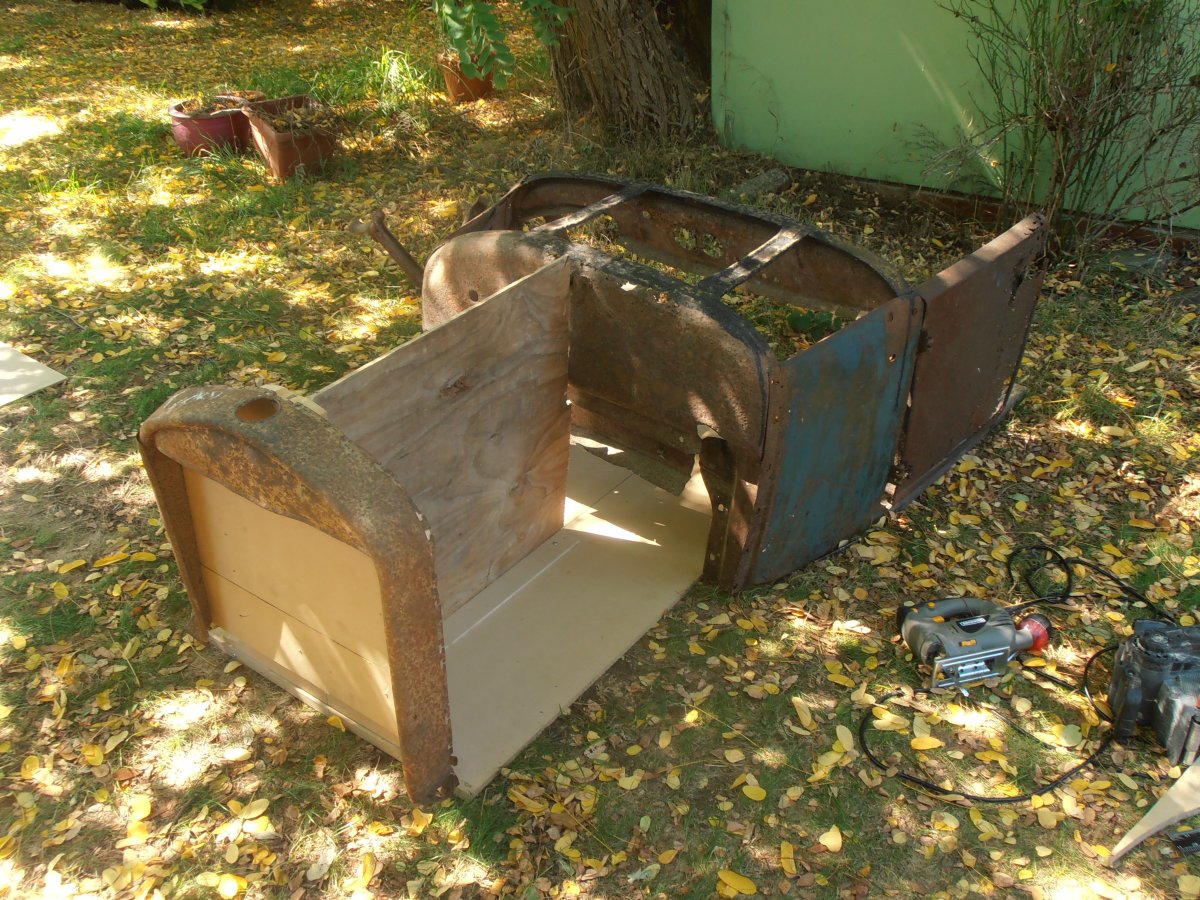

    P1010120.JPG Hey Guys.
    I have been working out what to do with my collection of 26 Model T Parts. There are two Roadster cowls, a pitted grill shell and a pair of mismatched doors, one a tourer rear and the other a roadster front. The first cowl I found out in the bush in 2004 upside down and filled with rubbish. Pulling it out of its temporary grave I realised the only thing holding the top on was rust. Three other top cowl sections were sourced but none were quite the right fit. A month ago I was lucky enough to get a complete cowl from my local rod shop for a hundred dollars with a pitted T grill shell for an extra ten dollars. I thought all my my problems were solved until I git it home an realised that although it was more solid than the first one, it had major damage to the bottom of the fire wall. I could have made a good one out of the two but decided to go down a different path. P1010140.JPG

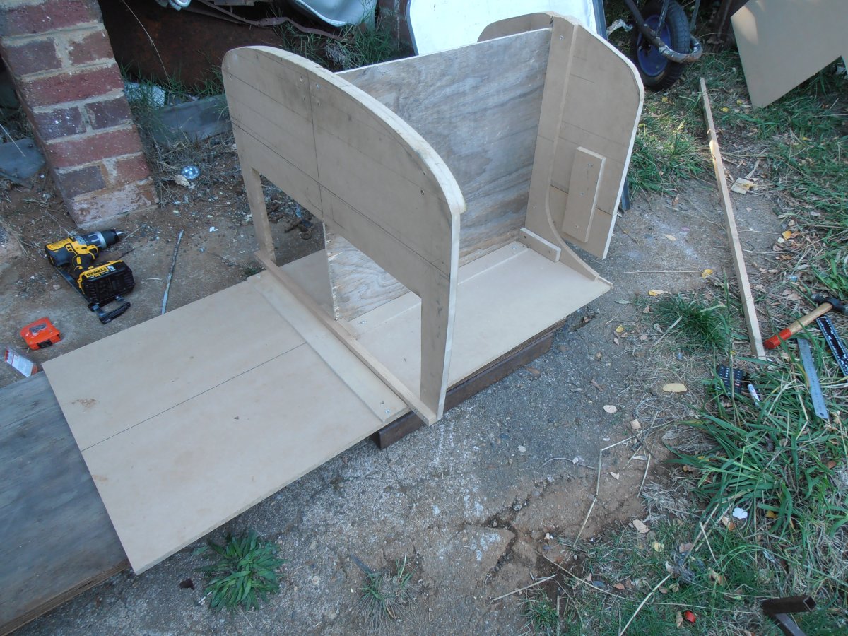

    chev34ute
    P1010141.JPG The idea is to replicate a 26 T Pickup out of Steel and aluminium by using the buck as a guide and the original panels as patterns. When I say replicate, I mean everything except the fenders, front cross member and windscreen posts, every thing else will be fabricated as I go. With such an ambitious project, I have not set a budget or time line, it will happen as it happens, money and time will govern its progress. There are a few things that will set it apart from other T pickup builds. For one thing it will sit on a longer Model A chassis, it will be fully fendered using 28,29 Model A fenders. The grill shell will be a hybrid of Model A and 32, and the firewall will be a hybrid of 26 T and 28,29 Model A. The hood will be a combination steel and aluminium four piece and the pickup bed will be custom built to 28 to 30 Model A pickup dimensions. the similarities end there how ever. There is another twist in this build, the cab will have a lift off aluminium hard top that turns it into a closed pickup.

    chev34ute
    Another view of the buck. Along with the body, bed, grill, hood and chassis, the sub rails will be fabricated as well and this buck will be extended to accommodated them. Slit in the middle is where the four peice hood will be test fitted when it is being formed. P1010146.JPG

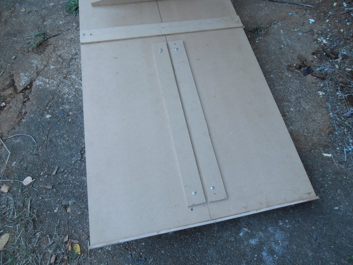

    chev34ute
    Here is another image of the MDF floor buck. this will be added to as the body is built. The slats that run along the middle allow the upper part of the buck to slot into place. The main reason I have not screwed and glued the whole thing together is because it would be to bulky to move around. the other reason is that its much easier to take apart in this form. I still have quite a bit of finishing to do on the firewall, to get it as narrow as the original. that hopefully will be done in the next few days. P1010147.JPG
