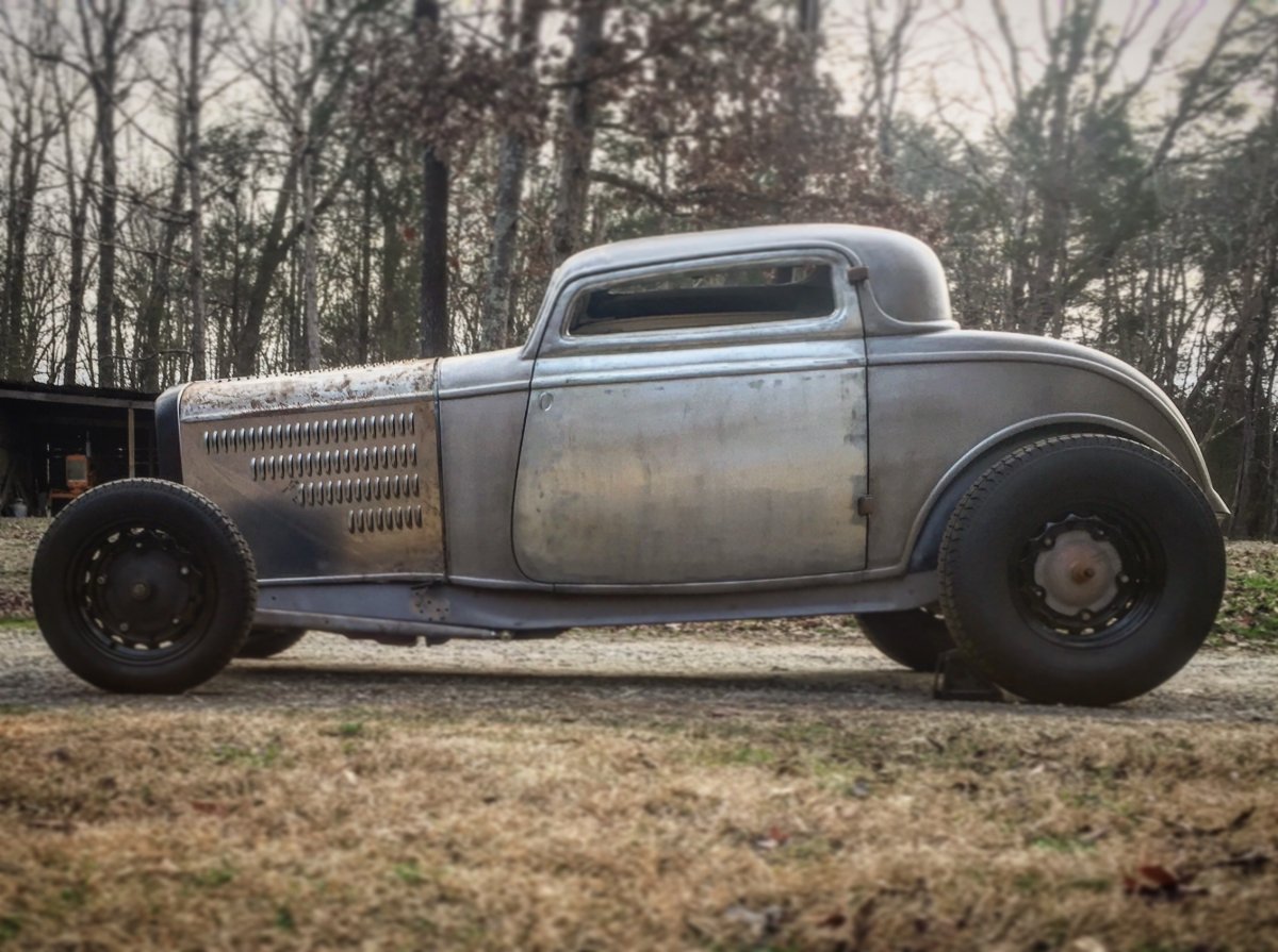

    The 32 looks amazing! The chop is spot on. Who and what did you have to do to the Buick drums for the wide five? I like that idea a lot.

    That's a hell of a surprise! Your car looks awesome, it sits just right with the rear tyres to the body lines.

    Aweeeee shiiiit! That's da bomb my man! Absolute perfection.

    Thanks Pete !!! Hahaha I'm pretty damn happy with how it came out .

    Incredibly badass!

    That last picture should be a poster.
