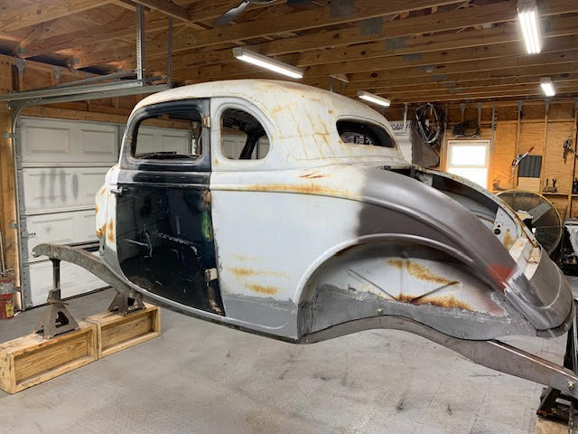

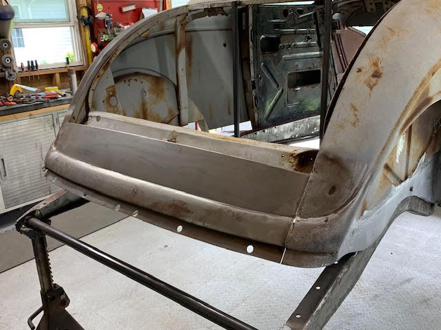

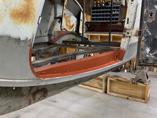

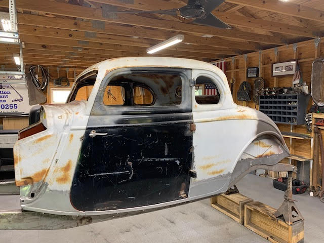

    Remove and rebuild the hinges, fit the door in the hole and see if there is a workable door gap or not.
    Not perfect, but good enough to not have to separate the cowl from the quarters to get a decent gap.
    The outer cowl skin is actually not too bad, but it has to go to give me room to fix all the nastiness in the cowl foot area.
    Matt at Iron Trap hooked me up with a pair or lower cowl patches.
    And, they fit. I tuned up the boogered up hood latch hole while I was at it.
    Here is the inner cowl structure. Now that it is solid, I can start making everything else fit from there. After I built all this crap, I found that some dudes make reproduction cowl feet. Might have to look at that next time...
    See ya, -Abone.

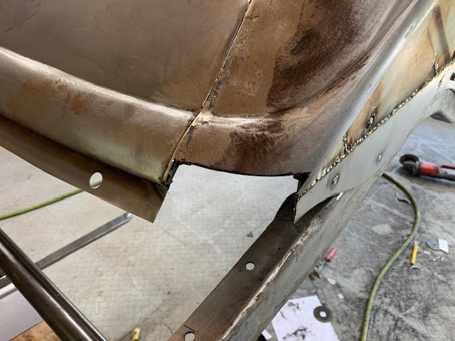

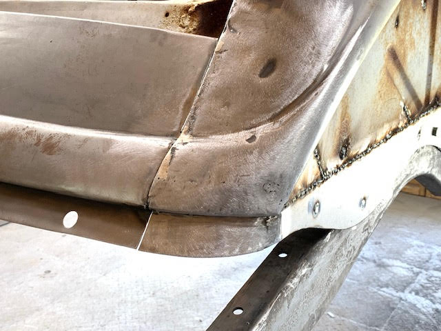

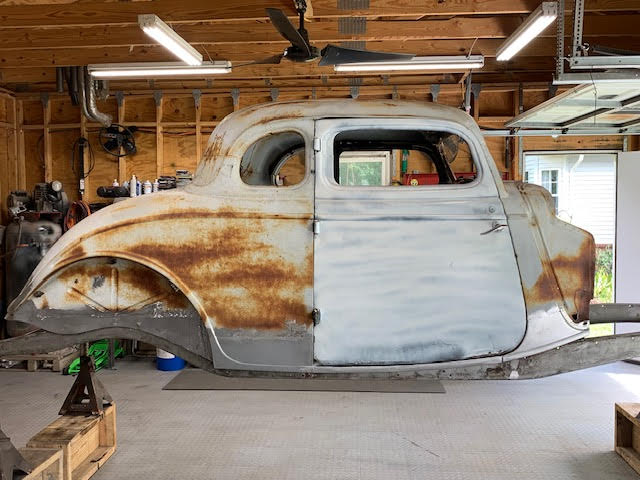

    Most cars I drag home are missing the bottom 8 inches all the way around, but this one actually had a floor, rockers and subrails.
    Unfortunately, it was all booger welded junk. Lots of layers of metal laid over each other and stick welded together. Lots of lead and porch screen. In the end, it all had to go.
    Now the front cowl feet are in position and the B pillar is located on the bones of the new rockers, this thing is actually structurally sound.
    The back end is hanging out in the breeze.
    This is definitely one of those gets worse before it gets better deals, but now she can start heading in the right direction.

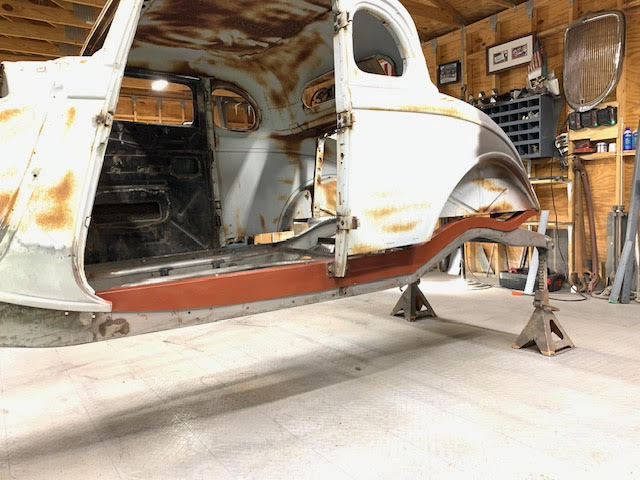

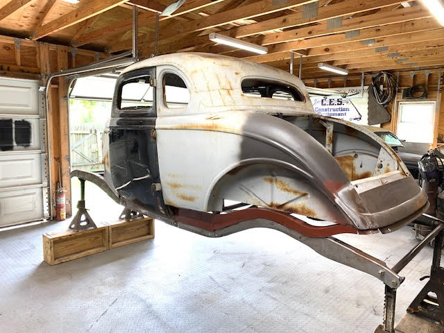

    So last we checked in, the little car was clinging to the frame at the cowl and B pillar only. To the rescue comes the FlamedAbone Close Enough To Stock For Me (tm) subrail kit.
    Now, there is something to attach the rockers and bottom quarter to.
    Cowl, rocker, quarter and wheel well bottom finally attached.
    Other side.
    Now to the rear tail pan corners. After I melted all the lead out of them, they weren't too bad.
    Passengers side needed a little love.
    Made a little panel.
    The tail panel in the hole. Probably not for the last time, but at least that sucker is in there.
    And, there you are. The little body is now structurally sound and I can move on to the cool stuff like figuring out where the front suspension and engine are gonna go.
    Tune in next time. -Abone.

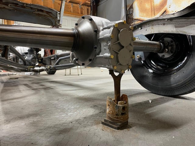

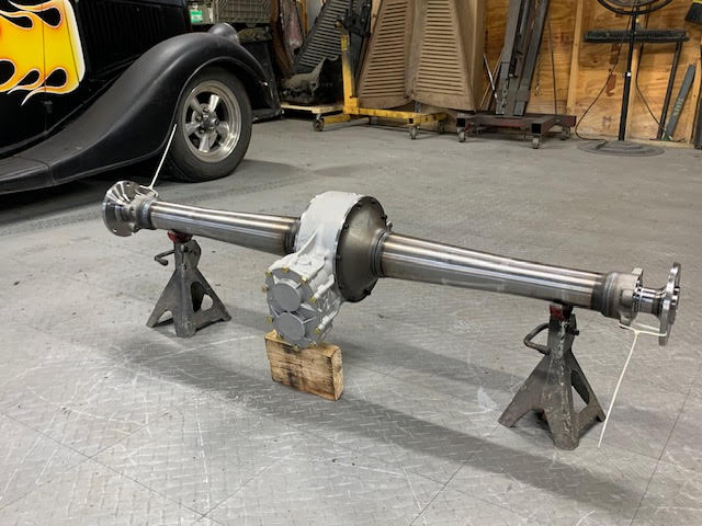

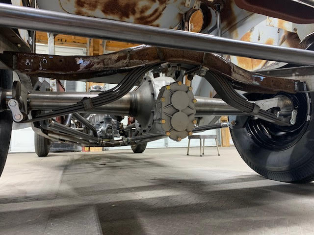

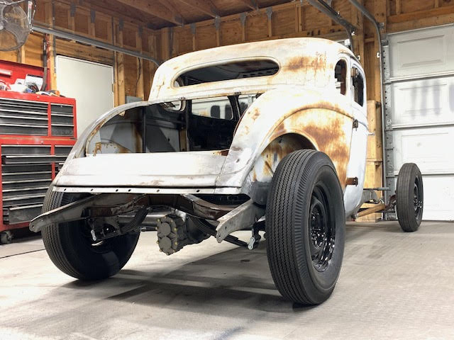

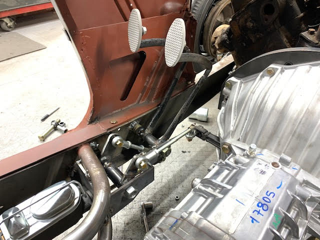

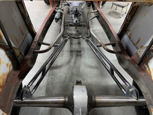

    The motor and trans are where they are going to live, so now I had to figure out the clutch linkage. The throw out arm has to move in the opposite direction of the pedals, which made it a bit of a pain in the ass, but Rube Goldberg was able to give me a hand.
    I usually build my own quick changes, but I don't have any small quickie stuff laying around, so I Gold Chained a complete rear from Winters. Super good folks to deal with and they gave me a screaming HAMB discount.

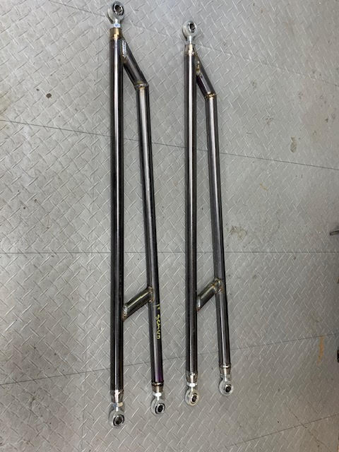

    The most caveman set of ladder bars you will ever see.
    Always remember to use your Traditional Pinion Angle Fixture when setting up your chassis.

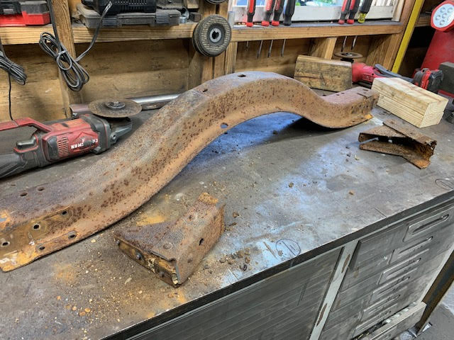

    Rear end is in there.
    Pretty sure this is a Model A crossmember.
    Had to flatten it out a bit, but she didn't mind.
    Finally a roller.
    See you next time.
    -Abone.
