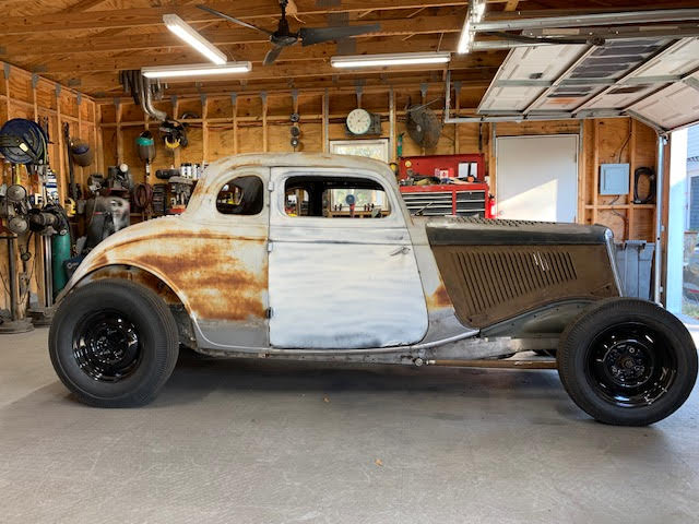

    He's not done yet...a turn of the key can change the mood dramatically and maybe the stance will be tweaked...can't recall if this was going to be one color or not either...tinted windows...hmmm...it's going to be a cool build to watch this year...it never gets boring here that's for sure...
    I looked...'almost no body or paint work'

    Yes I get that things have a way of deviating here and there...canvas like these are many times fluid and I many times say that canvas is in the vision within the fabricators head...

    If you take it out anywhere, take it out of the front. The lines of the car slope down toward the front, but the top of the roof runs at a flatter angle.

  9. I'd just get the front of the roof down where it looks good. Overall, the height is good.
    alanp561 and Stogy like this.
  10. Yeah, I vote for a clean-and-tidy-up job, but want to ask this: Have you climbed in (and made vroom-vroom noises, of course) and out to see if you have to do a lot of head-tilt to fit? More chop might make that an uncomfortable exercise after a while. (I don't have chopped cars because my neck has been surgery-ized several times and I can't head-tilt like I used to when I wore a younger man's clothes...)
    Dick Stevens and Algoma56 like this.
  11. Chop 1 1/2 inches more. More importantly, make sure YOU are happy with it.

    I have a month in this chop deal. I never had the whole top off, but I did remove 3/8 from the passengers C pillar and almost 1/2 from the drivers A pillar. So I guess you can't call it a chop, but I did have the whole drivers A pillar sitting on the bench at one point...
    Here are some random roof repair shots in no real order.
    After all that, holy shit it is finally done. Looks pretty close to the same as it did, but everything is square and fits like it should.
    And now for some non-chop related stuff. Here is the Racer Style Manual Window Kit (tm)
    Tail lights and plate.
    Head lights and shock mounts
    Man, that was a lot of crap. See you next time.
    -Abone.

    Great progress lately. You repaired all the previous hackery on that chop, well done.
    A friend of mine who is our go-to model 40 body man showed me one of his tricks when chopping a car. He takes the roof off then chops the door to where it looks cool, then fits the roof to the door, brilliant!
