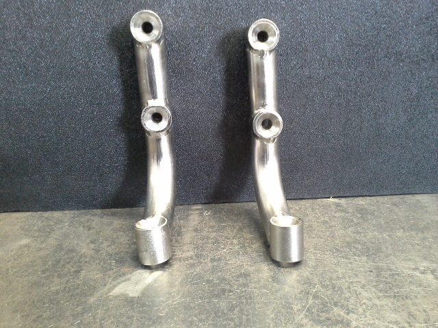

  22. DDDenny
    Posts: 19,319
    Dave
    Consider electroless nickel plating, may be more available than chrome platers considering their EPA issues. More money than rattle can but much cheaper than chrome.
    I think I posted this before, I brushed these with Scotchbrite before plating, they have a "soft" semi-chrome look, exactly what I was after.
