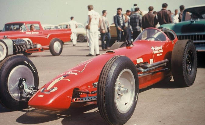

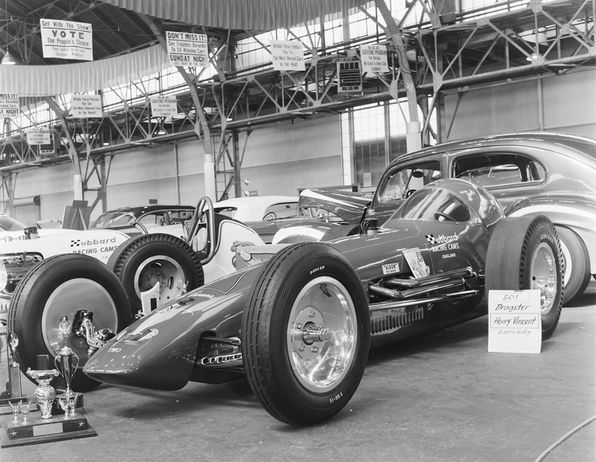

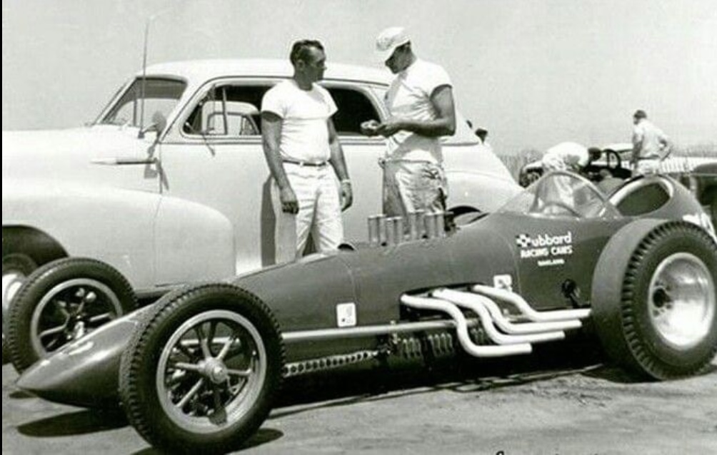

    I have been building this race car, on another of my threads for a couple months, but now it deserves it's own identity. The original Top Banana was built around 1957 in Hayward California. Hank Vincent was one of the owners, did the driving. The engine builder was George Santos, and it was kept at Hillary Govia's City Garage. The stylish body was done by one of the top metal men around, Jack Hagemann. Running Injected Nitro, it held many state records, ran over 175 in 1958. It was the sleekest of them all in it's time. I have been planning this build for at least 5 years, and one way or another it will run this year ! I am going to post a few pictures of the original then link to my other thread that shows the progress so far. And from now on the progress will be only shown on this thread. As the thread name notes, we are building it to resemble the original, but under the the @chriskopp aluminum body, will be a Certified, Legal to run at any track, chassis, limited to 1/4 mile at 7.50 seconds. https://www.jalopyjournal.com/forum...strip-b-sr-build-marty-strode.1177811/page-40

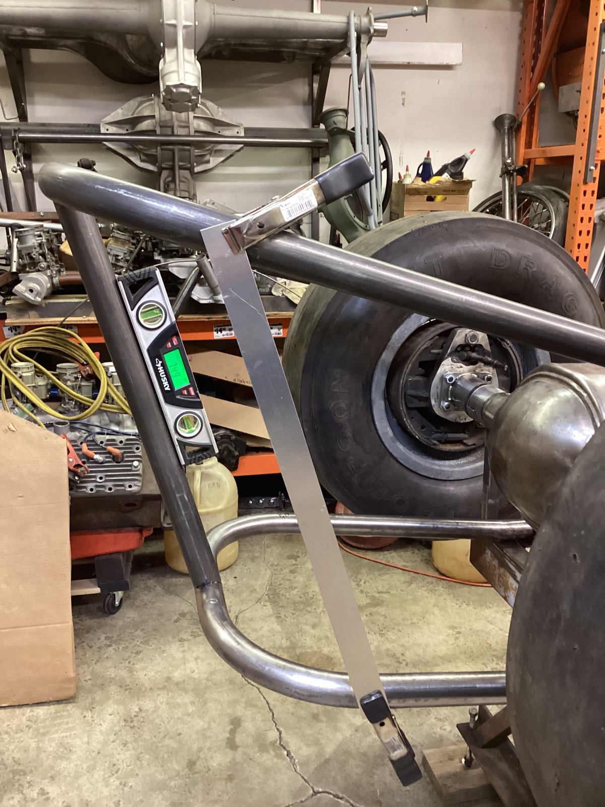

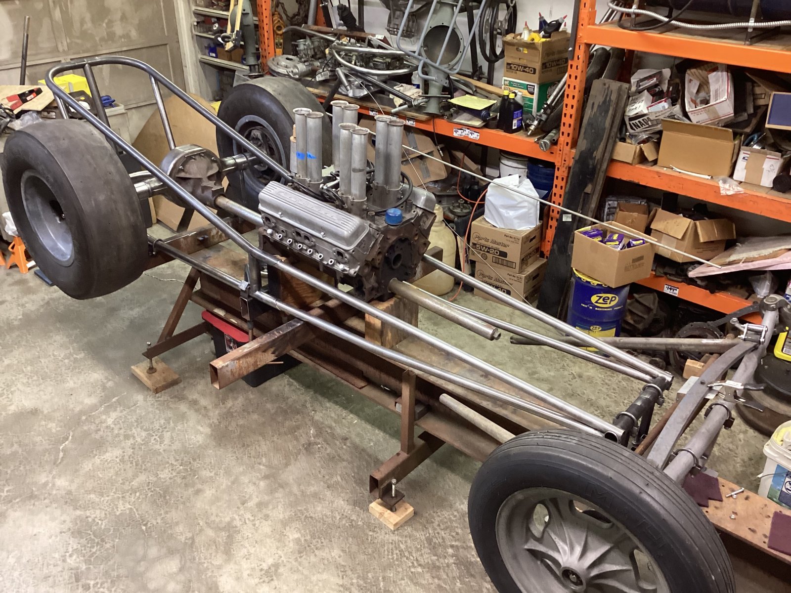

    Today, I got the front tubes trimmed off, and added the the 2 kidney bars in the the cage. When fitting and notching tube, I came up with a simple way to pick the desired placement, and angle. I shear a strip of sheet metal as wide as the diameter of the tubing I am fitting. Clamp it in place with the ends going past the joint, and simply mark the angles with a Sharpie. Cut off the excess metal and you have a perfect pattern, to lay in the tube notcher to set the angle for the hole saw. IMG_0180.jpg IMG_0182.jpg IMG_0183.jpg IMG_0184.jpg IMG_0185.jpg IMG_0186.jpg IMG_0187.jpg
